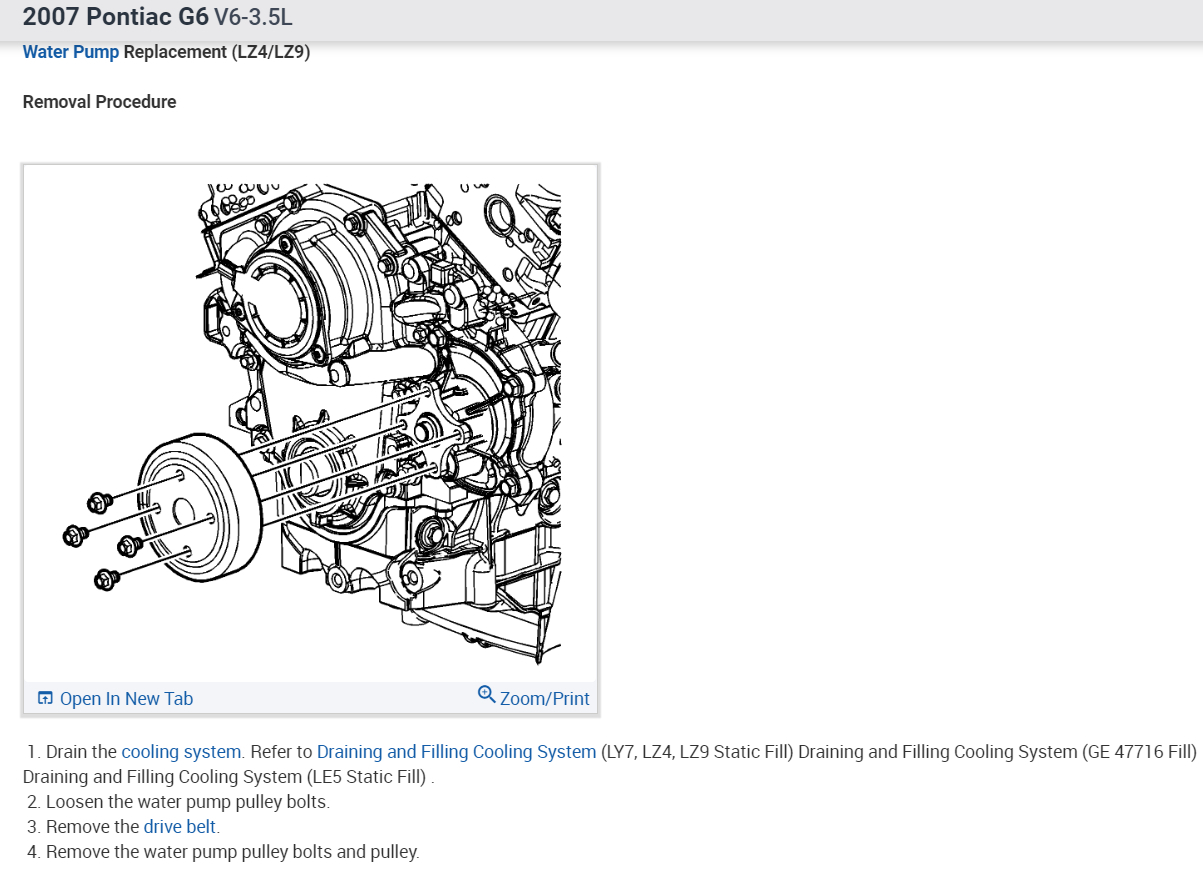

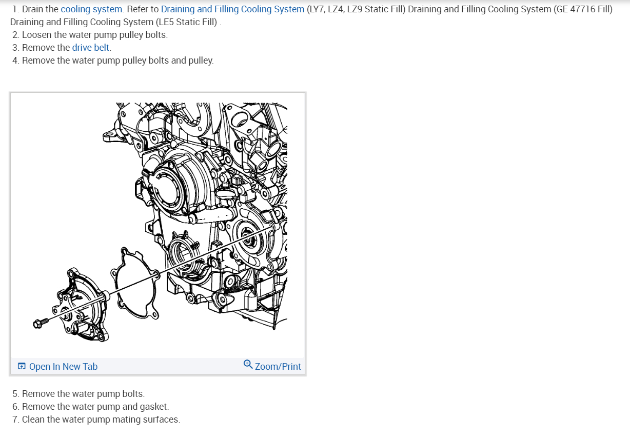

Did you use an AC Delco part? Also, if you have the wrong size serpentine belt (too small) and the tensioner is maxed out it will putting too much pressure on the pump. Here are the instructions for the pump in case we missed something. Check out the diagrams (below). Please let us know what you find.
