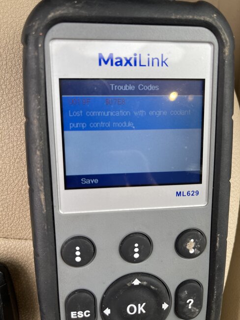

Sorry, I can't read the code, what is it?
Nov 6, 2024 at 10:07 AM
BHAMDOC1973
  • 2,008 POSTS
U019F
Nov 6, 2024 at 10:08 AM

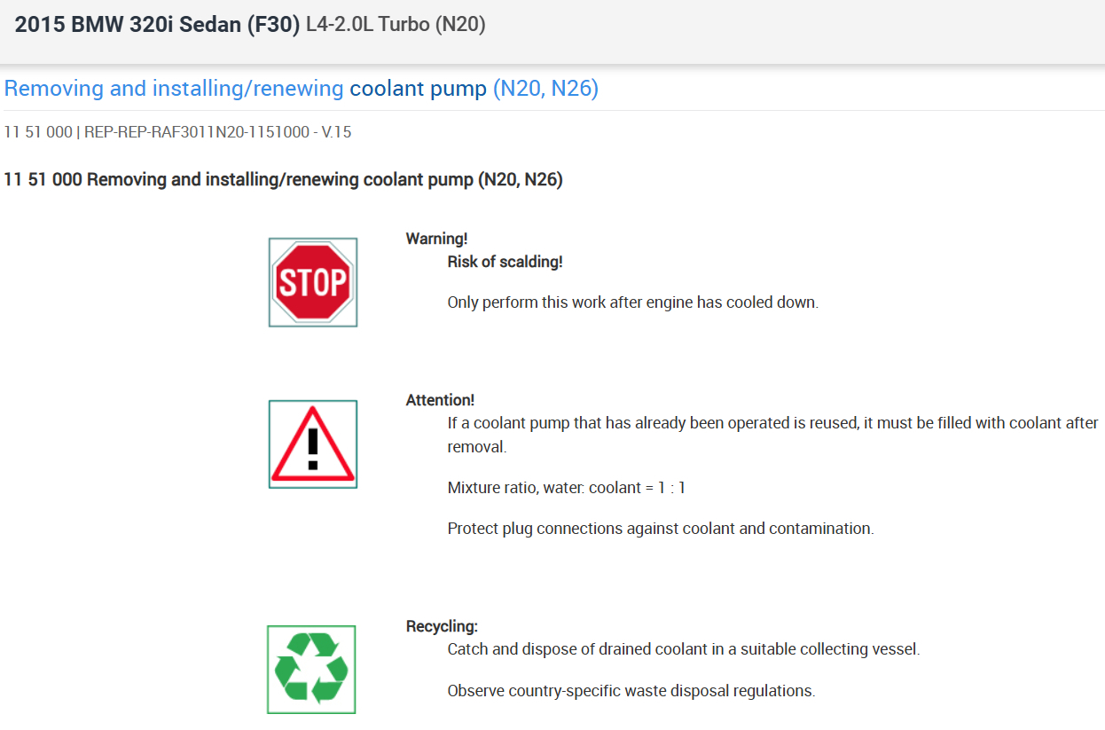

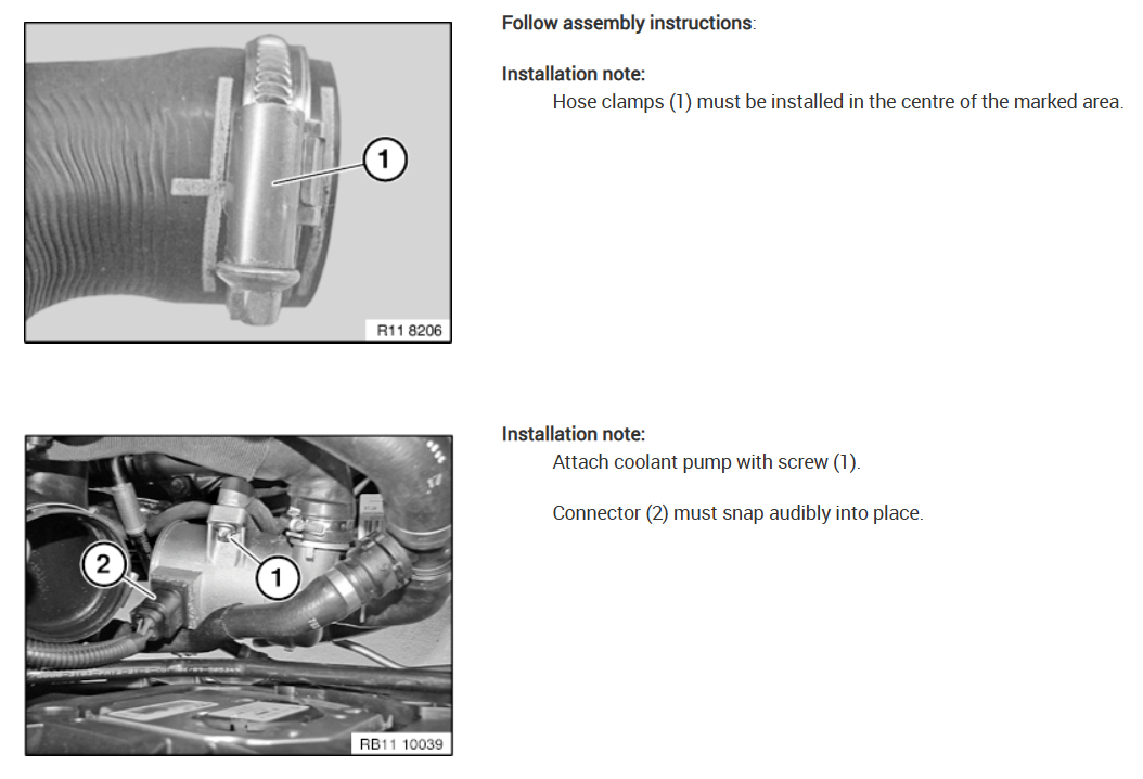

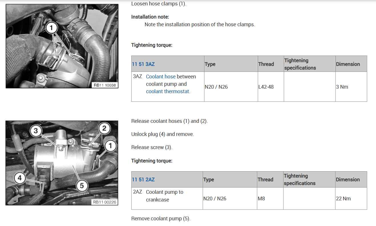

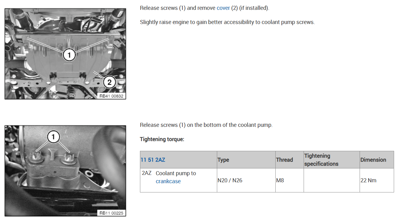

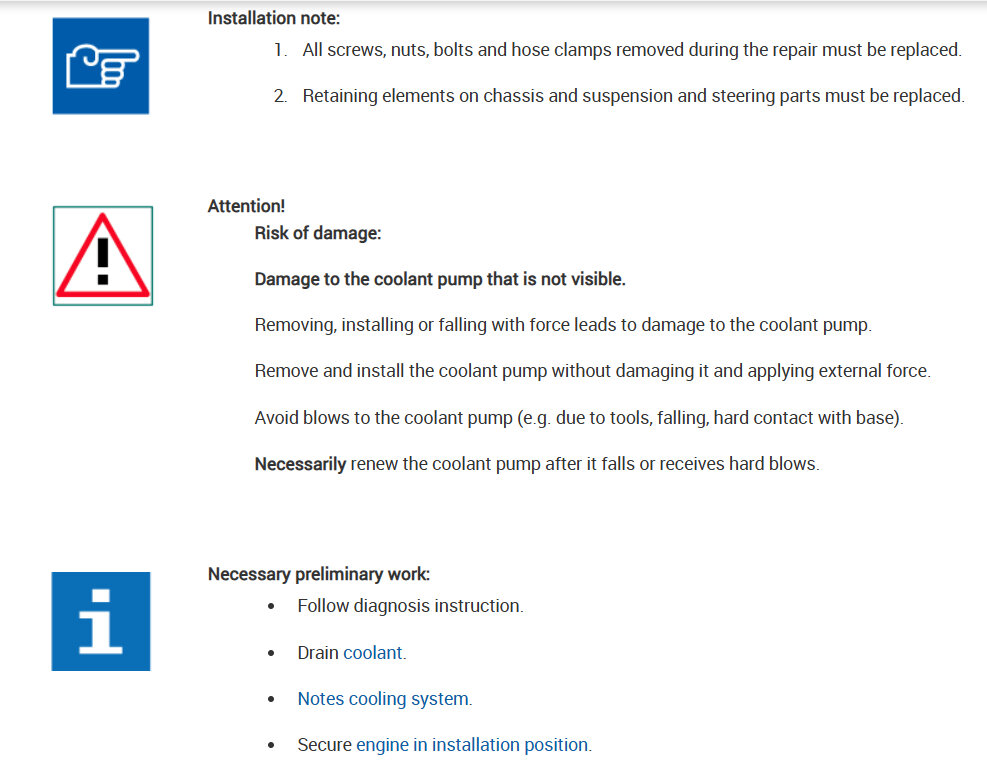

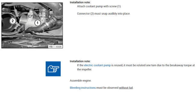

The diagnostic trouble code (DTC) U019F on your 2015 BMW 320 indicates a "Lost Communication with Electric Water Pump Module.
This happens when the water pump leaks internally and shorts out. Here is the location of the water pump and how to change it out. Check out the images (below). Let us know if you need anything else.
Nov 7, 2024 at 4:53 PM
