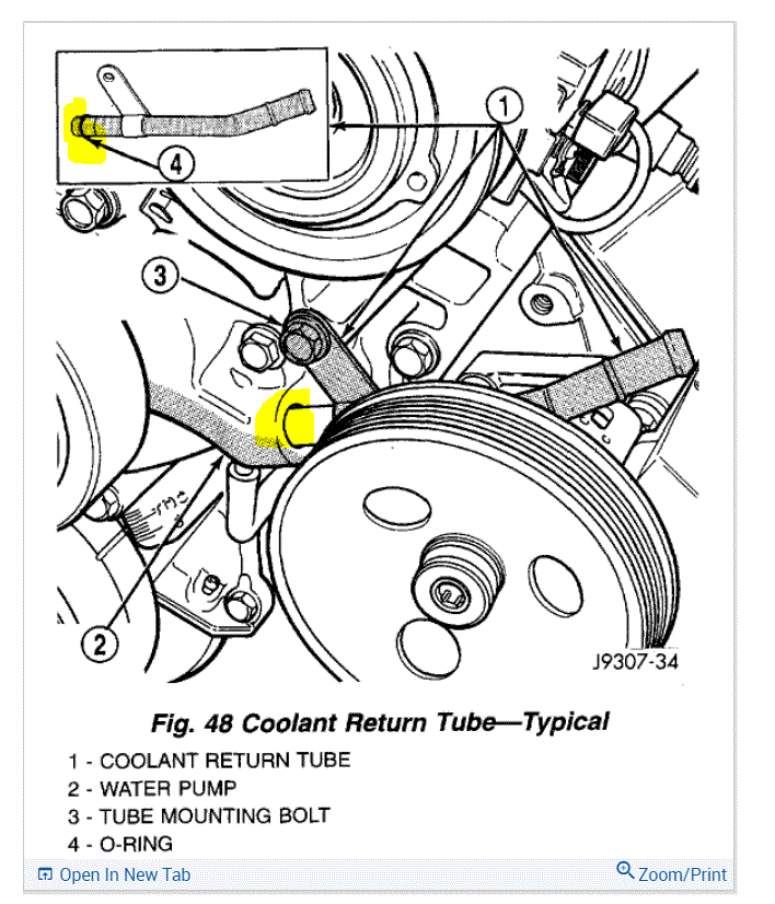

The idea that the system is under pressure really is why sealant won't work. The O-ring is a tight fit.
What I have seen happen is the new O-ring gets damaged (small nick) and will leak.
Here is what to try: Remove the tube from the water pump. Make sure everything is clean and in good condition. I oftentimes take a scuff pad and clean where it is inserted. Also, make sure where the O-ring is positioned is also clean.
Next, take Vaseline and coat the O-ring and where it inserts. Gently and carefully install the tube and once it is in, install the mounting bolt so it can't be removed.
Let me know if that helps.
See pic below.

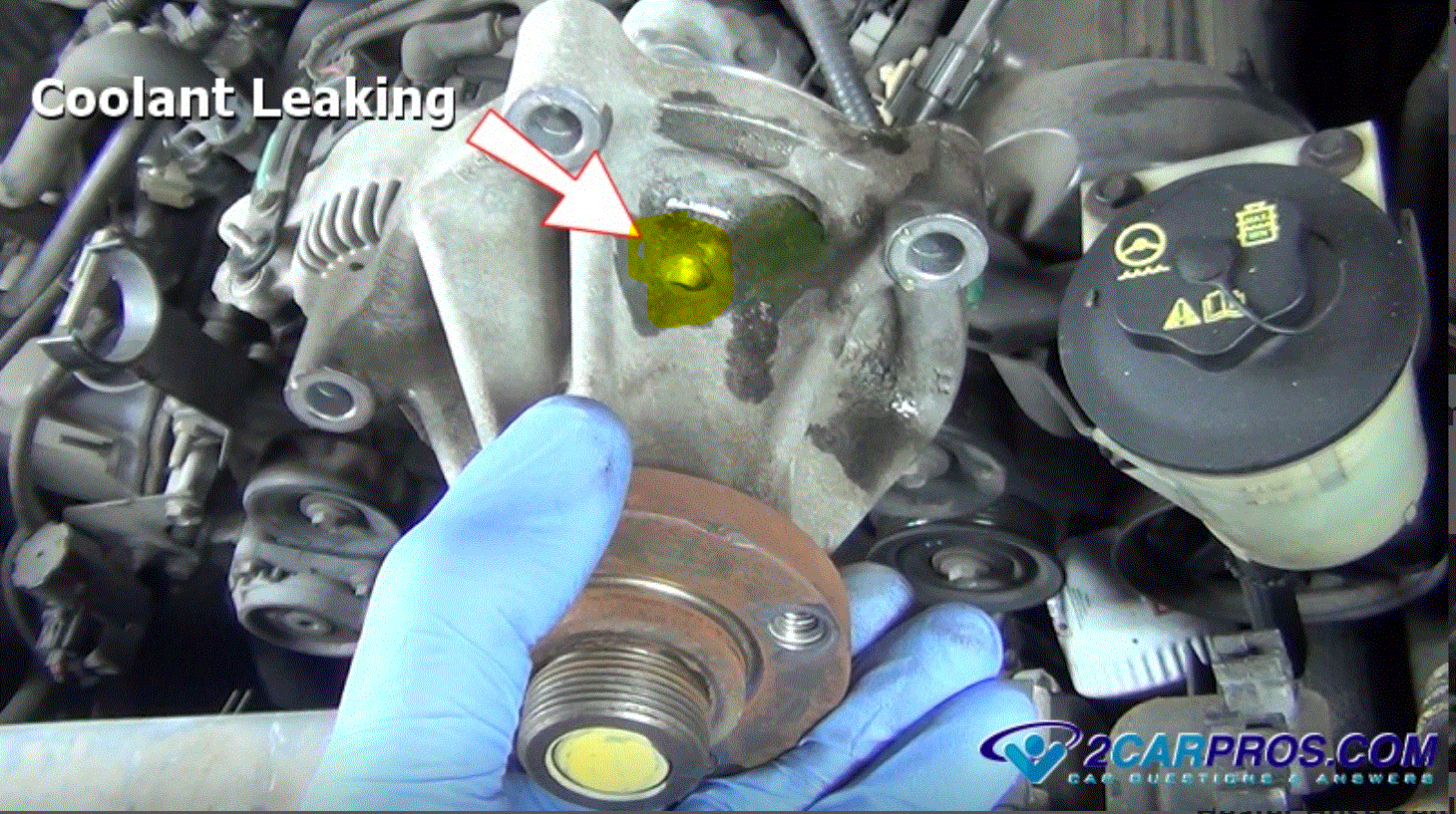

Also, is that the weep hole there on pic at red arrow?
May 11, 2022 at 9:00 PM
Let me know how it works for you. As far as the RTV, they make many different types for different heat ranges and materials. You should be able to find one made for automotive cooling systems that would be good.
As far as the time needed to cure, that is based on the type used. Some require little time while others require 24 hours. It should indicate the cure time on the product.
You mentioned the weep hole and a red arrow. I'm not sure what picture you are looking at.

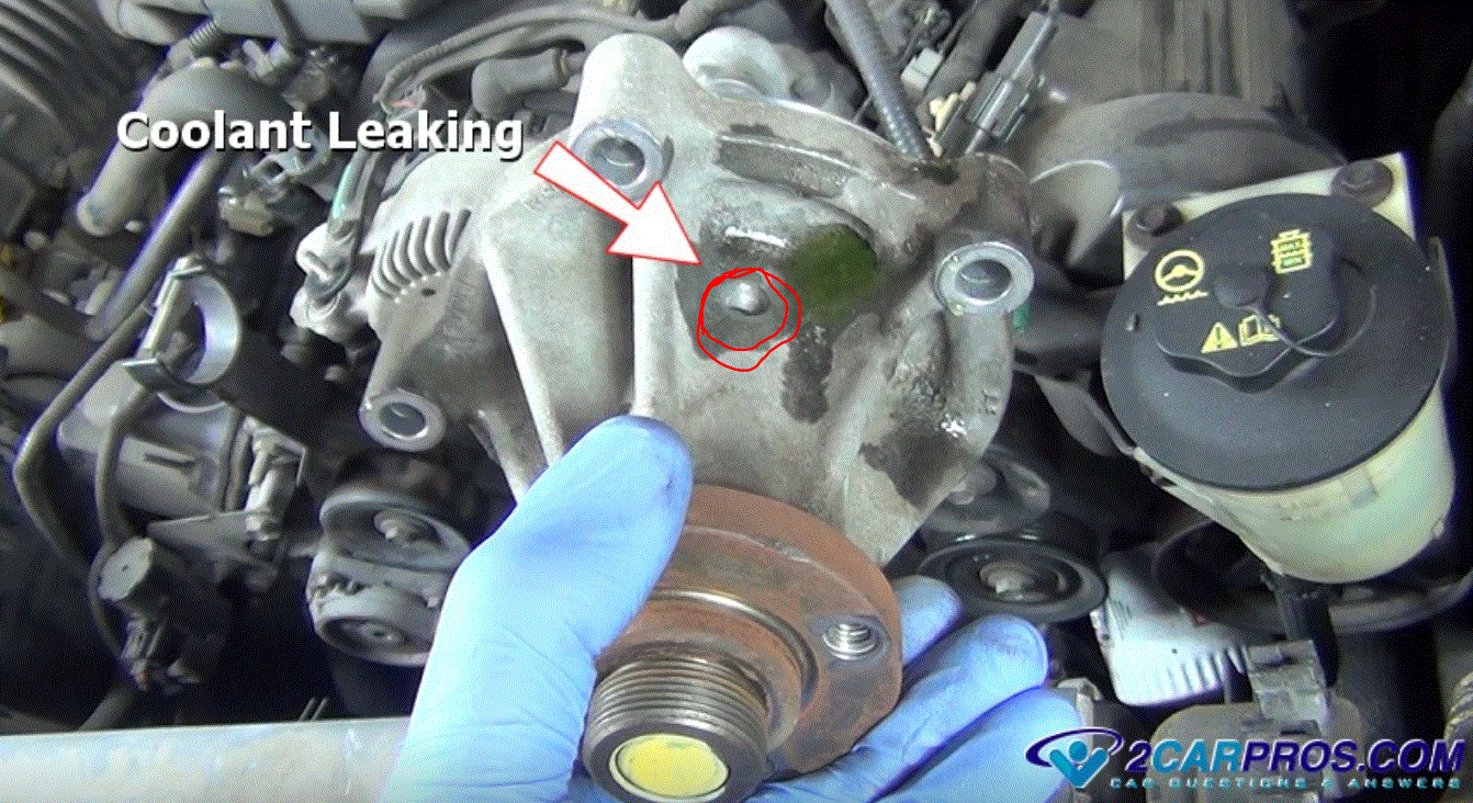

If you look through this link, you will see the weep hole on the water pump in the pic. I copied and circled it in the pic below.
https://www.2carpros.com/articles/symptoms-of-a-bad-water-pump
Note: The weep hole is positioned differently on different pumps.
See pic below.
May 12, 2022 at 7:09 PM

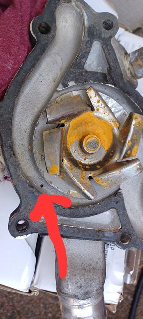

Here's pic. It didn't load..

Is that the weep hole at arrow on pic?
May 12, 2022 at 9:44 PM
The weep hole is on the exterior of the pump. As far as the flush, you should be okay.
I attached below a water pump and highlighted the weep hole. I believe the one on your vehicle will be hidden behind the pulley. Also, the arrow in your pic allows coolant to reach and lubricate the bearing.
Let me know if you have other questions and the outcome. I'm interested in knowing if the RTV does the job.
See pic below.

Okay, I was wondering where to keep an eye out via weep hold. So that pic is on a dodge 3.9?
