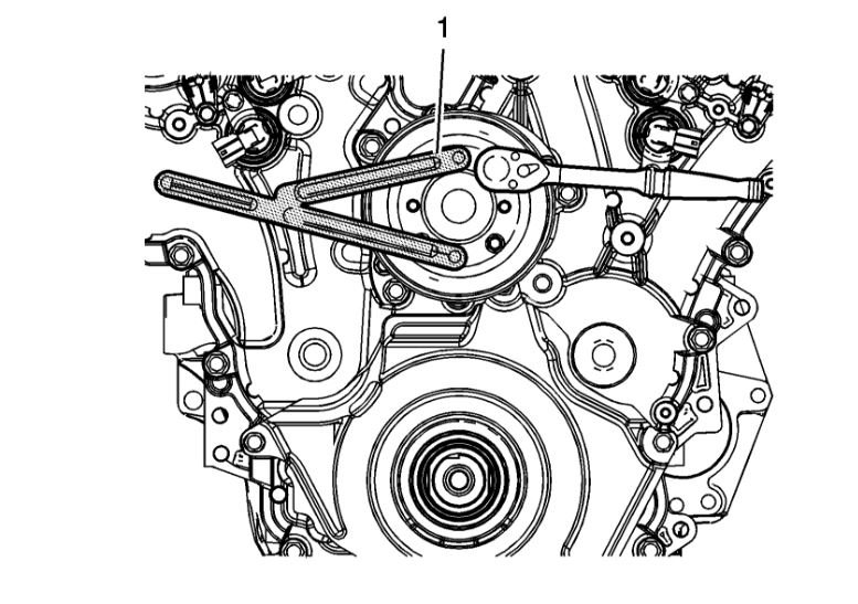

Water Pump Removal
Tools Required
EN 46104 Water Pump Pulley Holding Tool
imageZoom/Print
1. Install the EN 46104 onto the water pump pulley.

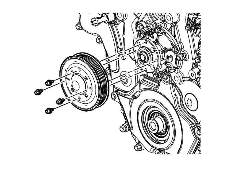

imageZoom/Print
2. Remove the water pump pulley bolts.
3. Remove the water pump pulley.
