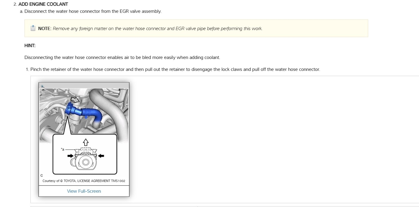

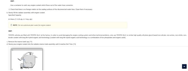

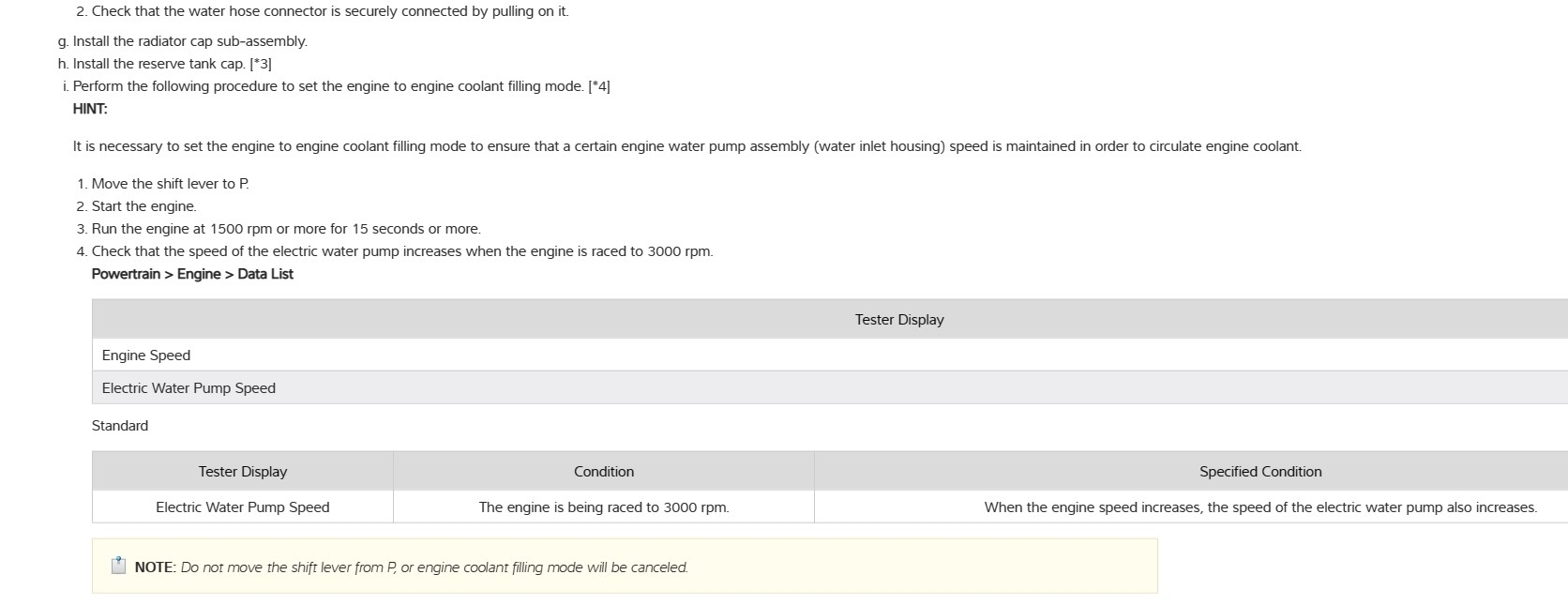

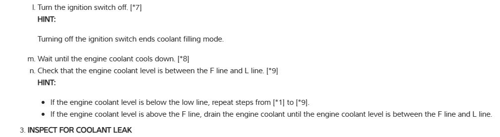

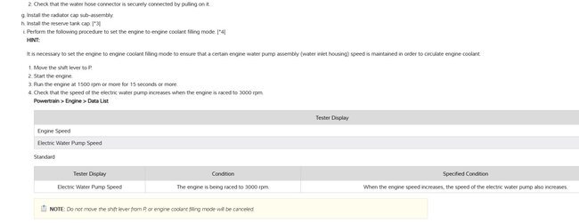

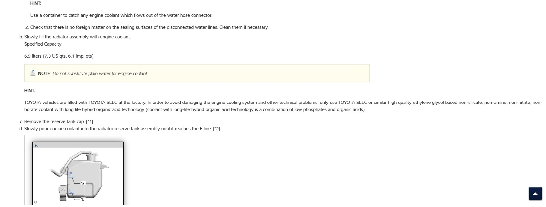

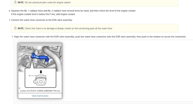

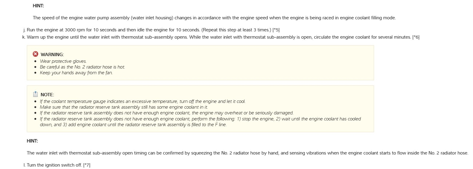

Good morning, MGULLEY,
It sounds like you might have air in your cooling system. Toyota has a certain procedure to bleed the air out of the coolant system.
I have added this procedure for you. Let me know if I can help in any other way.
Thank you,
Brendon
