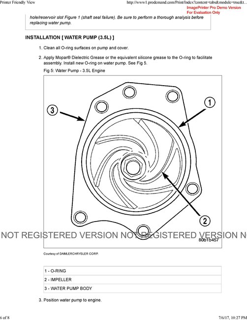

Where is the water pump located or can give a diagram of how to change water pump on my car listed above it has the 3.5 engine?
Jul 6, 2017 at 7:14 PM
HARRY P
  • 2,292 POSTS

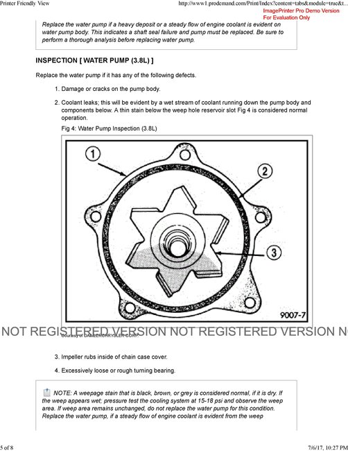

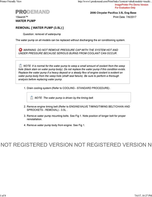

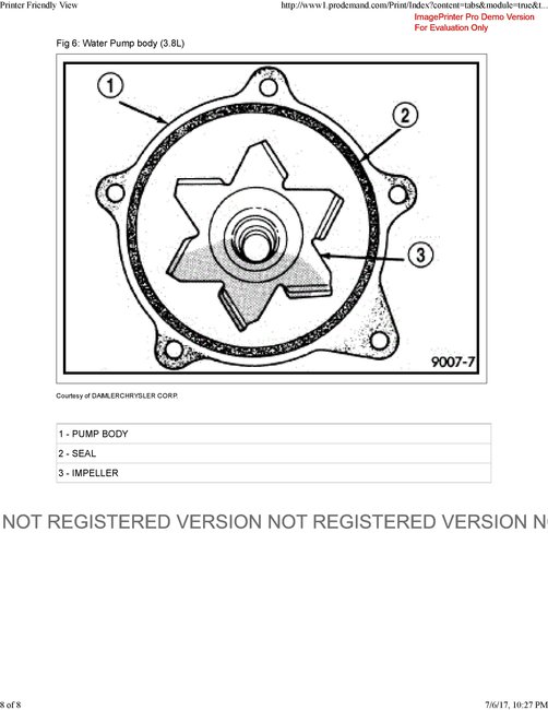

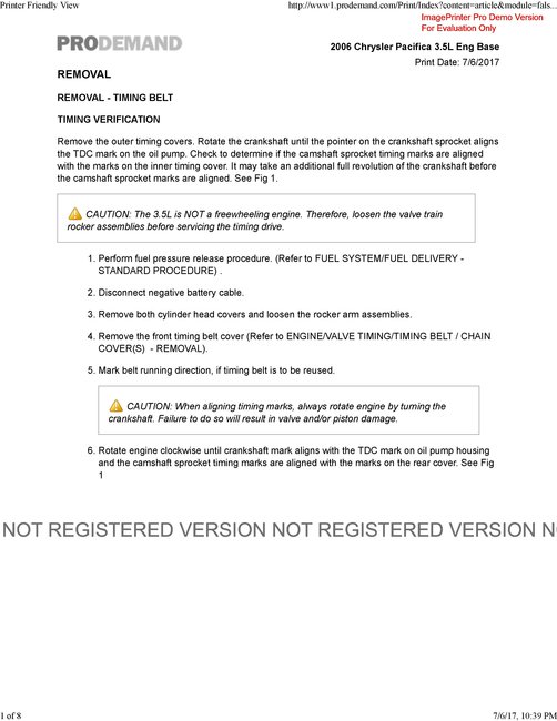

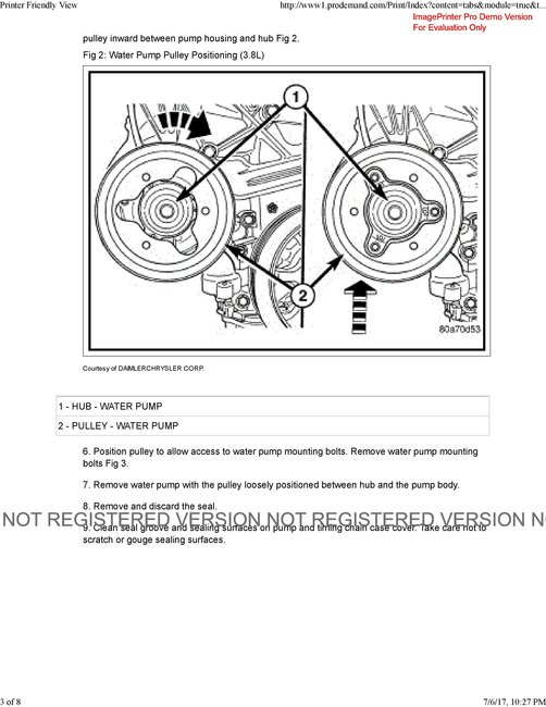

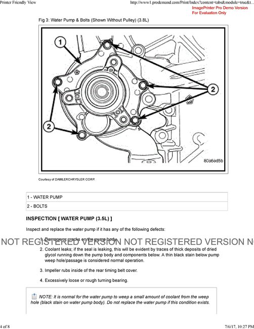

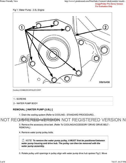

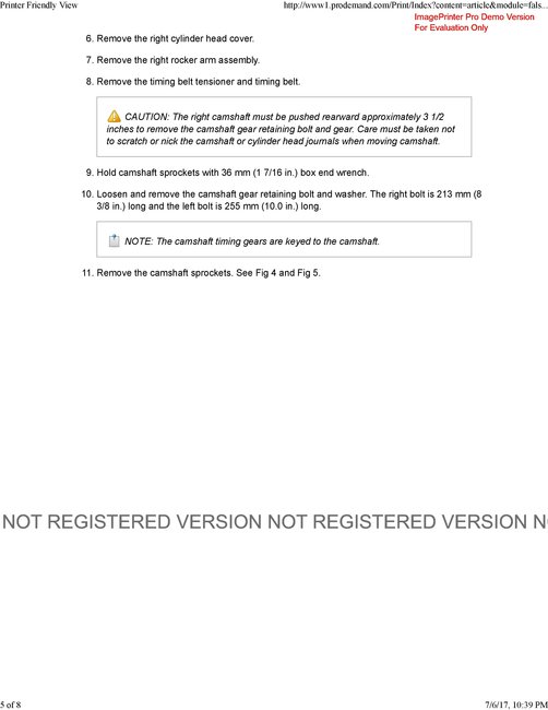

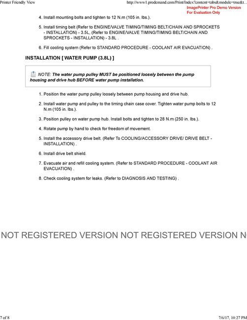

Unfortunately this car has an internal waterpump, which requires removing and replacing the timing belt. In all honesty, I would suggest having a professional do it. However, here are the instructions
Jul 6, 2017 at 7:31 PM
HARRY P
  • 2,292 POSTS

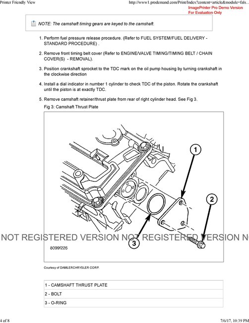

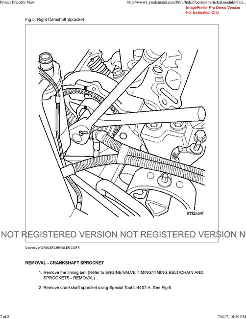

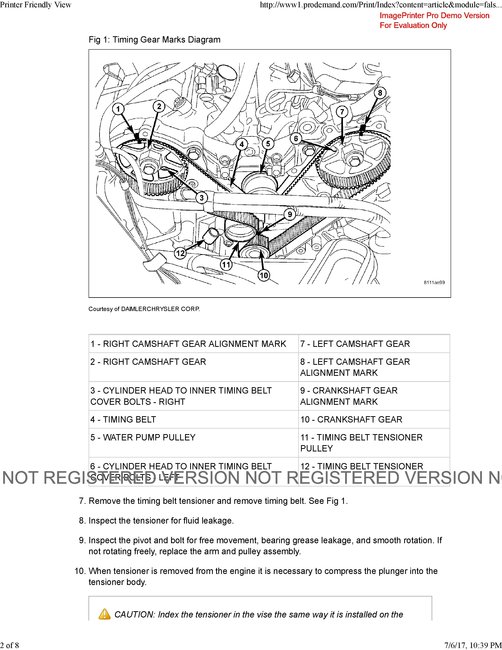

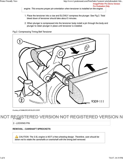

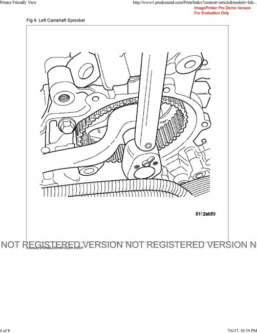

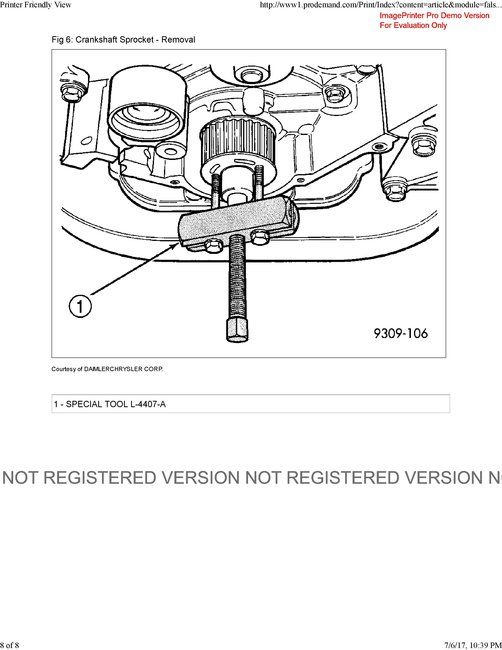

And here is how to do the timing belt. A mistake here could easily cost several hundred dollars and keep your car from running at all.
