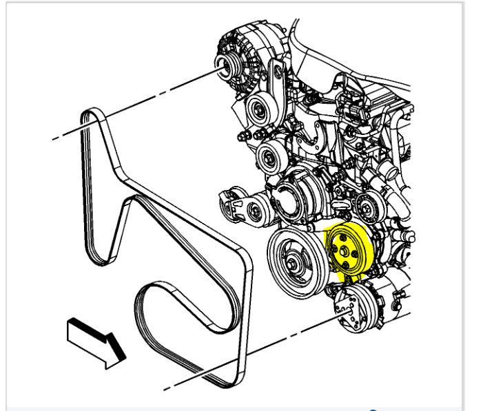

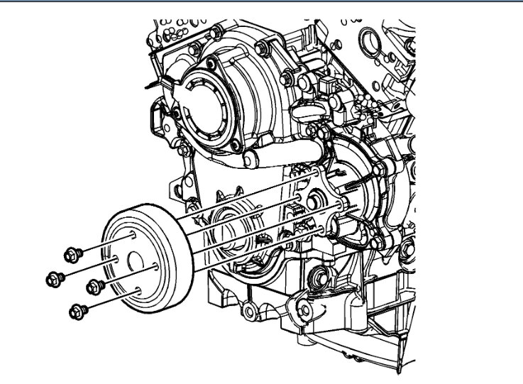

The pump is at the front of the engine. It is turned by the serpentine belt along with the other belt-driven accessories.
If you look below, I attached two pictures to help you locate it. Also, here is a link you may find helpful. It explains in general how to replace the water pump.

See pics below.
