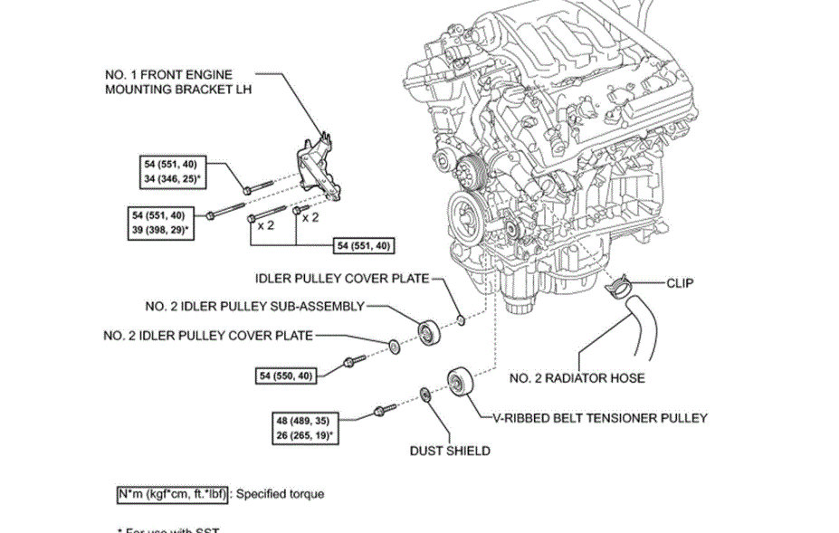

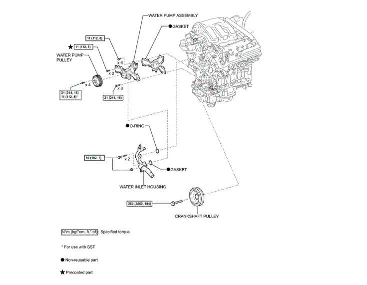

Mechanic while working on A/C suspects that water pump is moist from surface it is not leaking drops but wet from outside. so you think it is time to replace water pump now? how much would it cost?
