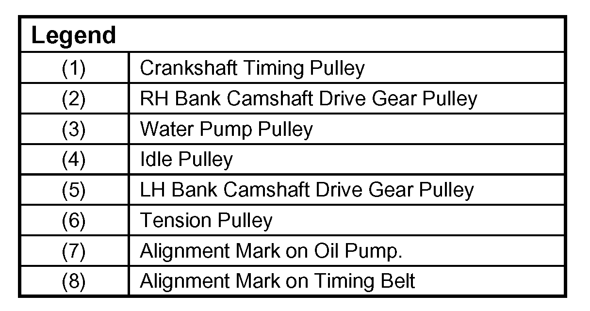

picture 1

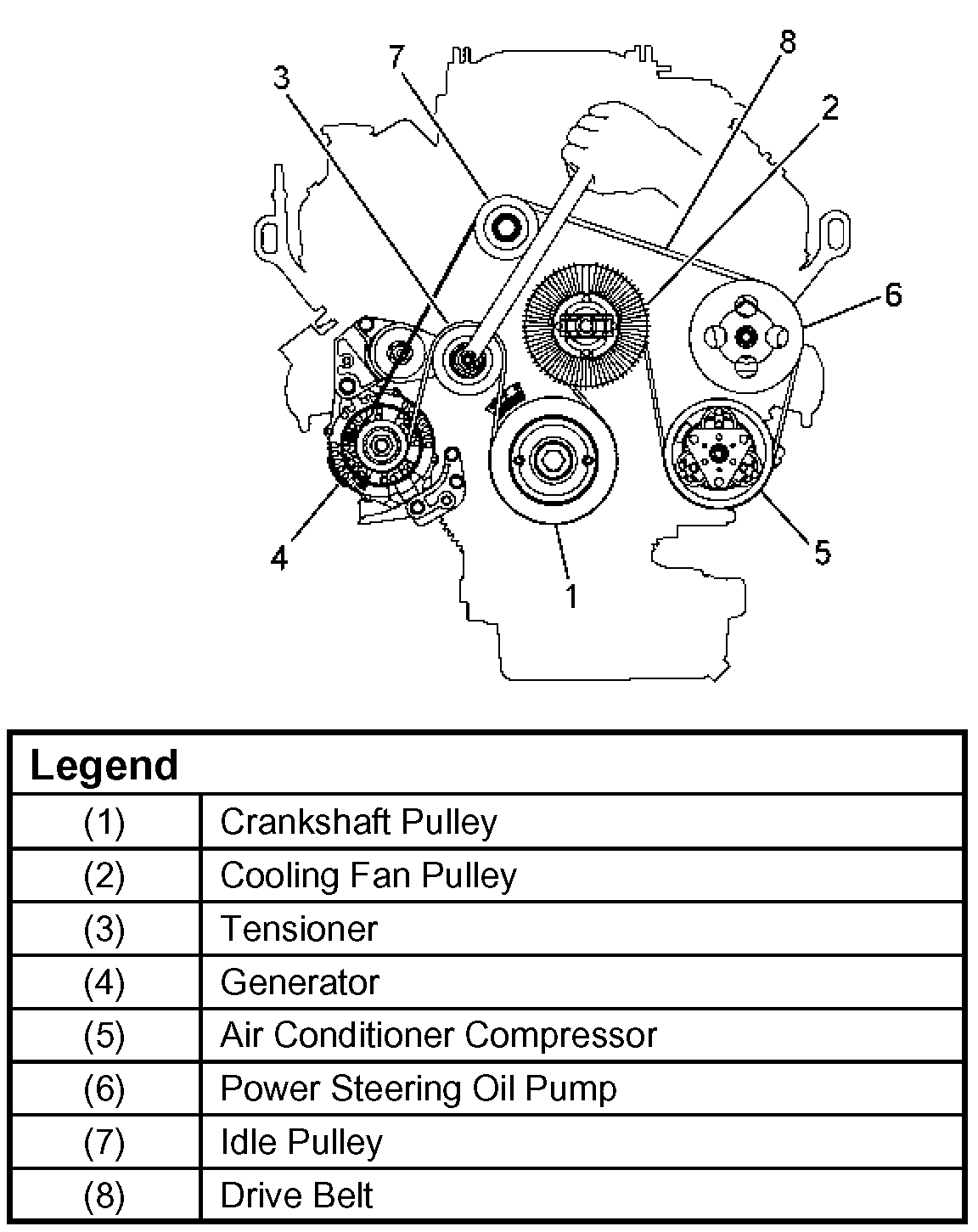

4. Move drive belt tensioner to loose side using wrench then remove drive belt.
5. Remove cooling fan assembly four nuts, then the cooling fan assembly.
6. Remove cooling fan drive pulley assembly.
7. Remove idle pulley assembly.
8. Remove serpentine belt tensioner assembly.
9. Remove crankshaft pulley assembly using J-8614-01 crankshaft holder, hold crankshaft pulley remove center bolt, then the pulley.
10. Disconnect harness connector of right side timing belt cover front side.

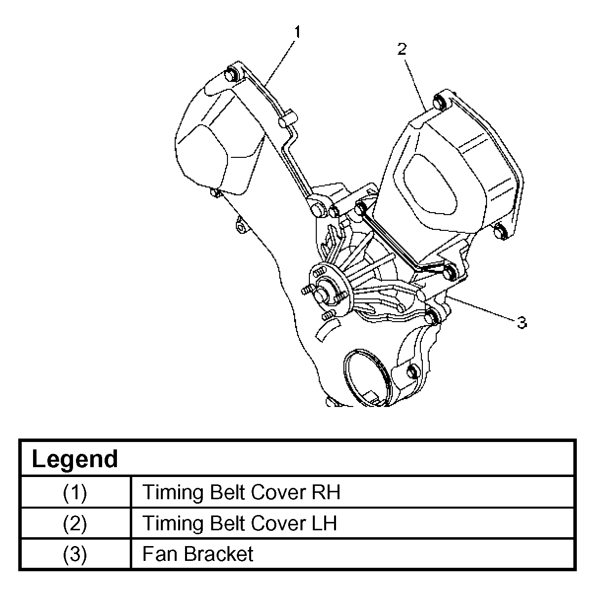

11. Remove right side timing belt cover and left side timing belt cover.
12. Remove fan bracket.

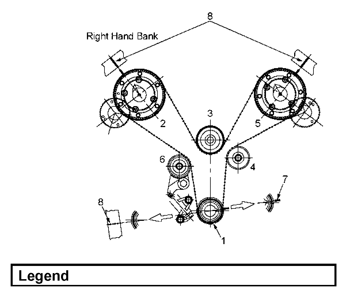

picture 2

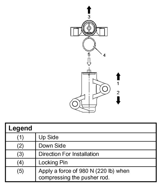

13. Remove pusher.
CAUTION: The pusher prevents air from entering the oil chamber. Its rod must always be facing upward.

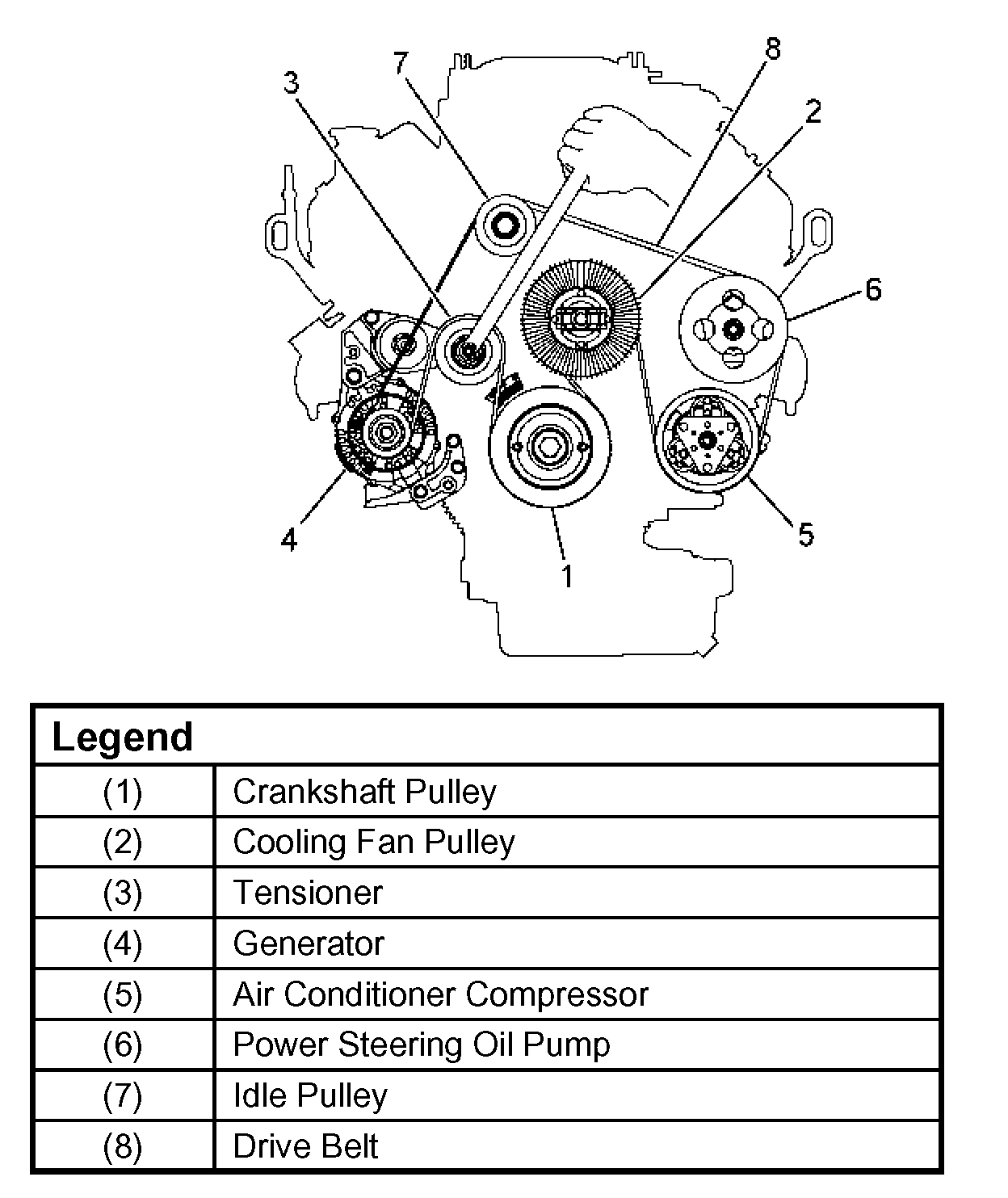

picture 3

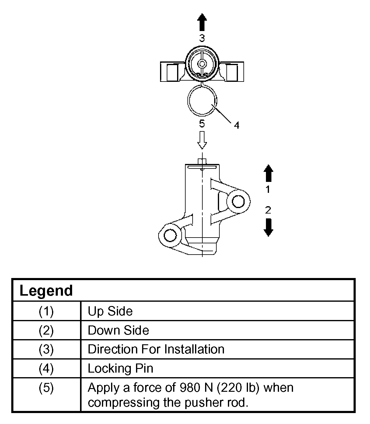

picture 4

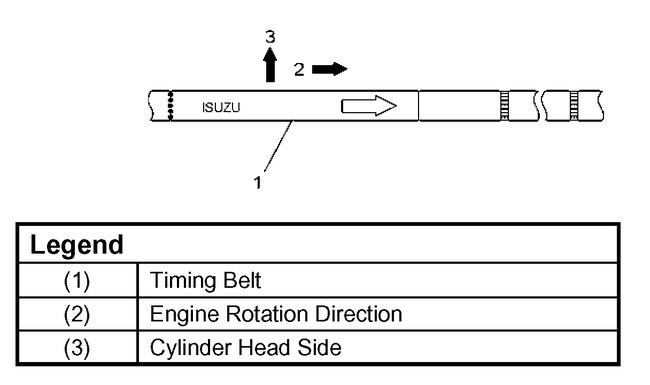

picture 5

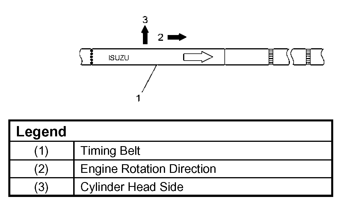

Note: For correct belt installation, the letter on the belt must be able to be read as viewed from the front of the vehicle.

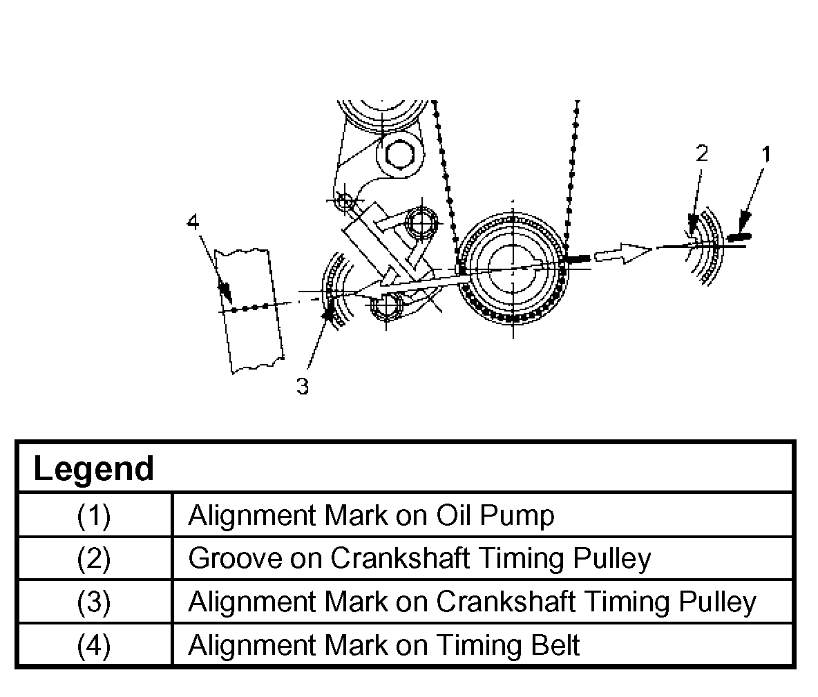

1. Install timing belt.

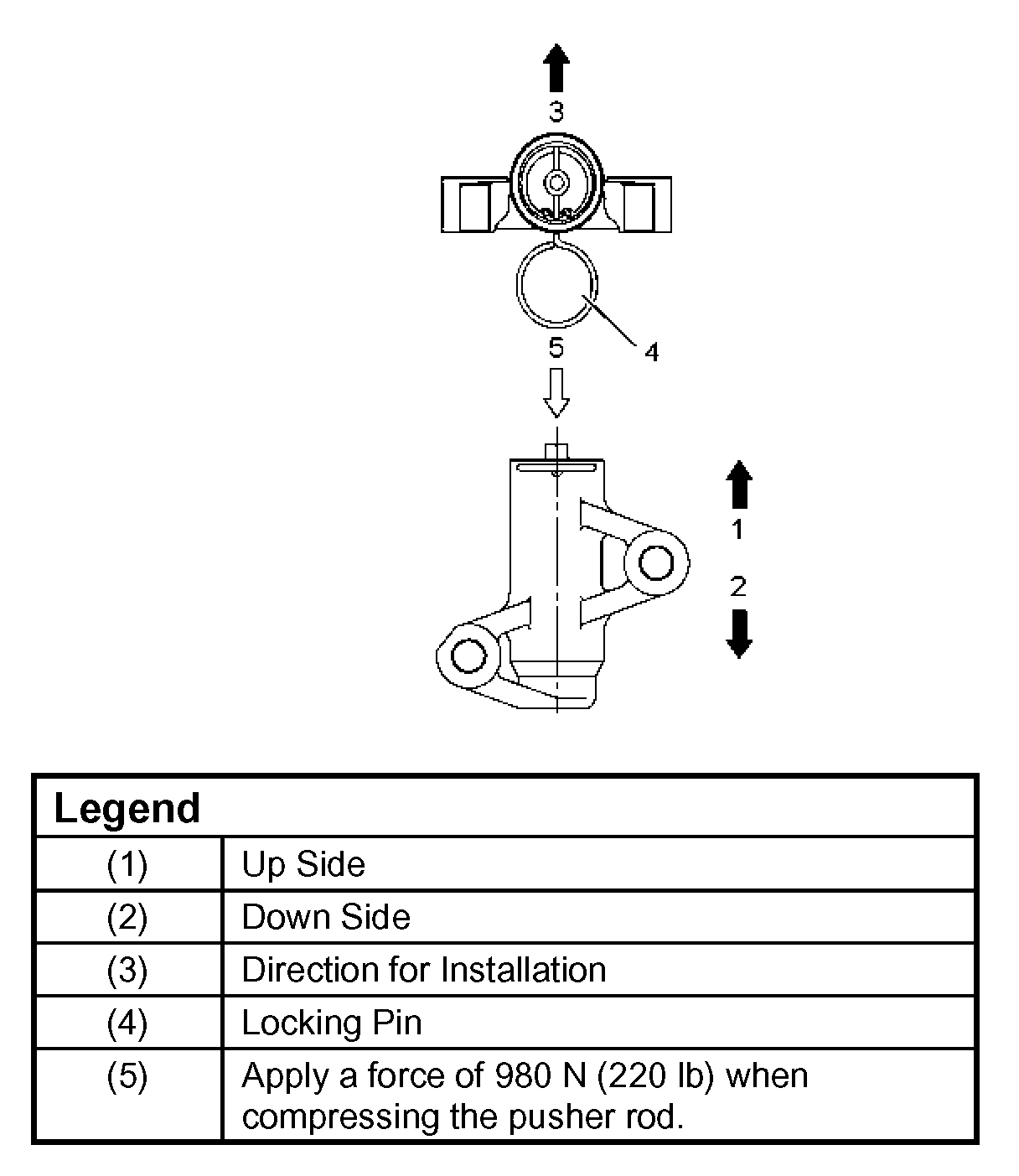

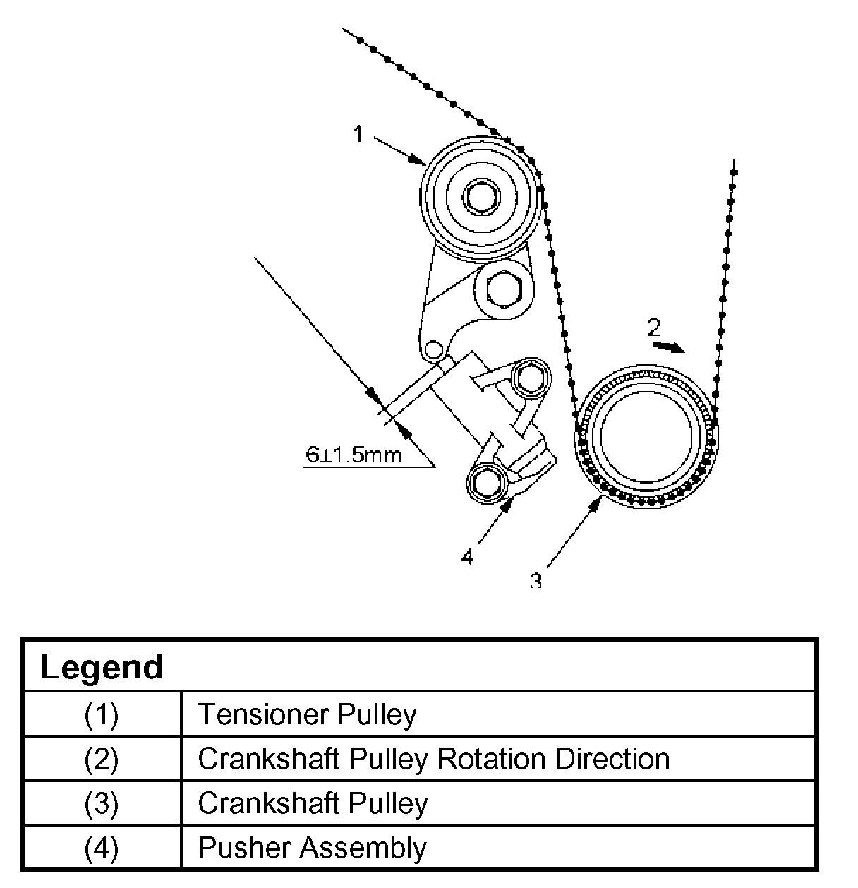

picture 6
1. Align groove of crankshaft timing pulley (2) with mark on oil pump (1).
Align the mark on the crankshaft timing pulley (3) with alignment mark (white dotted line) on the timing belt (4).
Secure the belt with a double clip or equivalent clip.
Note: When timing marks are aligned, No.2 piston will be on Top Dead Center.

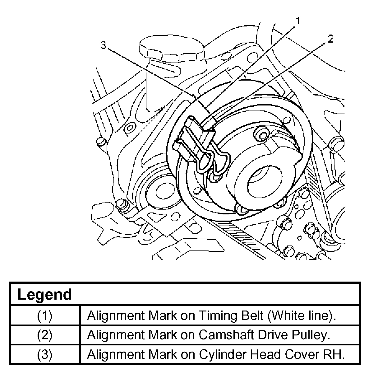

2. Align the alignment mark on the RH bank camshaft drive pulley (2) to the alignment mark of the cylinder head cover RH (3).
The camshaft pulley alignment mark should also align with alignment mark on the cylinder head cover.
picture 7

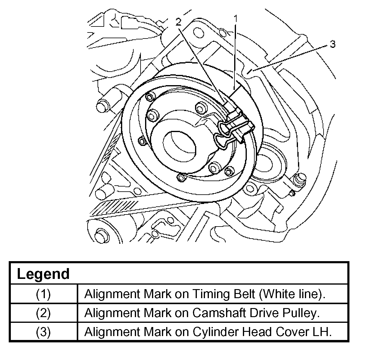

3. Align the alignment mark (white line) on the timing belt (1) with alignment mark on the RH bank camshaft drive pulley (2) (on the left side as viewed from the front of the vehicle) and put the timing belt on the camshaft drive pulley.

5. Align the alignment mark (white line) on the timing belt (1) with the alignment mark on the LH bank camshaft drive pulley (2).
When aligning the timing marks, use a wrench to turn the camshaft drive pulley, then set the timing mark between timing belt and camshaft drive pulley and put the timing belt on the camshaft drive pulley.

2. Install pusher and tighten bolt to the specified torque.
Torque: 25 Nm (18.4 ft. lbs.)
1. Install the pusher while pushing the tension pulley to the belt.
picture 9
2. Pull out pin from the pusher.
Note: When reusing the pusher, press the pusher with approximately 100 Kg to retract the rod, and insert a pin (1.4 mm (0.055 inch) piano wire).
picture 10
After release the push rod from the locking pin, the rod projection is approximate 6 mm (0.2362 inch).
3. Remove double clips or equivalent clips from timing belt pulleys.
Turn the crankshaft pulley by six turns and check for timing mark alignment.

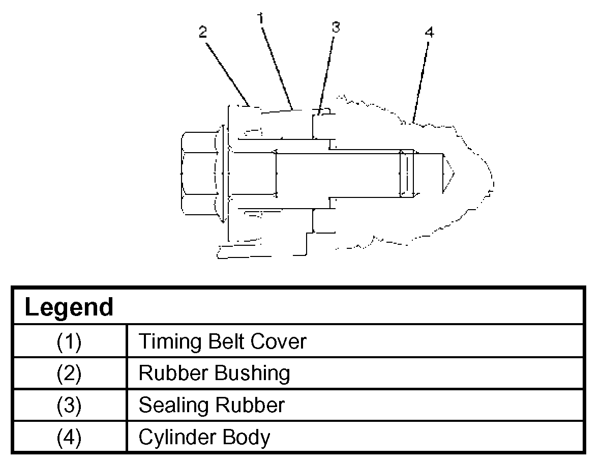

4. Install timing belt cover.
Remove crankshaft pulley that was installed in step 1 item 5.
Tighten bolts to the specified torque.
Torque: 19 Nm (14 ft. lbs.)

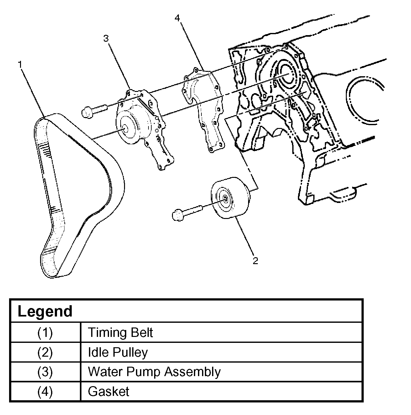

Now for the simple part. Replacing the water pump.
Water Pump
picture 15
Water Pump and Associated Parts
Removal
1. Disconnect battery ground cable.
2. Drain coolant.
3. Radiator hose (on inlet pipe side).
4. Remove timing belt.
5. Remove idle pulley.
6. Remove water pump assembly.
7. Remove gasket.

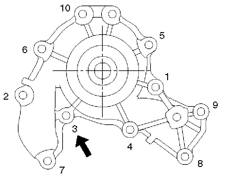

2. Install water pump assembly and tighten bolts to the specified torque.
^ Tightening order
The tightening order are in the illustrate.
Note: To prevent the oil leakage, apply the LOCTITE 262 or an equivalent, to the arrow marked fixing bolt thread.
3. Idle pulley
^ Install idle pulley and tighten bolt to the specified torque.
Torque: 52 Nm (38.4 ft. lbs.)
4. Timing belt
^ Install timing belt.
