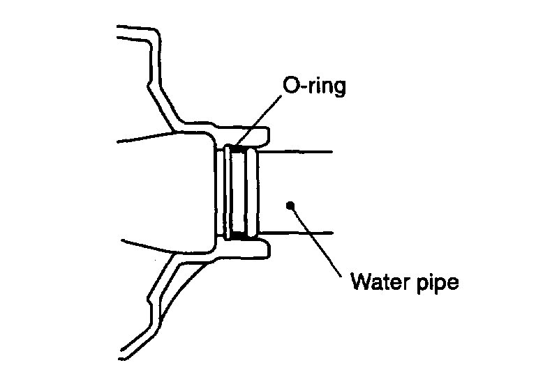

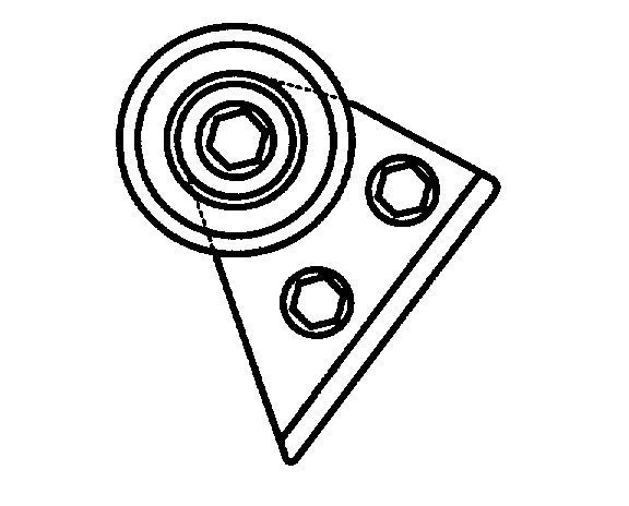

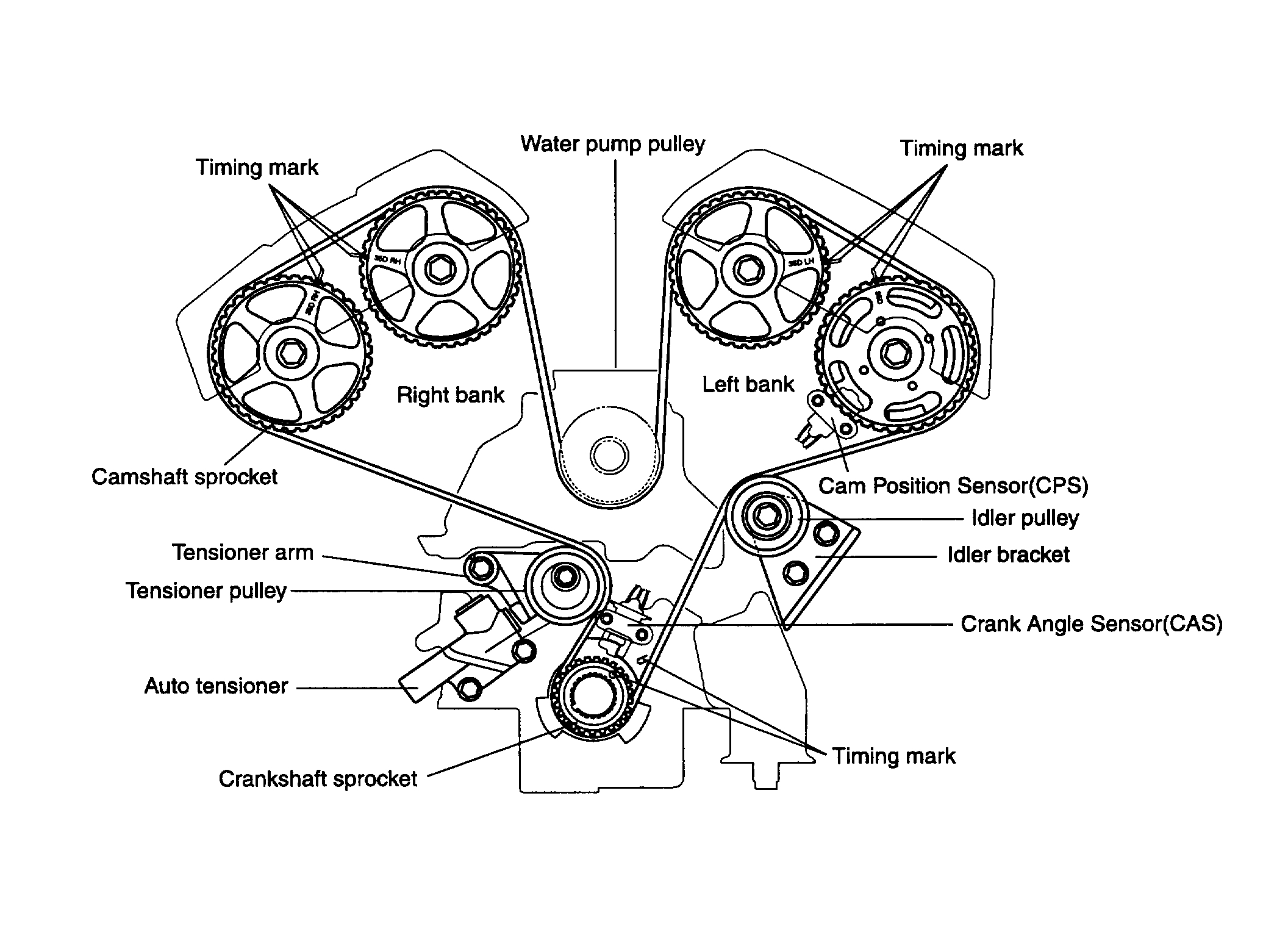

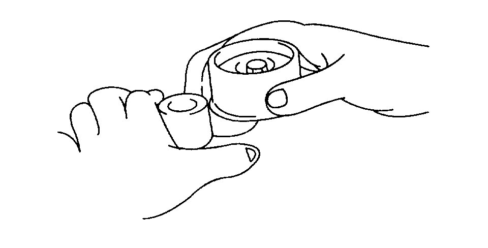

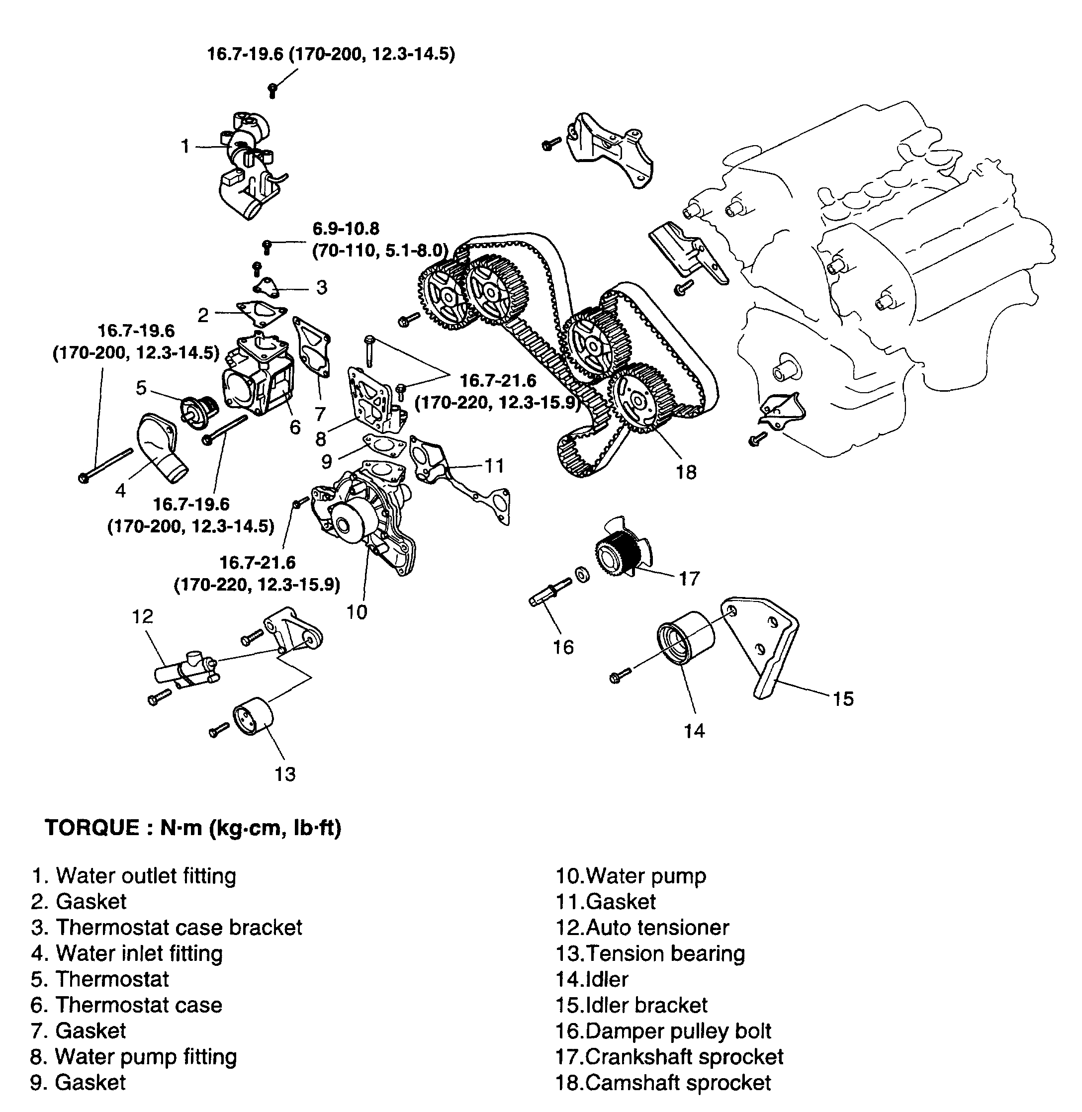

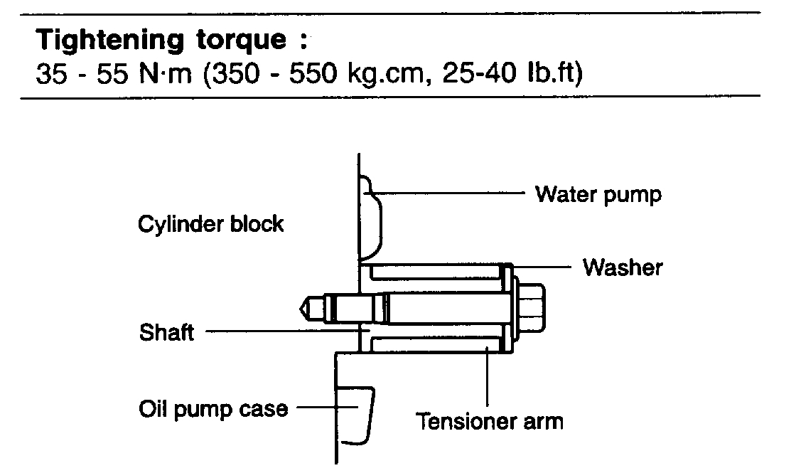

This isn't an easy one to do because the timing belt needs removed. However, I will provide the directions first for belt removal (which needs done first) and then directions for water pump replacement. All attached pictures correlate with the directions. Also, if the belt has never been replaced, this is a good time to do it.

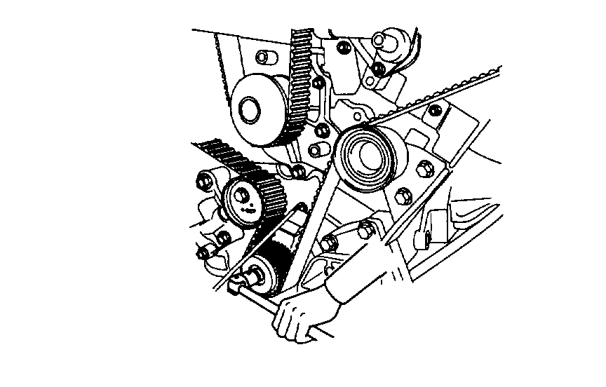

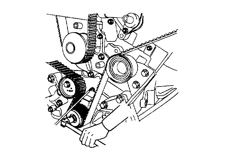

1. Using a [16 mm], rotate the tensioner arm clockwise (about 14°) and remove the belt from the pulley.

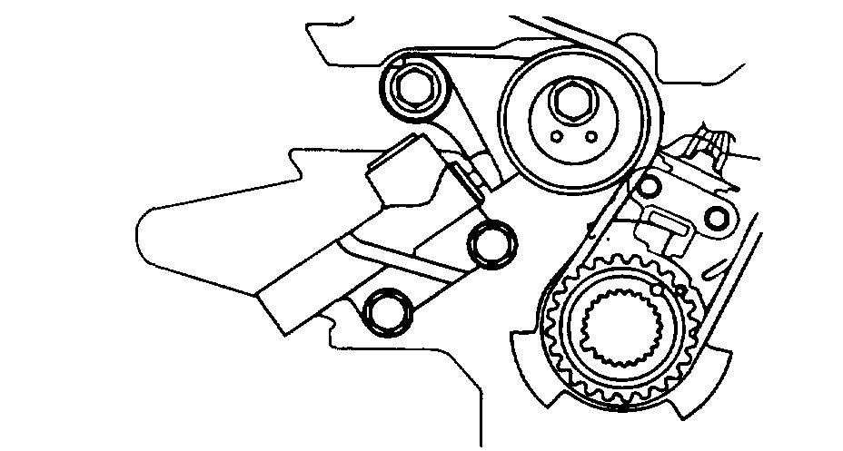

pic 2
4. Remove the auto tensioner.

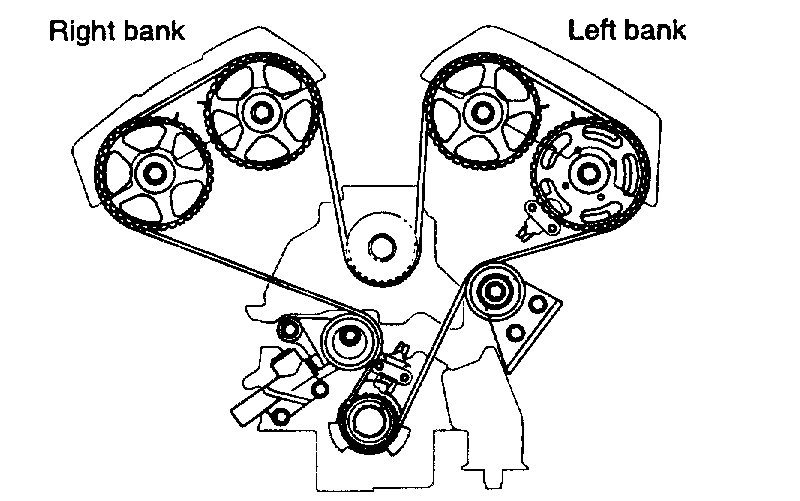

pic 3
NOTE: Rotate the crankshaft clockwise and align the timing mark to set the No. 1 cylinder's piston to TDC (compression stroke). At this time, the timing marks of the camshaft sprocket and cylinder head cover should coincide with each other.
5. Unbolt the tensioner to remove the timing belt.
NOTE: If you plan to use the timing belt again, mark the rotation direction on the belt so you reinstall it correctly.

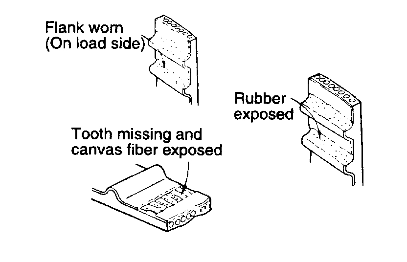

1. Inspect the belt closely. If the following problems are evident, replace the belt with a new one.

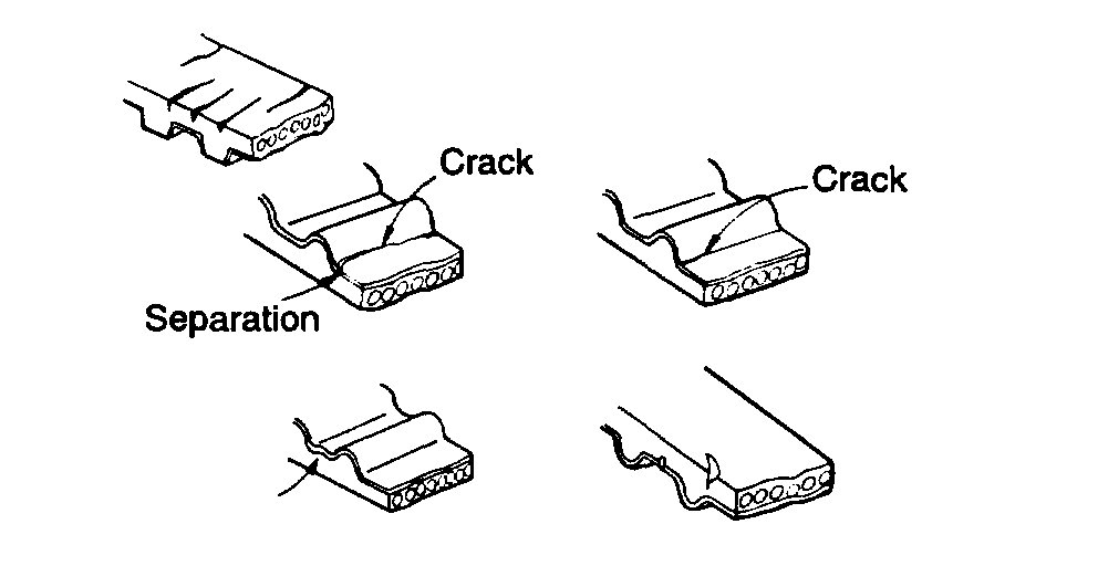

pic 4

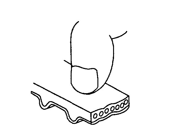

1) Hardened back surface of rubber Back surface is shiny, non-elastic and so hard that when the nail of your finger is pressed into it, no mark is produced.
pic 5
2) Cracked back surface of rubber.
pic 6
3) Side of belt is badly worn.
NOTE: A belt in good condition should have clear-cut sides as if it were cut with a sharp knife.
4) Teeth are badly worn out.
Initial stage: Canvas on load side of the tooth flank worn (fluffy canvas fibers, rubber gone, color changed to white, and unclear canvas texture)
Last stage: Canvas on the load side of the tooth flank worn down and rubber exposed (tooth width reduced).
pic 7
5) Missing tooth
pic 8

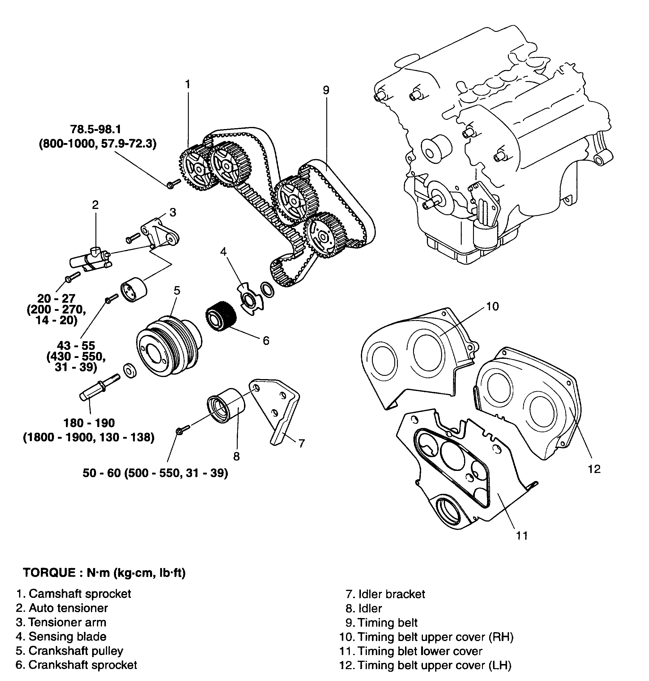

TIMING BELT
INSTALLATION
The method of installing timing belt and auto tensioner.
pic 10
1. Install idler pulley to idler bracket.
pic 11
2. Install tensioner arm, shaft and plane washer to cylinder block.
Tightening torque: 35 - 55 Nm (350 - 550 kg-cm, 25 - 40 ft. lbs.)
pic 12

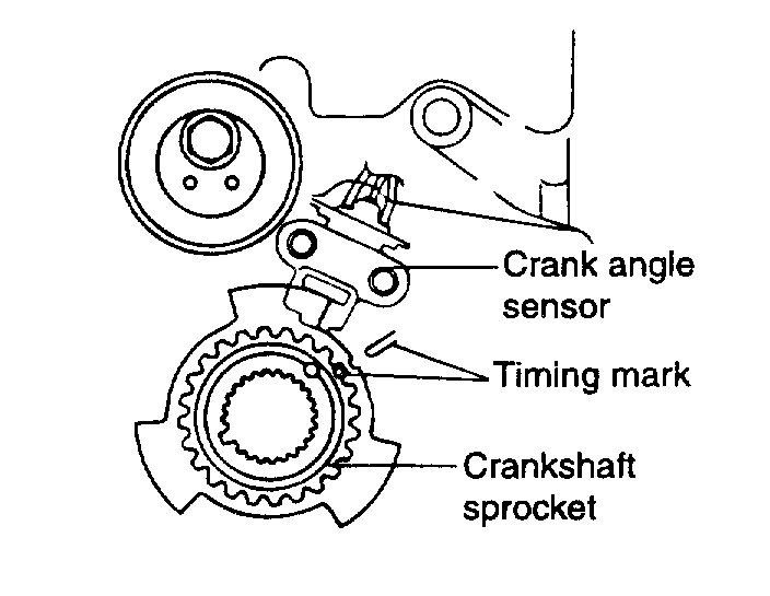

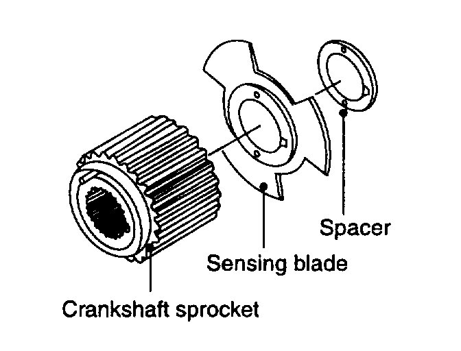

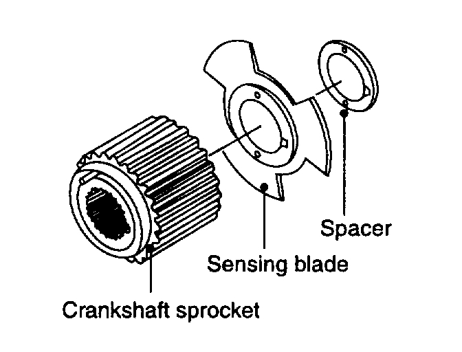

3. Install crankshaft sprocket and align the timing mark.
pic 13
CAUTION: Be careful not to bend crankshaft sensing blade.
pic 14

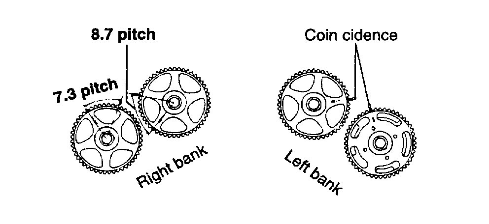

4. Install camshaft sprocket and adjust initial installation state as illustration.
pic 15

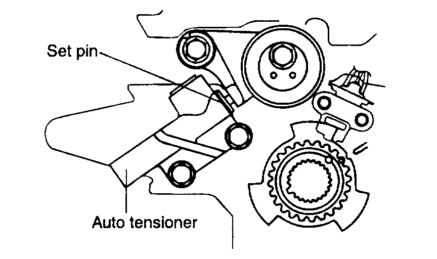

5. Install auto tensioner to oil pump case.
NOTE: At this time auto tensioner's set pin should be assembled completely.

10. Pull out the auto tensioner set pin after adjusting timing belt tension. See: Timing Belt Tensioner > Adjustments

1. Using the drain plug, drain the coolant.
2. Remove the drive belt and the engine coolant pump pulley.
3. Remove the timing belt cover, the auto tensioner and idler pulley.
4. Remove the water outlet fitting, the thermostat case and the water pump fitting.

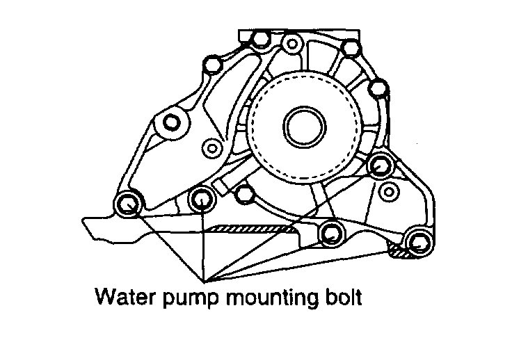

5. Remove the engine coolant pump mounting bolts.
pic 19
6. Remove the engine coolant pump assembly from the cylinder block.

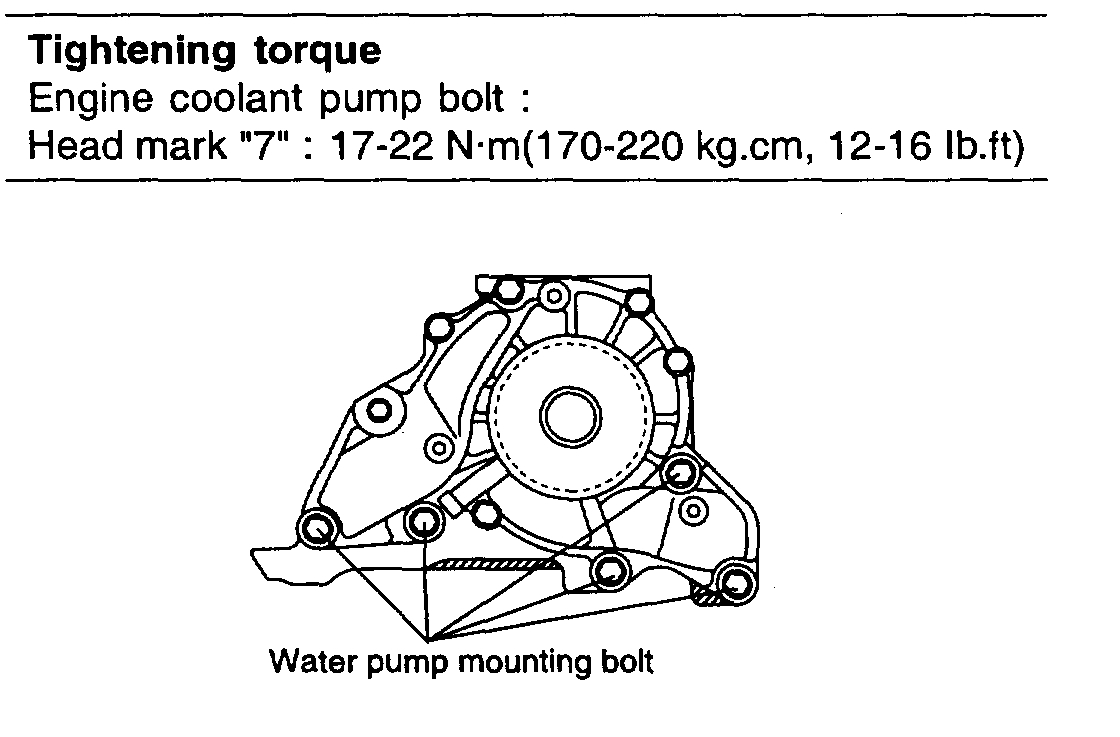

2. Install the new engine coolant pump gasket and pump assembly. Tighten the bolts to the specified torque.
Tightening torque
Engine coolant pump bolt:
Head mark "7": 17 - 22 Nm (170 - 220 kg-cm, 12 - 16 ft. lbs.)
