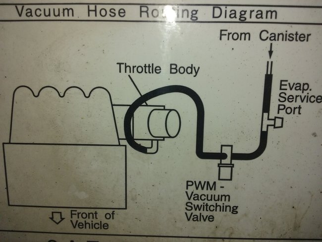

Video i viewed showed a water hose being ran through a hose under the hood and the water came out the evaporator drain hose under car. I cannot seem to locate hose under hood. Attaching a picture of what may have something to do with it.

That i feel will be a heater hose and the problem may be a leaking heater core, this can cause coolant to leak from under the dash onto the carpet, a pressure test will show this up.
