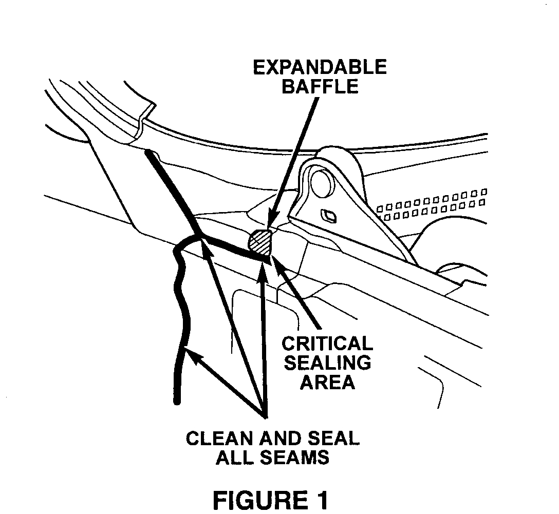

Picture 1 correlates with this portion

10. Inspect the A-pillar/cowl load beam body seams (Figure 1). Remove any excess/squeezed out, over expanded, body sealer material from the seams. Clean area with Mopar Super Clean, p/n 04318015, or equivalent.
11. Seal all body seams with Mopar Paintable Repair Sealer, p/n 04318026, or Mopar Firm Setting Body Sealer, p/n 04856952, or equivalent.
12. Allow sealer to cure. Then water test vehicle to make sure no water is entering the A-pillar/cowl area.
