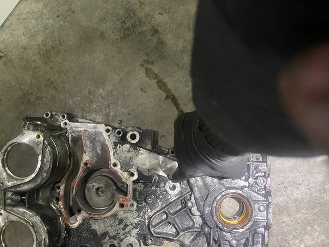

I removed the mount and the bracket again, turned out coming from a 12 mm bolt that comes already tightened on the new cover. Supposed to be a torx one but since its after market they used a 12 mm, only had to tighten it a bit and it stopped seeping. Its the bolt on top of where am pointing

But, there is no coolant in that part of the cover, are you sure it was not coming from the water pump? Does the timing cover have a crack in it?
Jan 21, 2026 at 9:00 AM
BHAMDOC1
  • 101 POSTS
no cracks, it's a new cover, there is a bolt in the original and the new cover that is below the water pump, not sure what it's for. it was just not tight enough, it sits right below the pump, ya am 100% sure it was from there and no more leak is coming from it
