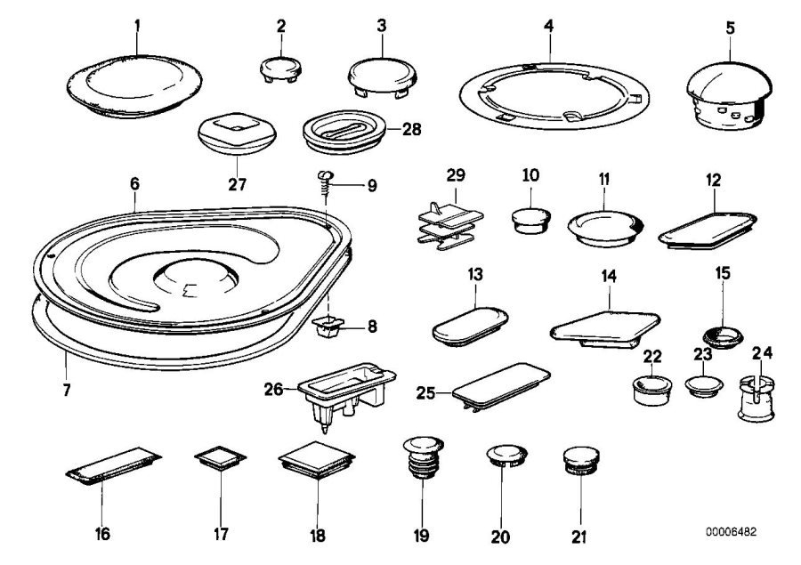

This model of BMW has had issues with the body plug mounted behind the passenger foot-well carpet area on the firewall. Pull back the carpet on the front passenger side and look for the body plug, pour water down the windshield and cowl area then look for the water leaking. You can either replace the plug or remove the body plug and put silicone on the sealing surface of the plug then re-install it. The rear passenger area will show signs of leakage because the front has better padding and will take longer to soak through. The body plug will look similar to #28 in the picture.
