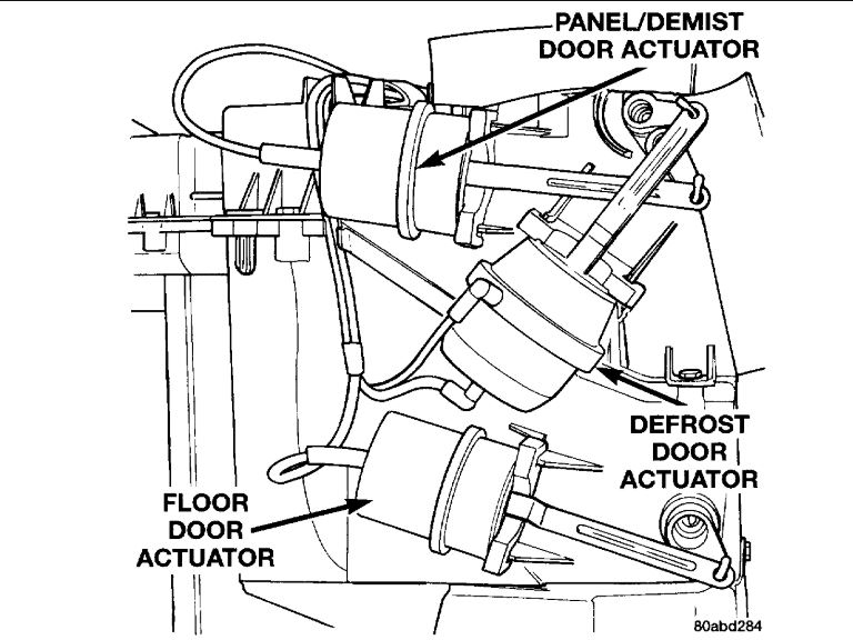

Like I said, it will only blow air our through the defroster setting. If I switch it to A/C setting, nothing comes out. I think my son put a different settings panel in there last summer, but it didn't help.
Jul 22, 2019 at 1:07 PM
A/C in your original post you said the A/C does not work.
If you have defrost only, that could be an actuator but has nothing to do with the water leak.
I attached a picture of the defroster motor. Check for any vacuum to the motor with the command at the vents.
Jul 22, 2019 at 1:21 PM
