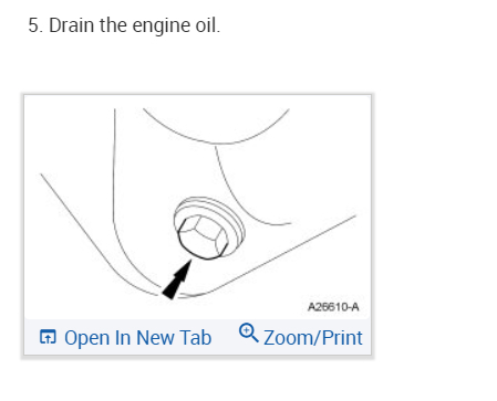

Just one mile is a little short for cold weather applications. I would do an oil change and then mark the oil fill cap to see if it gets removed by someone else. Here is a guide to help walk you through the steps with diagrams below to show you on your van:
https://www.2carpros.com/articles/how-to-change-engine-oil-and-filter
