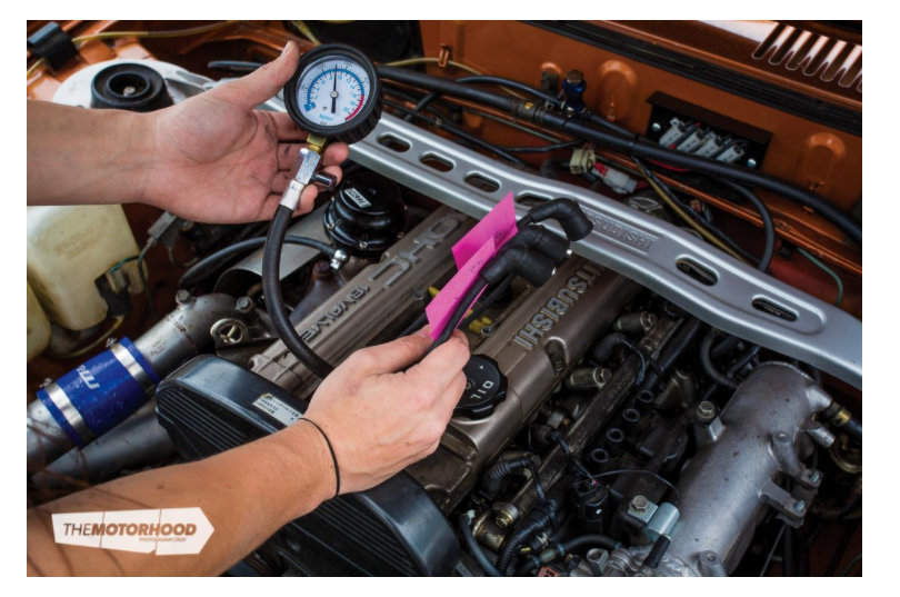

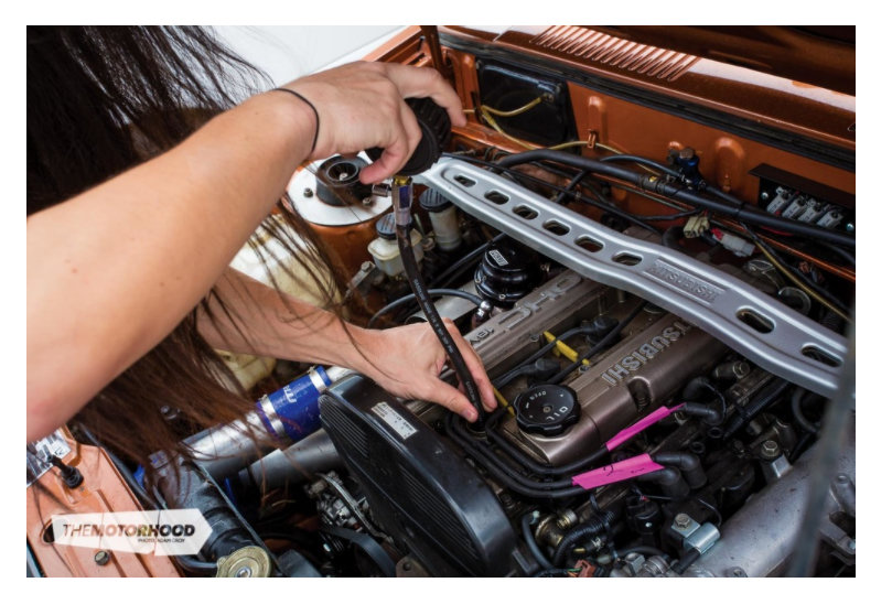

Hello.
Here is another video you may find helpful and a couple of diagrams:
https://www.youtube.com/watch?v=zCR6wahr9FU
