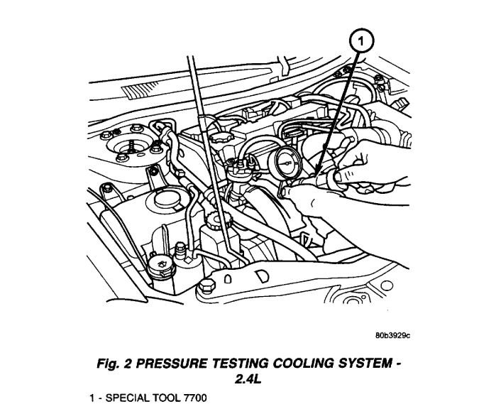

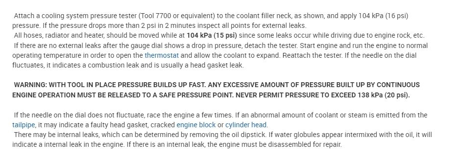

You will need to pressure test the system to determine the source of the leak.
https://www.2carpros.com/articles/radiator-pressure-test

Can you do a pressure test? You can rent one at a parts store.
