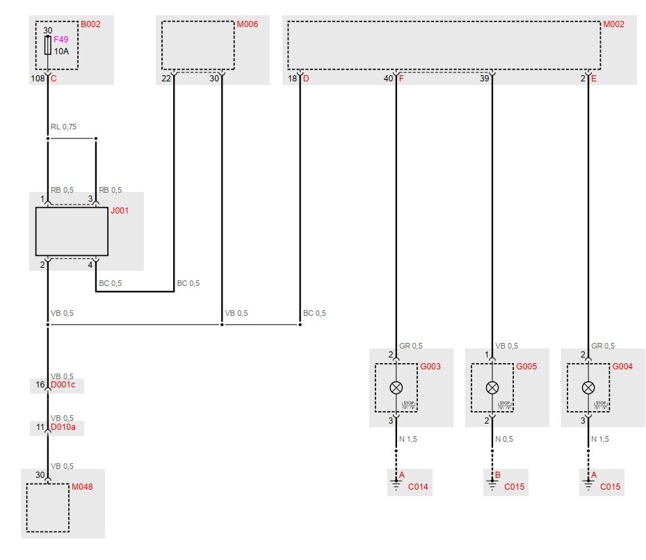

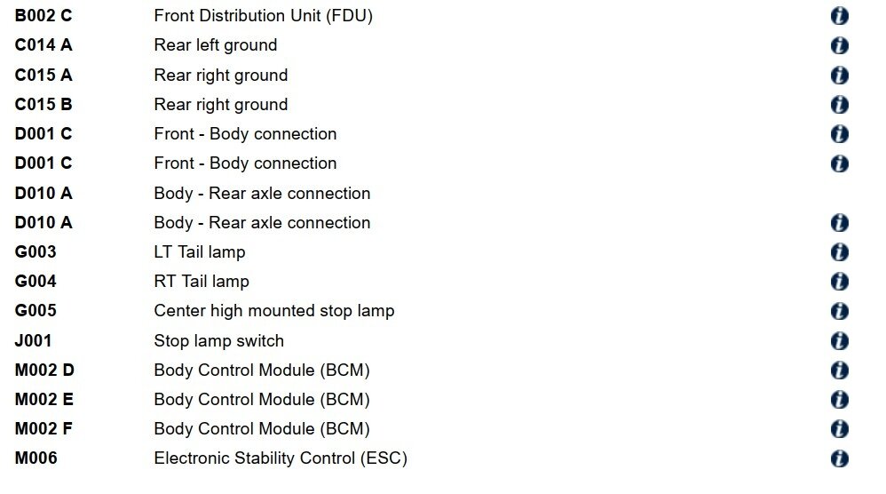

HMM, They show logic involved. Could be a different option? OK might have found it, the lamps are controlled through the body module, they might have a current sensing system that shuts the lamp down if it's draws excess current. If the contacts were shorted by corrosion so it tried to turn on more than the single lamp that could be the issue.
You should have gotten a link in messaging to service info, it might help.
