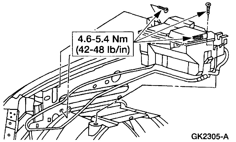

See picture 1
1. Disconnect the jack handle from the windshield washer reservoir.

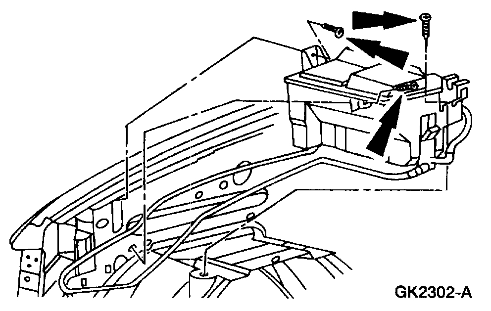

See picture 2
2. Disconnect the electrical connectors.

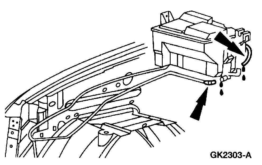

See picture 3
3. Remove the windshield washer reservoir screws.

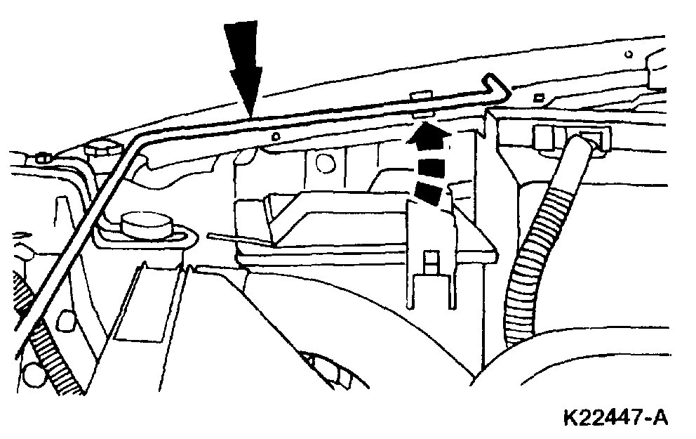

See picture 4
4. Disconnect the windshield washer hoses.
NOTICE: Windshield washer fluid should be collected in a container after the windshield washer hoses are disconnected.
5. Remove the windshield washer reservoir.

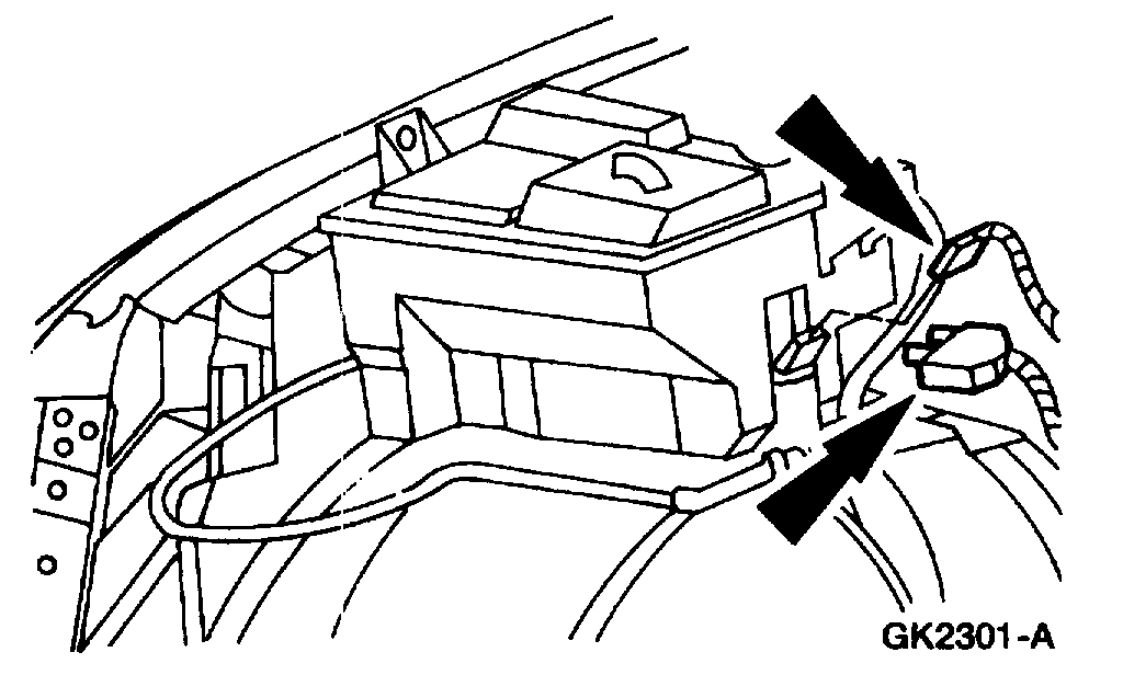

See picture 5
6. Remove the windshield washer pump.

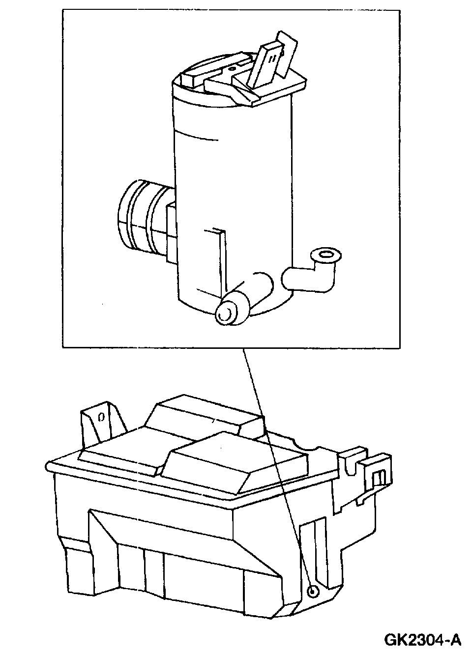

See picture 6
1. To install, reverse the removal procedure.
^ Fill the windshield washer reservoir with Ultra-Clear Windshield Washer Concentrate C9AZ-19550-AC or BC or equivalent meeting Ford specification ESR-M17P5-A.
CAUTION: Do not operate the windshield washer pump prior to filling the windshield washer reservoir.
