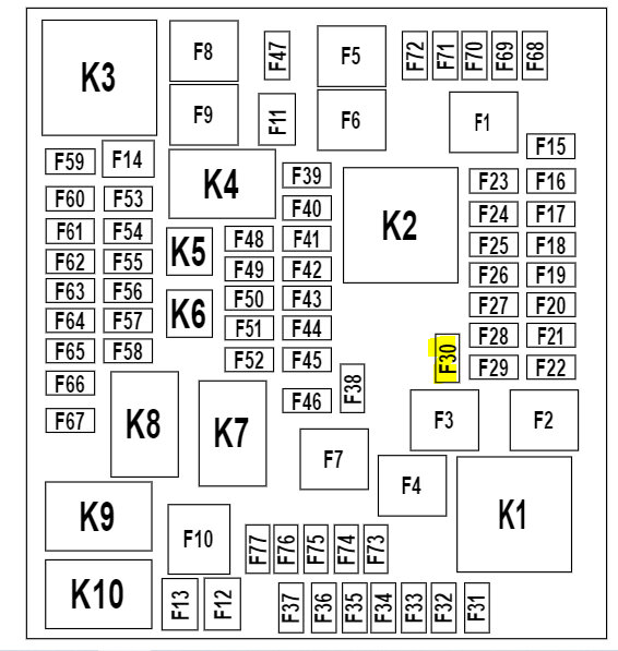

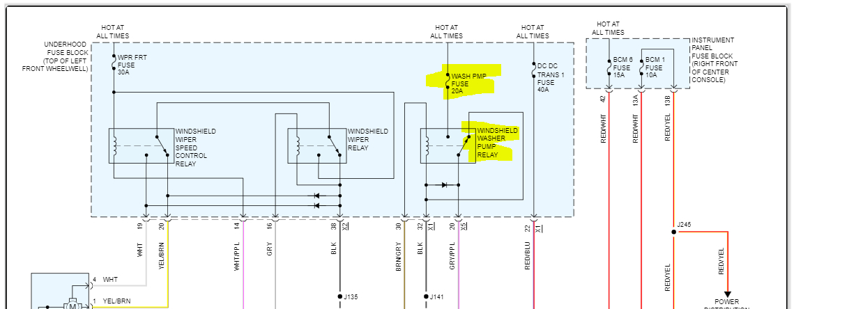

Before replacing the pump, make sure that the fuse is good and has power to and from it.
Note there is a relay as well.
Here is a link that explains how to test one:

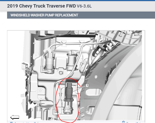

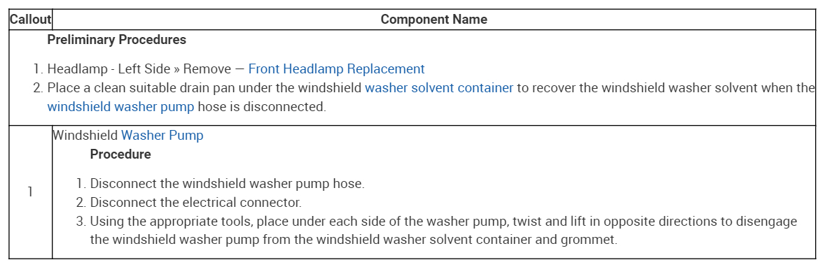

If you look below, pics 1 and 2 are the directions for replacing the pump. Pics 3 and 4 provide the fuse information.
Let me know if this helps.
