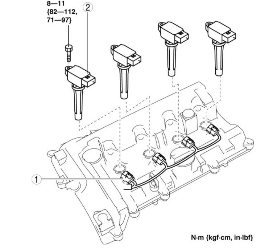

It sounds like the engine is misfiring which will make the lights come on, @ 65k it is time for a set of spark plugs and coils. Here is how the job is done, then clear the codes after words, it should cost about $500.00 for parts and labor, this is what needs to be done.
Recommended Spark Plugs:
NGK Iridium IX - Part Number: ILTR6A-8G
Denso Iridium TT - Part Number: 4712 (or SK20R11 equivalent)
Tightening torque - 15-20 N-m [1.6-2.0 kgf-m, 12-14 ft-lbf]
Gap: 0.044 inches
