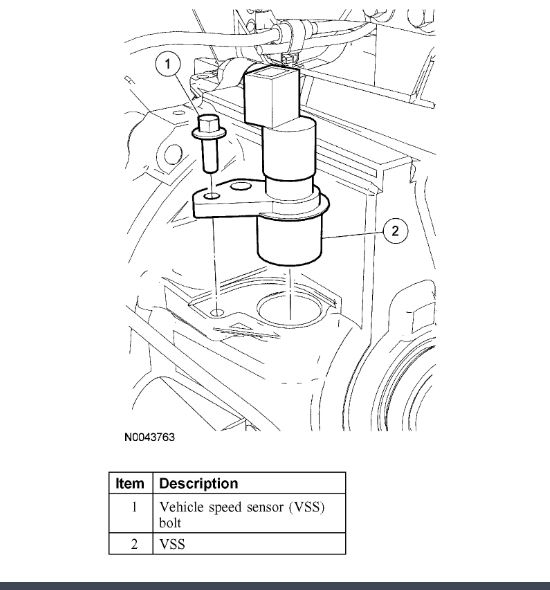

There are fault codes stored for the lights on the dash. The ABS system is most likely the reason for the all the lights.
https://www.2carpros.com/articles/abs-warning-light-on-easy-repair-guide
You can go to a parts store and have them read the codes. At that pint, let me know the codes and I can help narrow the area of failure for you.
The speedometer not working is most likely the issue. There is a sensor for this but the code will confirm this for us.
Image (Click to enlarge)
