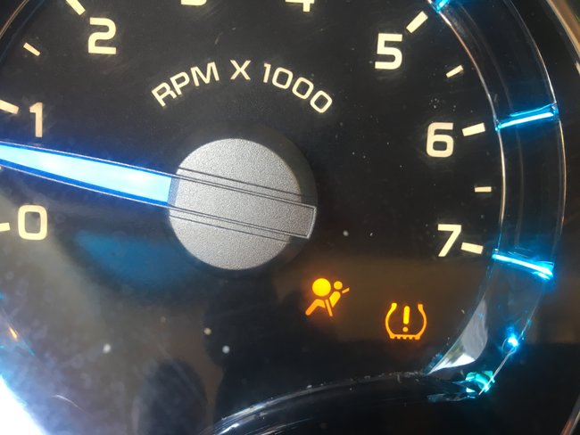

How to get airbag warning light off?
Jul 12, 2018 at 7:33 AM
DANNY L
  • 5,648 POSTS
Hello, I am Danny.
Unfortunately, if there is an SRS (supplemental restraint system) code stored it will keep coming on until the problem is fixed. Even if you disconnect the battery it will come back on after a few miles.The SRS system covers the airbags, seat belts,and all components related to those systems. Some auto part stores do offer free code scanning services (Pep Boys, O'Reillys, AutoZone). I have attached a link for you below. Hope this helps and feel free to ask any further questions if needed. Thanks for using 2CarPros.

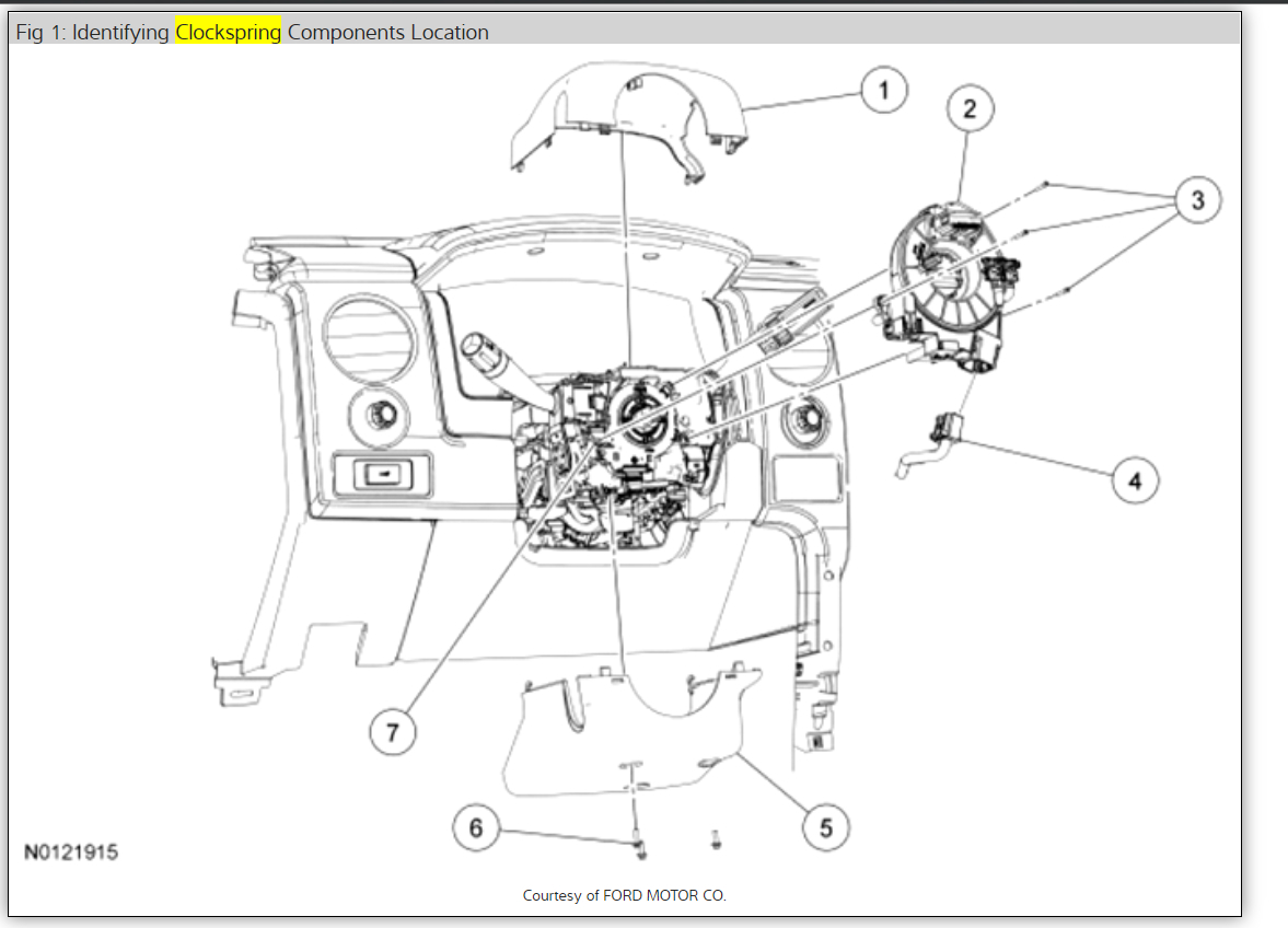

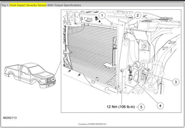

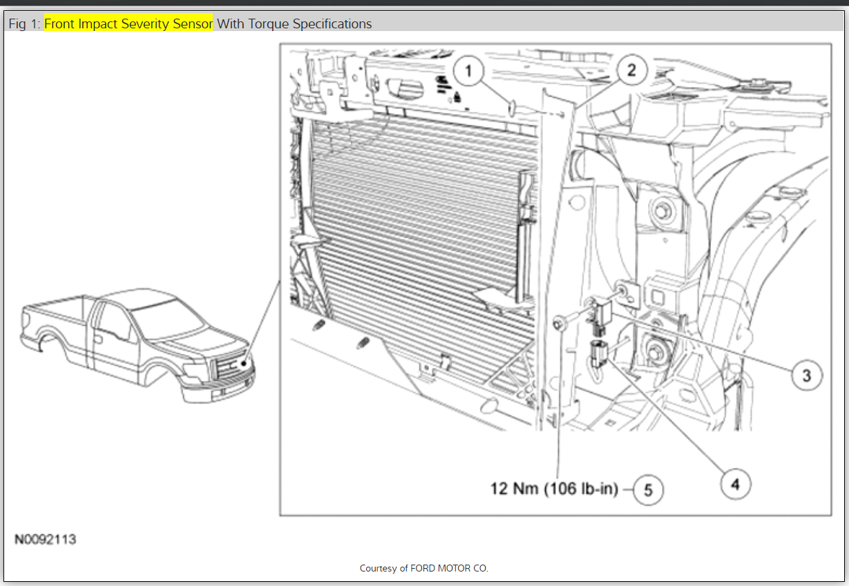

Nine time out of ten it is the clock spring behind the steering wheel or one of the impact sensor is unplugged.
https://www.2carpros.com/articles/steering-wheel-clock-spring-removal
Here is how on your car. Check out the diagrams (below). Please let us know what you find. We are interested to see what it is.
