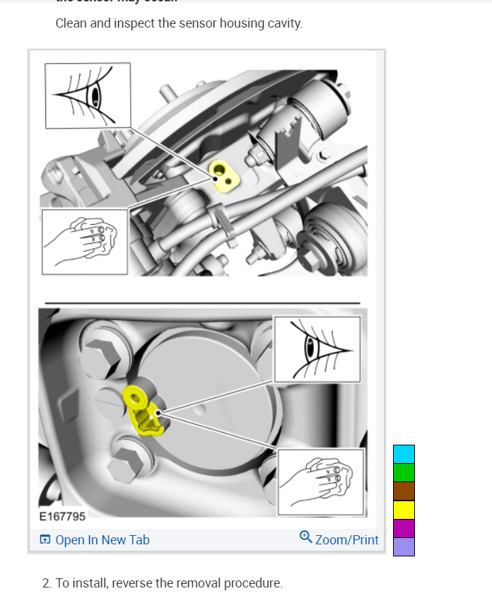

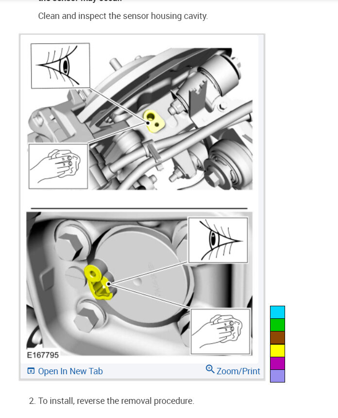

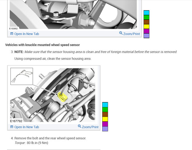

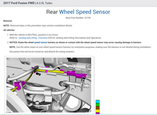

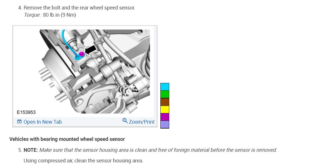

Is the loud howling noise the ABS being activated? You might have a wheel speed sensor that needs to be replaced because the wiring got damaged when you were in the snow. We need to run the codes to see what comes up. here is a video to show you how, it is for the ABS, but the traction control is the same system:
https://youtu.be/rTtAnsOlZU4

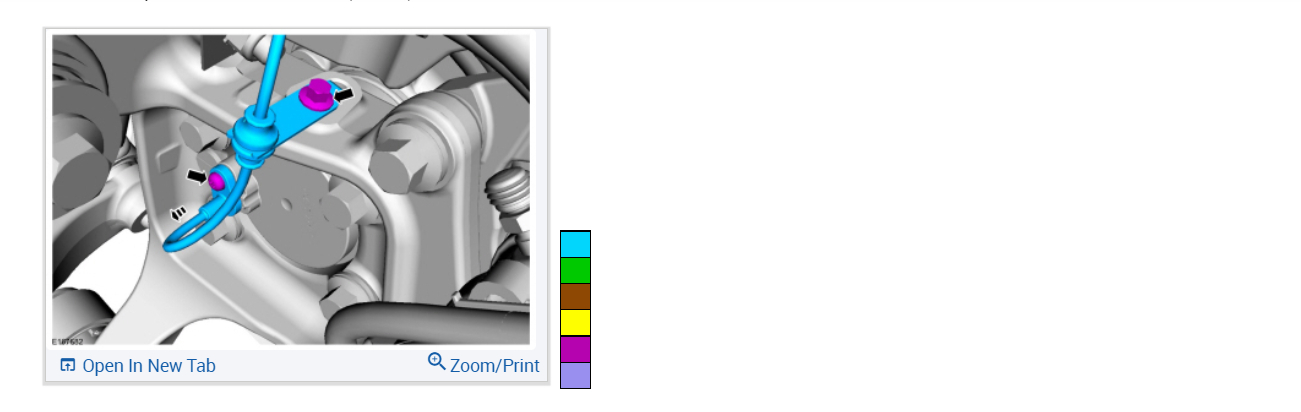

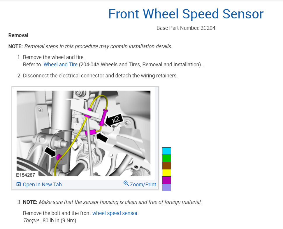

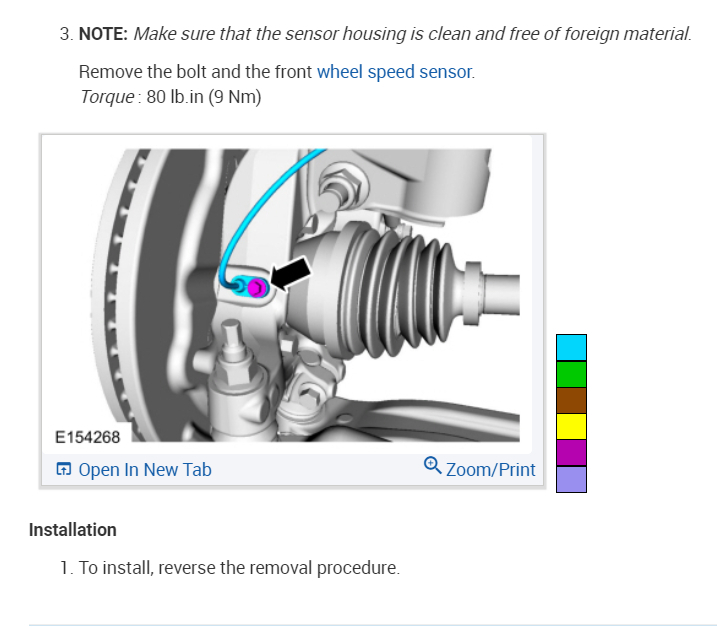

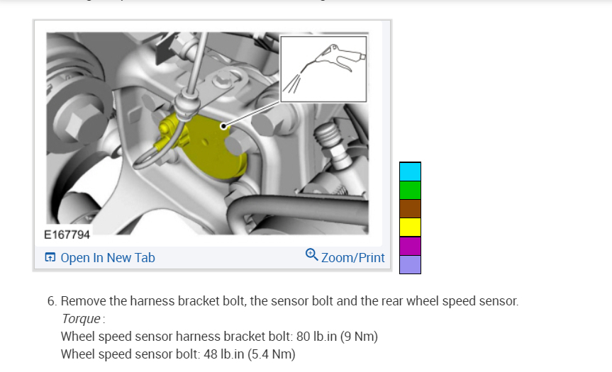

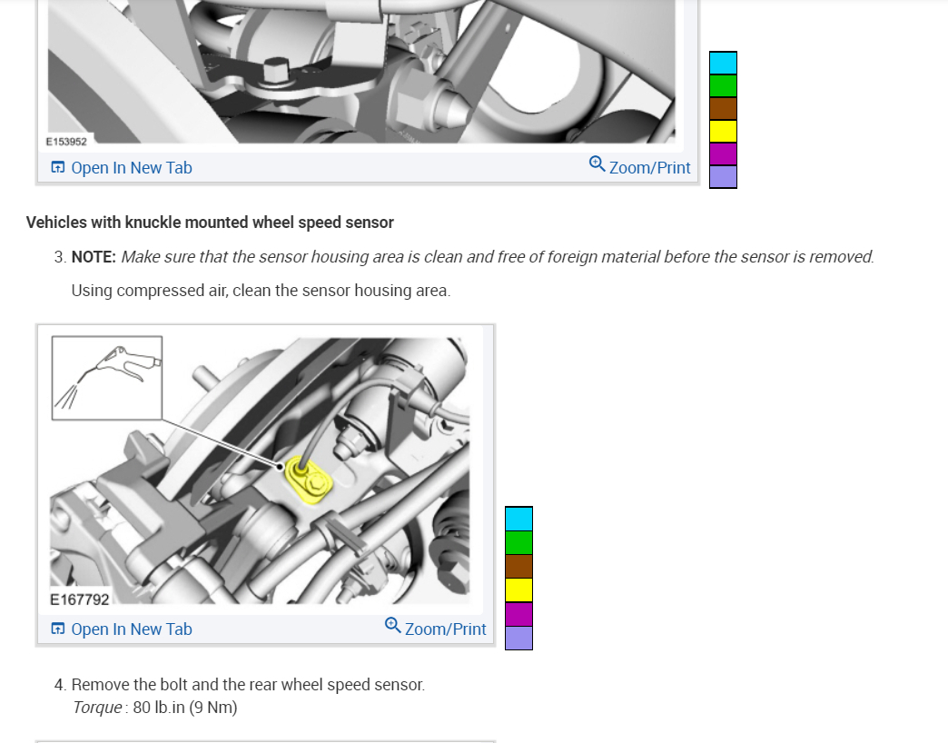

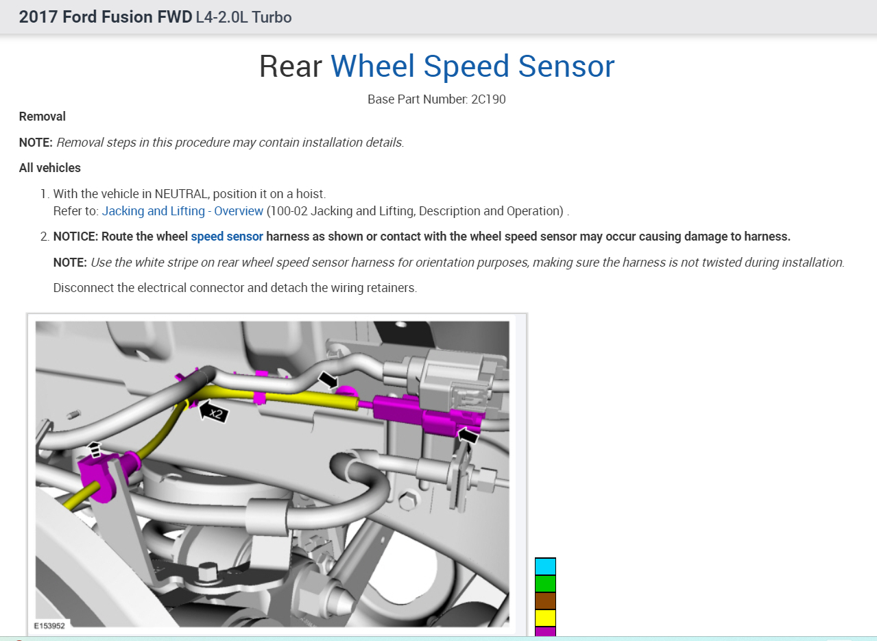

Let me know which code it is, and I have included how to replace the front and rear sensor in the images below in case that is the problem. Check out the images (below). Please let us know what you find. We are interested to see what it is.
