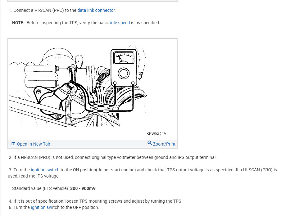

Couple things. First what was the reason for replacing the TPS? Second what codes do we have now?
You are able to adjust this TPS so I attached the process just in case that turns out to be the issue.
Let me know what codes you have and we can go from there. Thanks
