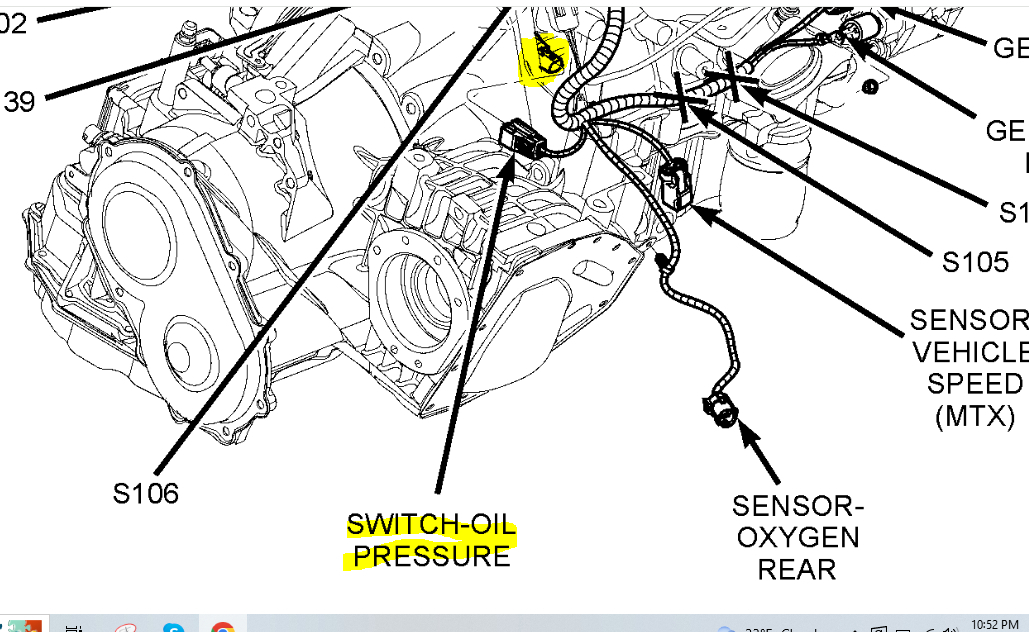

If there were no noises, chances are it is related to the oil pressure sensor or a wire/connector issue. The sensor is on the side of the engine close to the engine oil filter. See pic 1. Check to see if the connector is not damaged or loose. Also, confirm the wiring isn't damaged.
Additionally, disconnect the electrical connector and check to see if there is oil in the connector itself. Often when the sensor fails, it allows oil to leak through the sensor.
See pic below.
