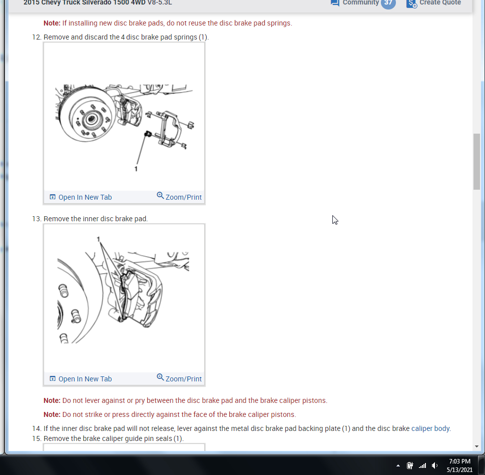

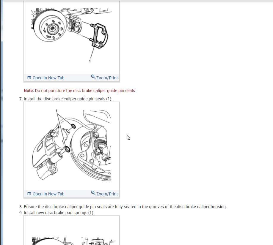

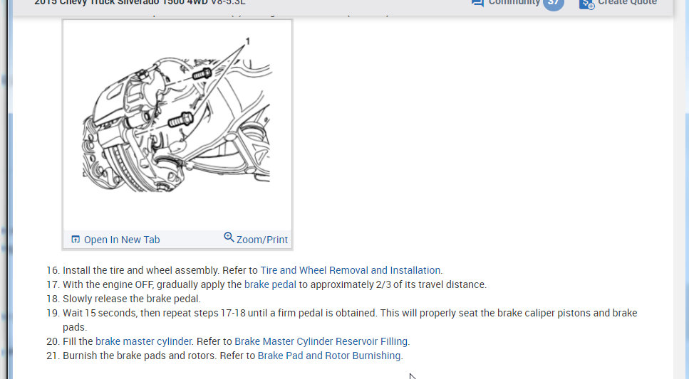

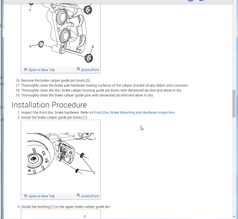

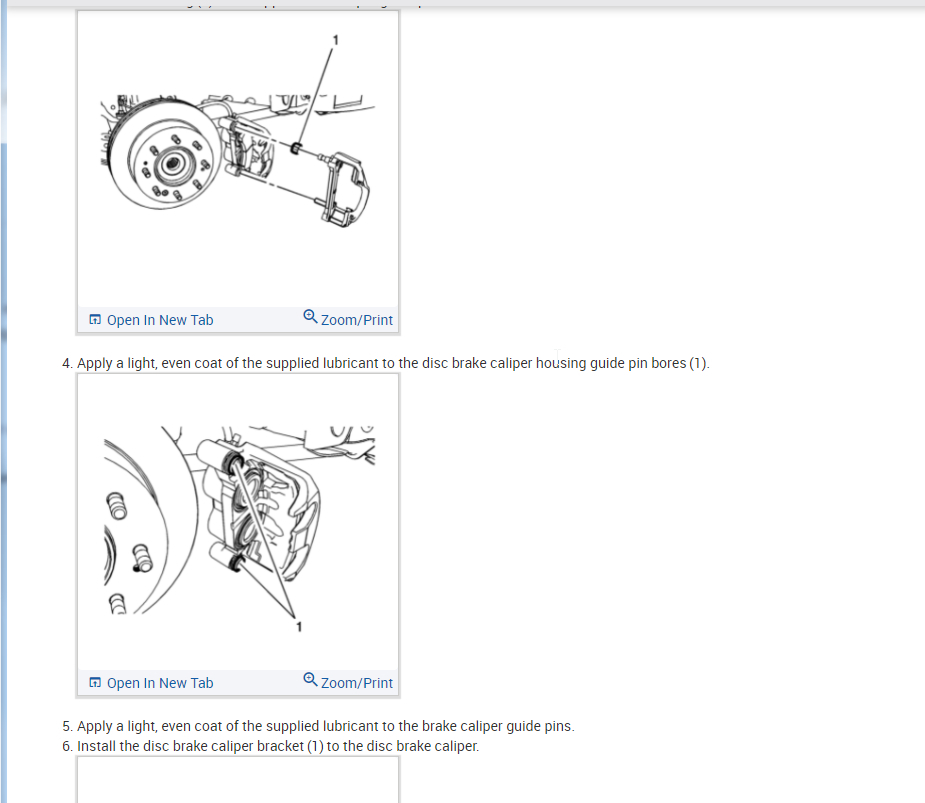

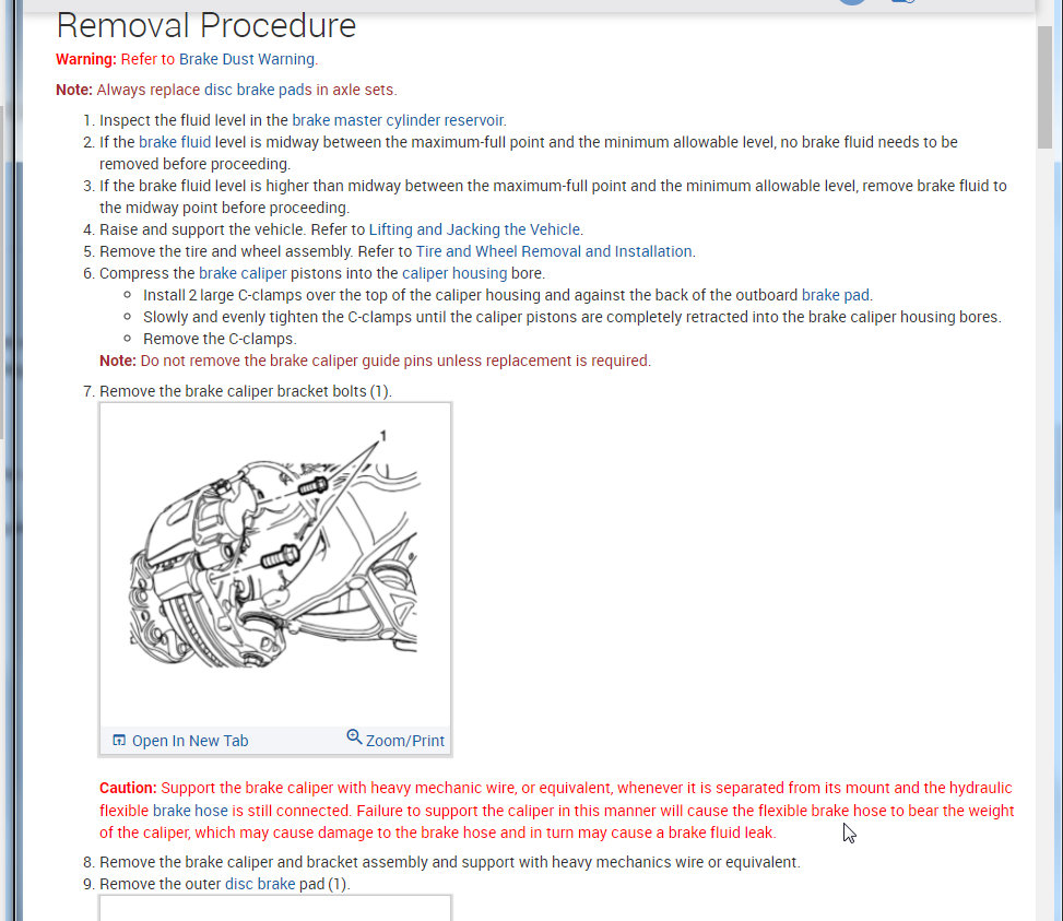

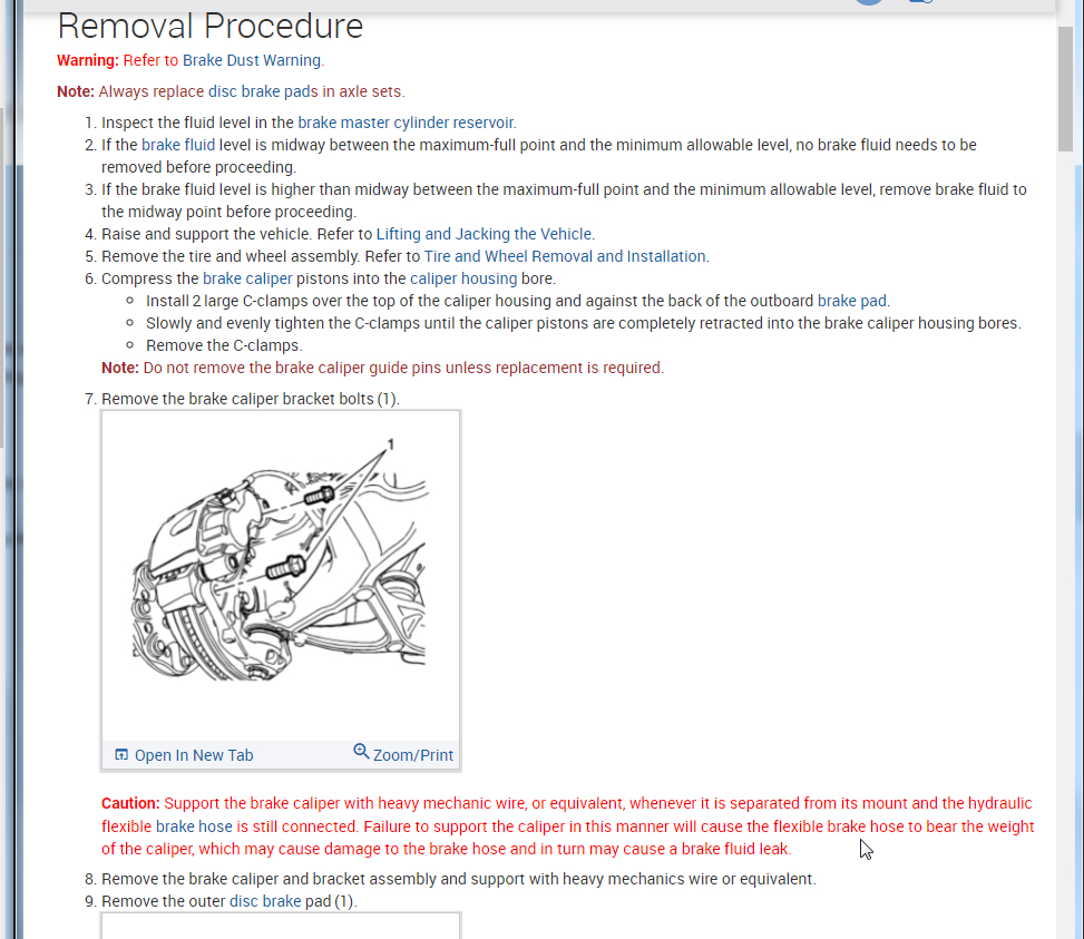

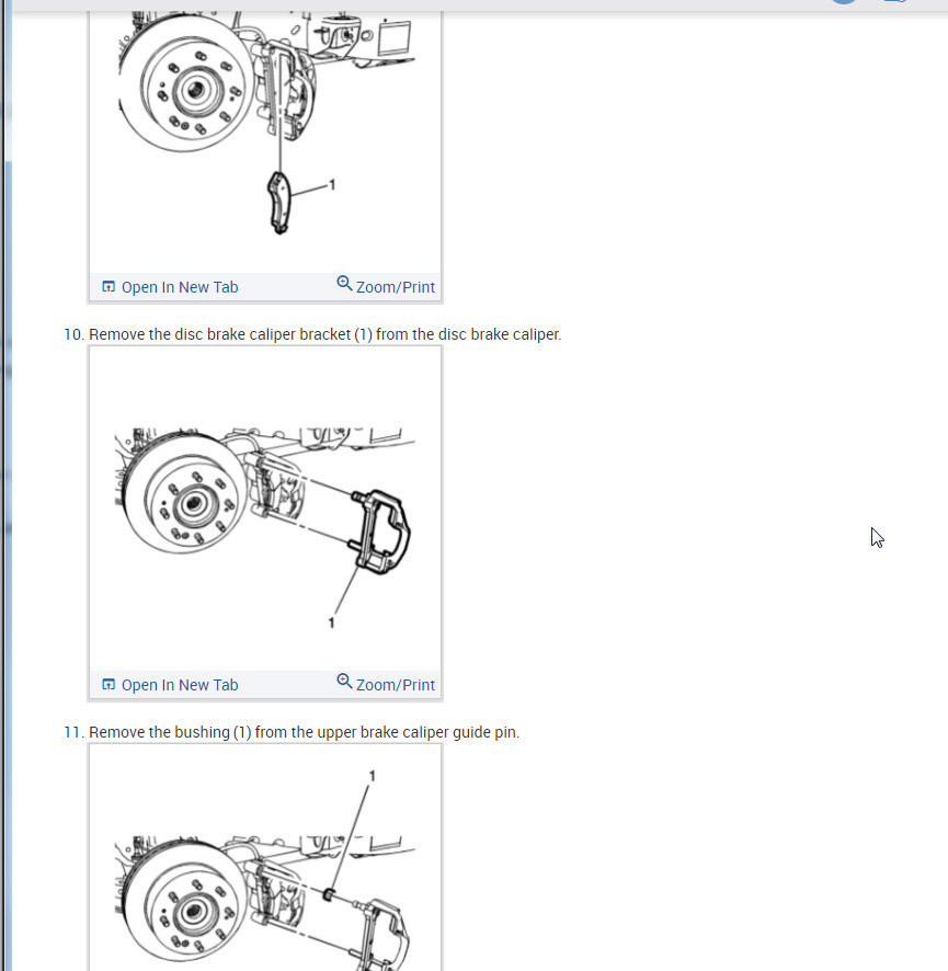

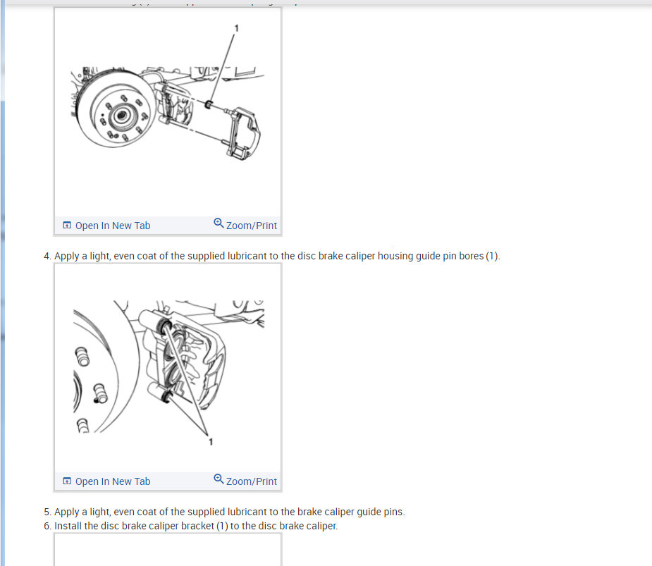

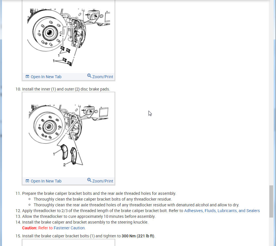

Here is a guide that will help with this:
Here is a video that will help as well:
https://www.youtube.com/watch?v=jlKijXftTmw
Below is the process from the manual that will help with this. Please run through all this info and let us know if you have other questions. Thanks
