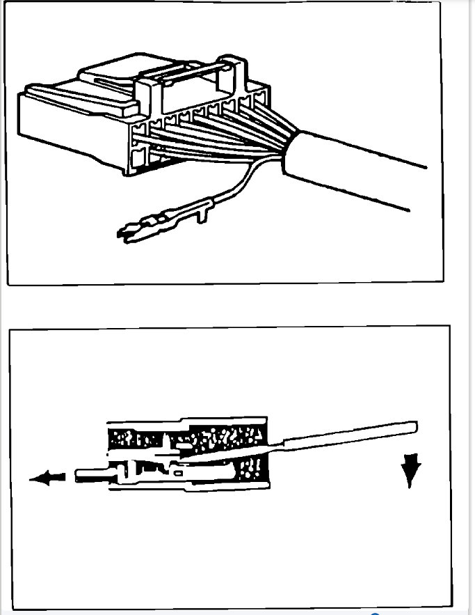

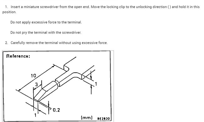

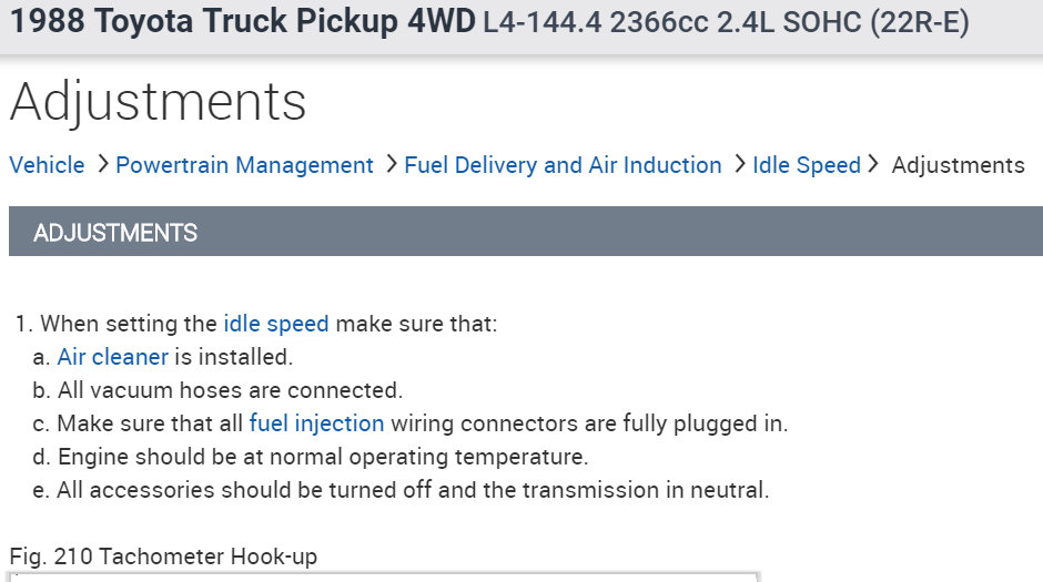

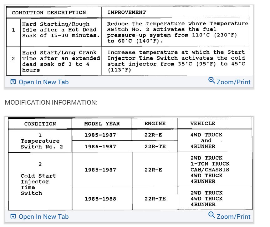

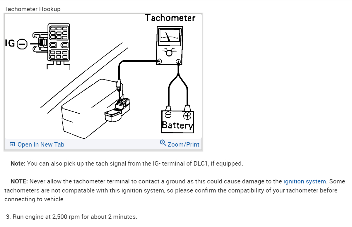

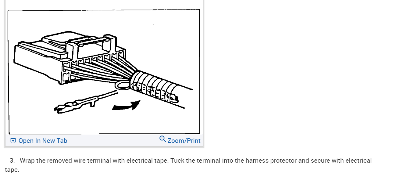

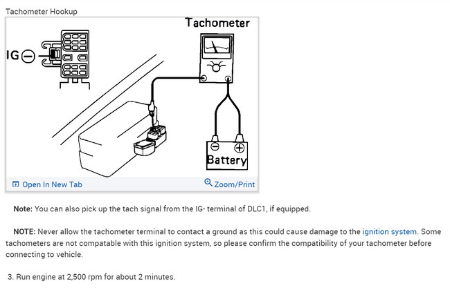

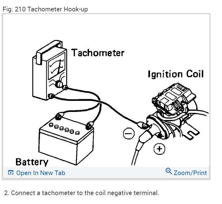

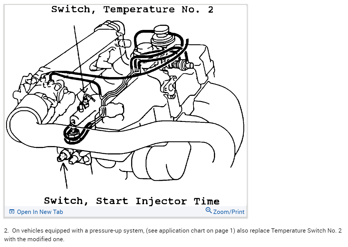

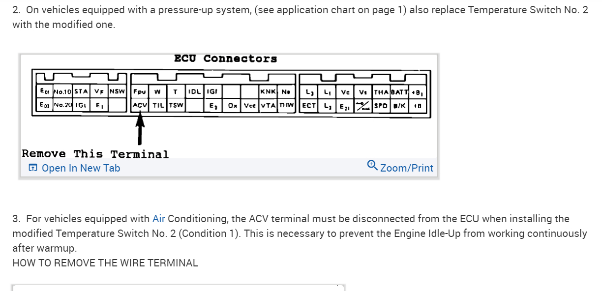

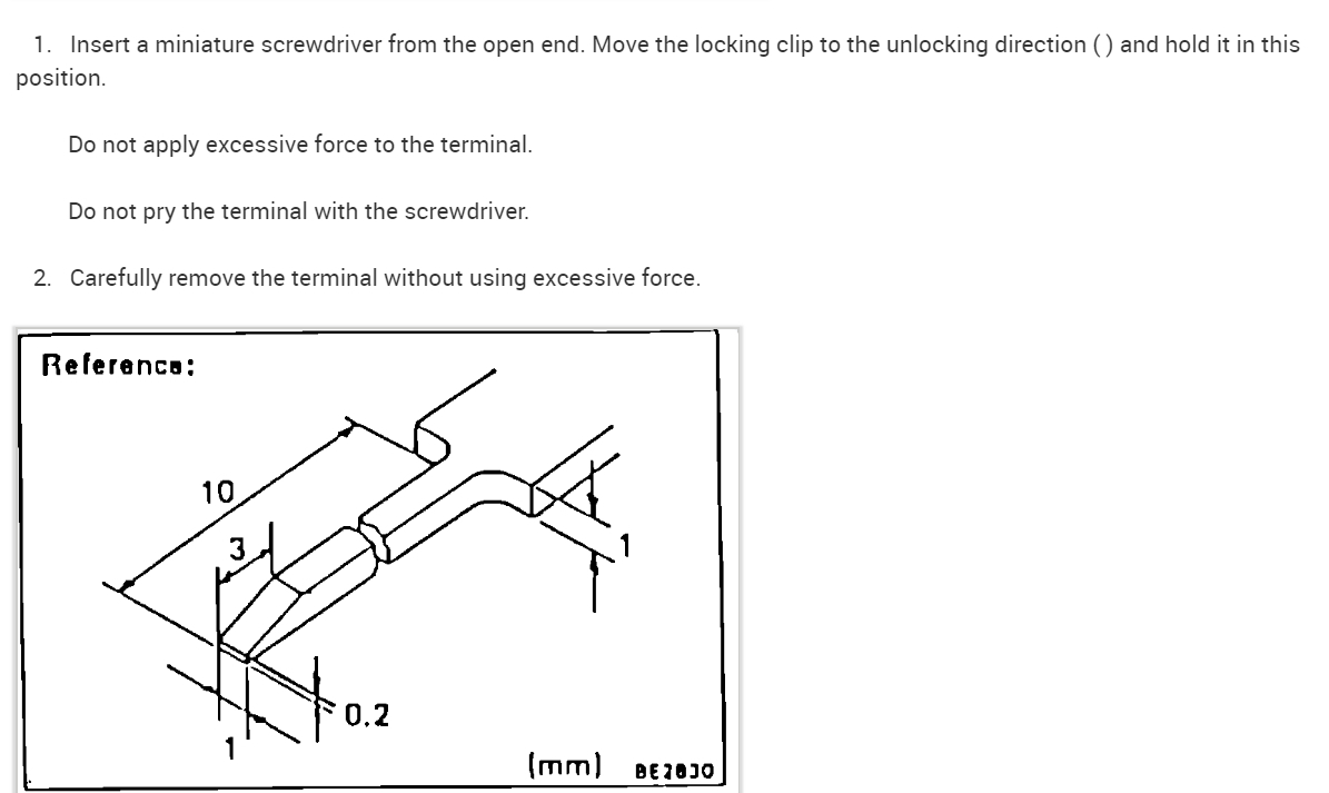

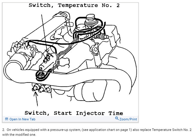

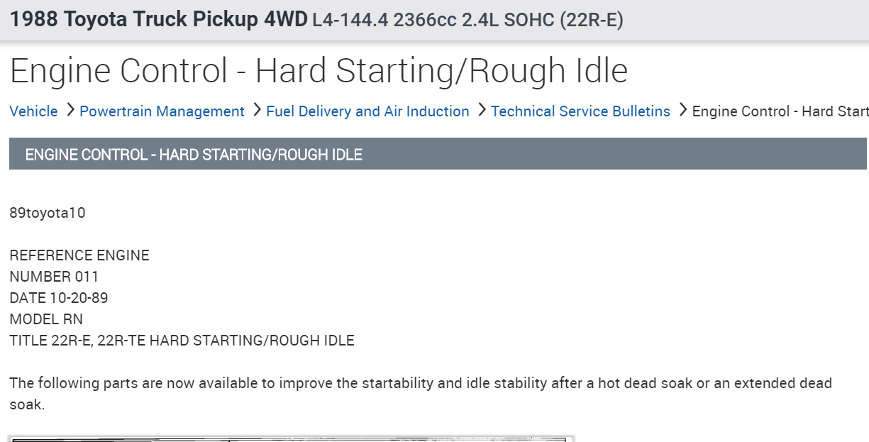

This could be a problem with your idle control. I have included in the diagrams down below a Technical Service Bulletin(TSB) from Toyota and step by step instructions on how to adjust idle speed as well. Also, I have included a link down below that covers all other possible reasons for your vehicles condition. Get back to us and let us know what you find out.
https://www.2carpros.com/articles/engine-hesitates
Thanks,
Alex
2CarPros
