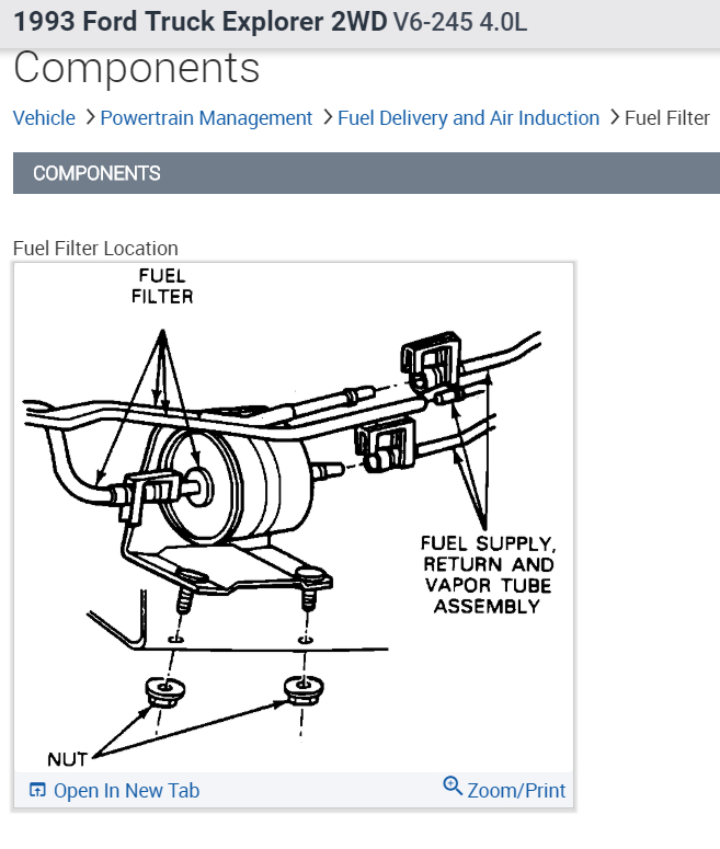

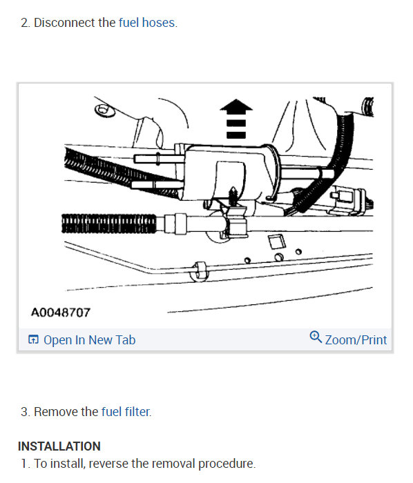

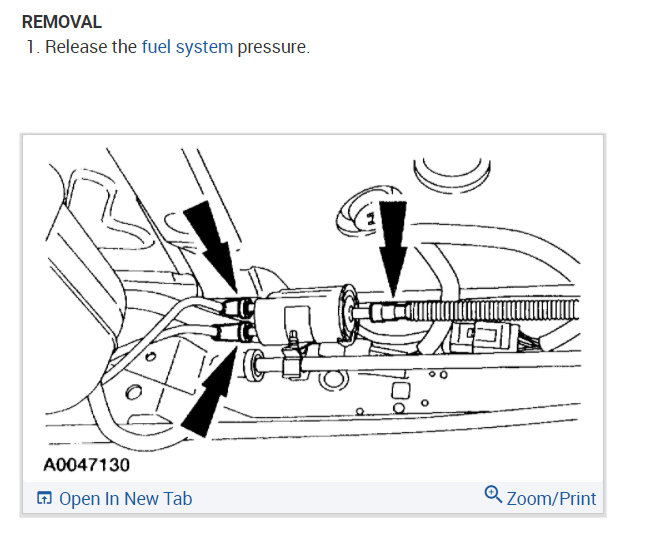

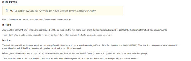

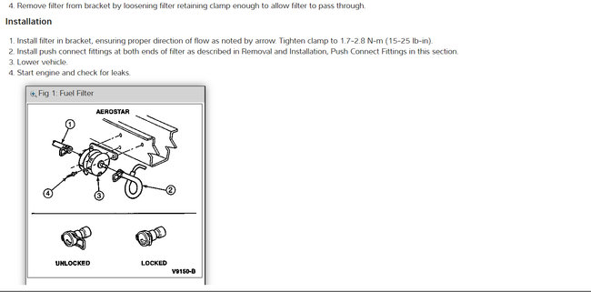

Hi Melonie Hicks, my name is Alex and I will be helping you. Here is the information you requested. It's near the tank under the vehicle along fame rail. This video will help you remove the filter with instructions below to show you how to replace the fuel filter in your car.
https://youtu.be/Boi0DPXVHbM
and
https://www.2carpros.com/articles/how-to-change-a-fuel-filter
Check out the diagrams (Below). Please let us know if you need anything else to get the problem fixed. Hope this helps.

It's mounted inside the frame rail on the left side, just behind the driver.

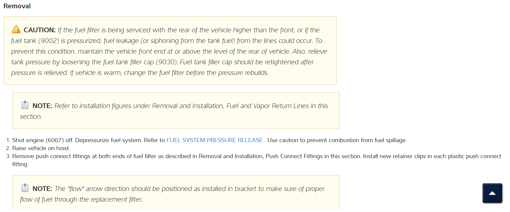

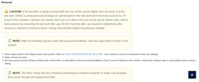

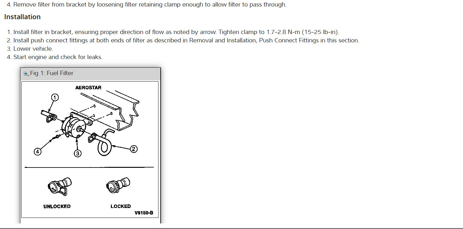

REMOVAL CAUTION: If the fuel filter is being serviced with the rear of the truck higher than the front, or if the tank is pressurized, fuel leakage or siphoning from the tank fuel lines could occur. To prevent this condition, maintain the vehicle front end at or above the level of the rear of vehicle. Also, relieve tank pressure by loosening the fuel fill cap. Cap should be retightened after pressure is relieved. If vehicle is warm, change the fuel filter before the pressure rebuilds. 1.Shut engine Off. De-pressurize fuel system. Use caution to prevent combustion from fuel spillage. 2.Raise vehicle on hoist. 3.Remove push connect fittings at both ends of fuel filter. Install new retainer clips in each push connect fitting. 4.Remove filter from bracket by loosening filter retaining clamp enough to allow filter to pass through. INSTALLATION 1.Install filter in bracket, ensuring proper direction of flow as noted by arrow. Tighten clamp to 1.7-2.8 Nm (15-25 lb in) . NOTE: The "flow" arrow direction should be positioned as installed in bracket to ensure proper flow of fuel through the replacement filter. 2.Install push connect fittings at both ends of filter. 3.Lower vehicle. 4.Start engine and check for leaks.

Your fuel filter should be frame mounted (drivers side I think). You will find it along the fuel line from the tank to the engine under the seating area.

The fuel filter is under drivers seat on frame rail here is a video to help you remove the lines and a diagrams below to show you the location.
