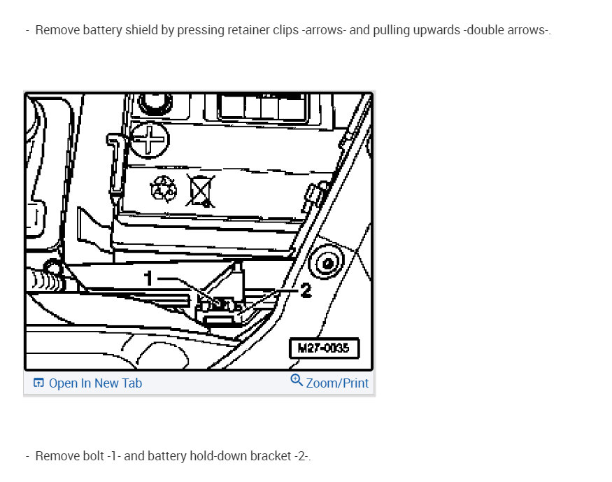

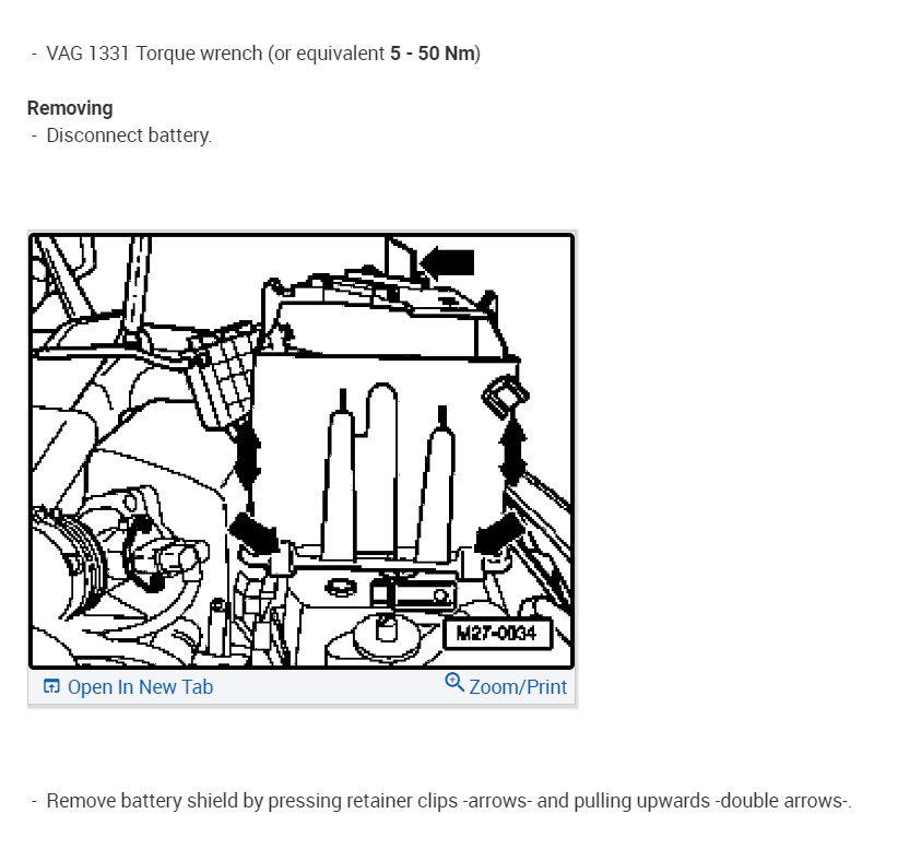

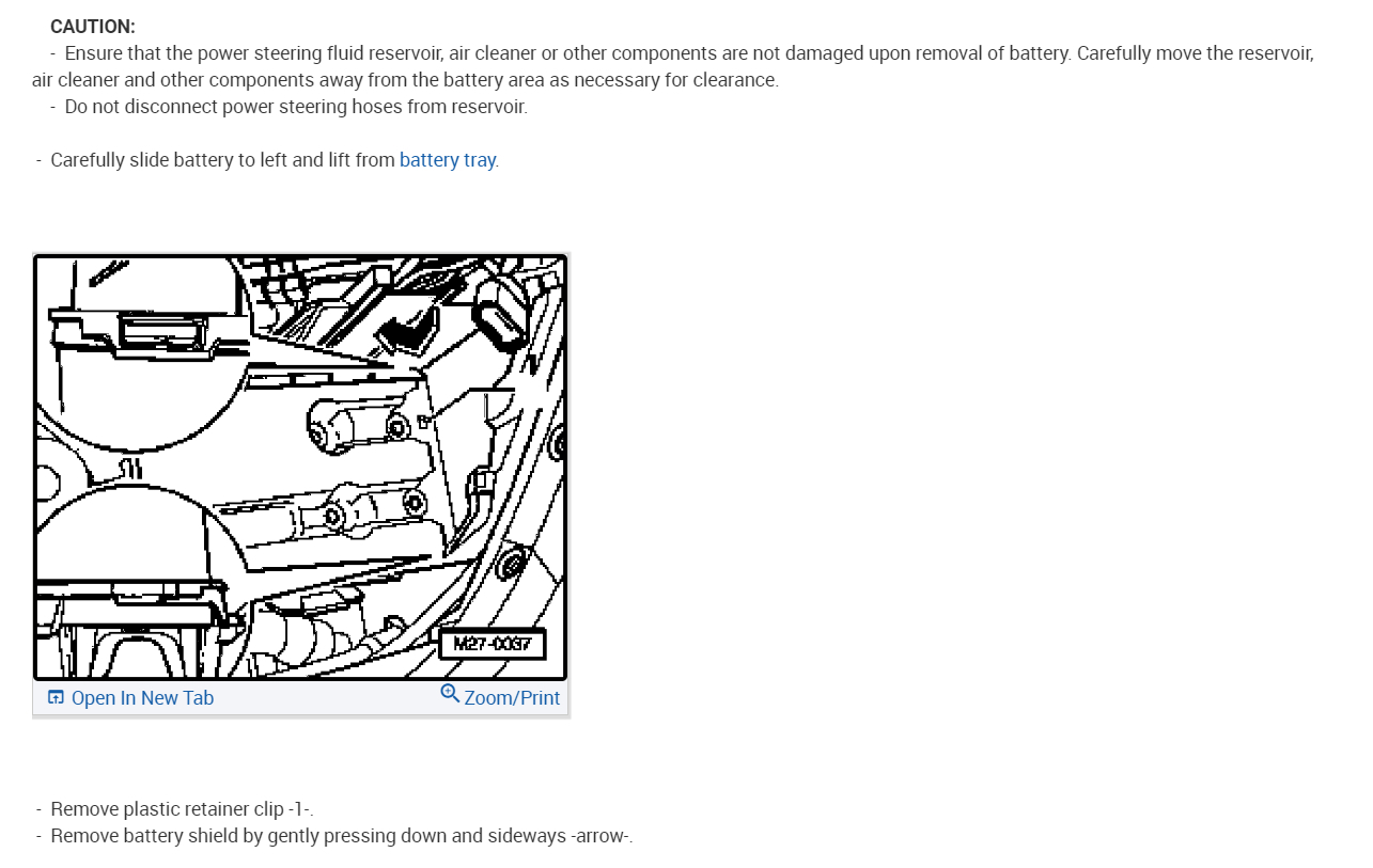

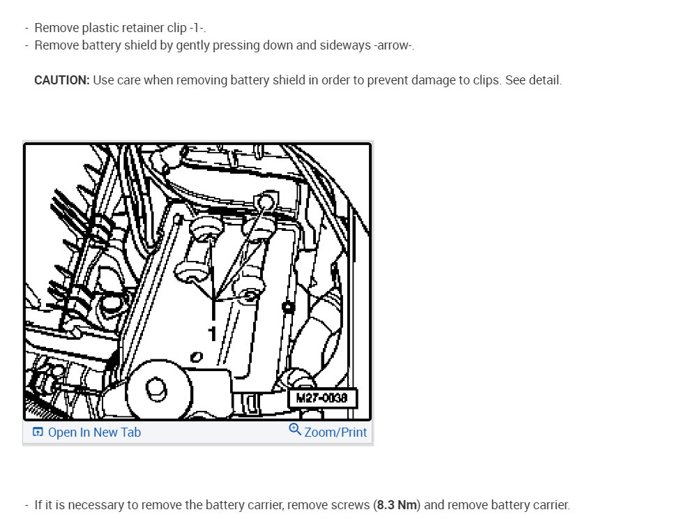

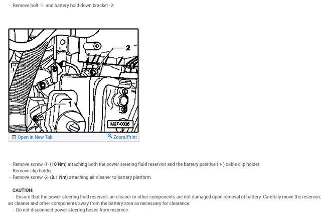

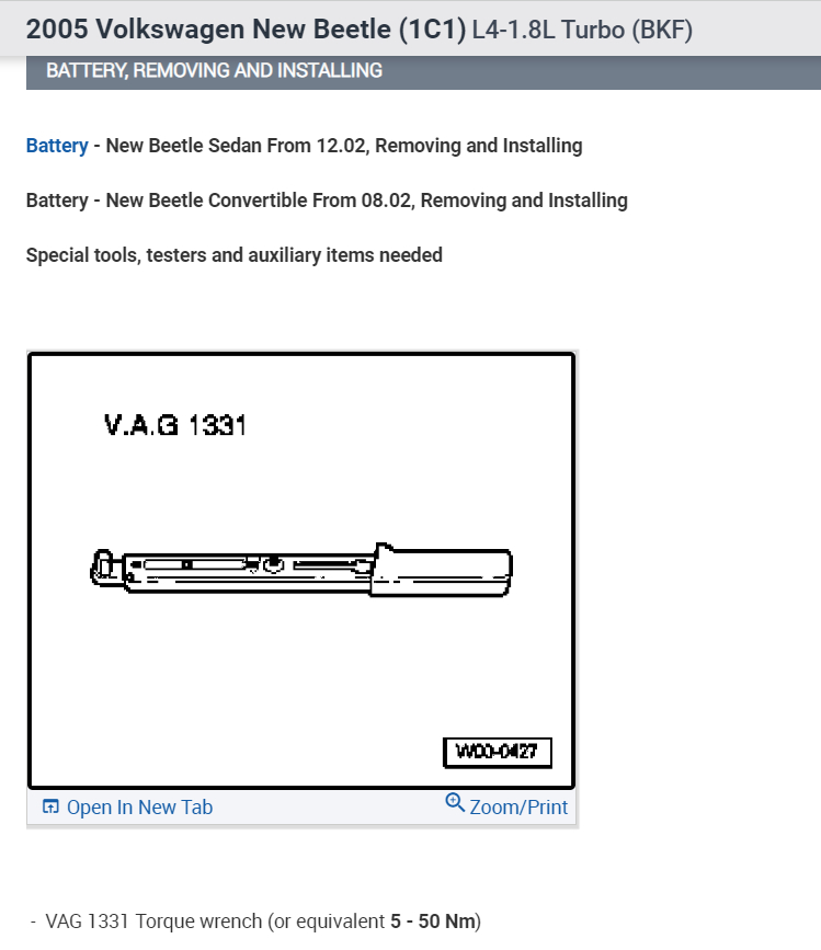

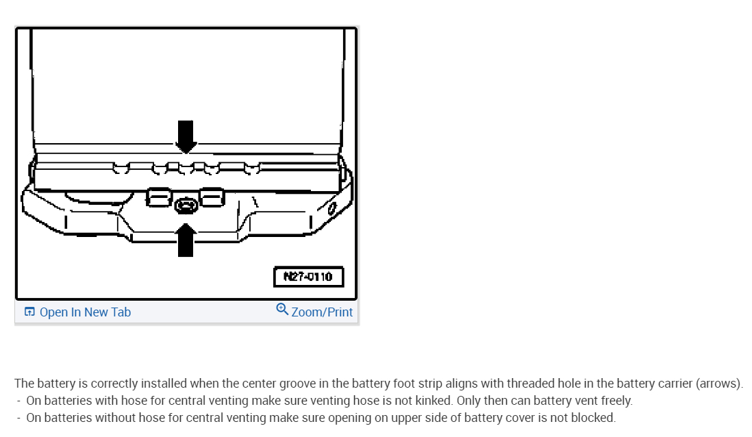

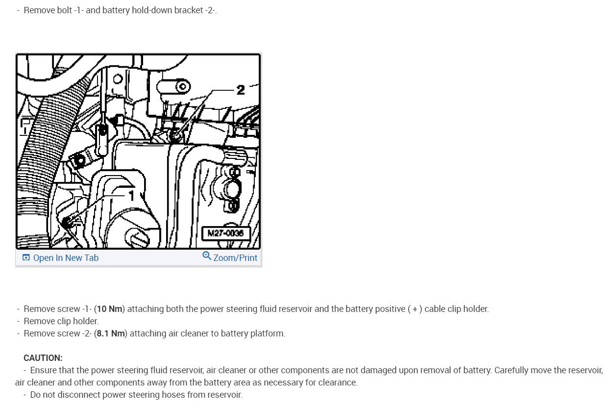

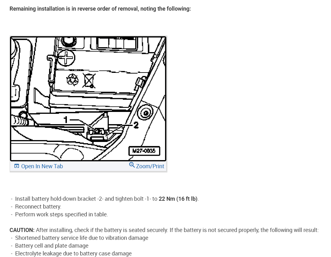

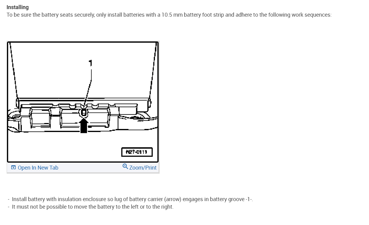

This will be one of two things either the battery shorted out or there is a bad connection at the battery, I would remove the battery and have it tested at an auto parts store and then clean the battery cables. There is an outside chance a main fusible link has blown but I would do the first two steps. Here are two guides that can help with instructions below for your car:
and
https://www.2carpros.com/articles/how-to-replace-a-car-battery
