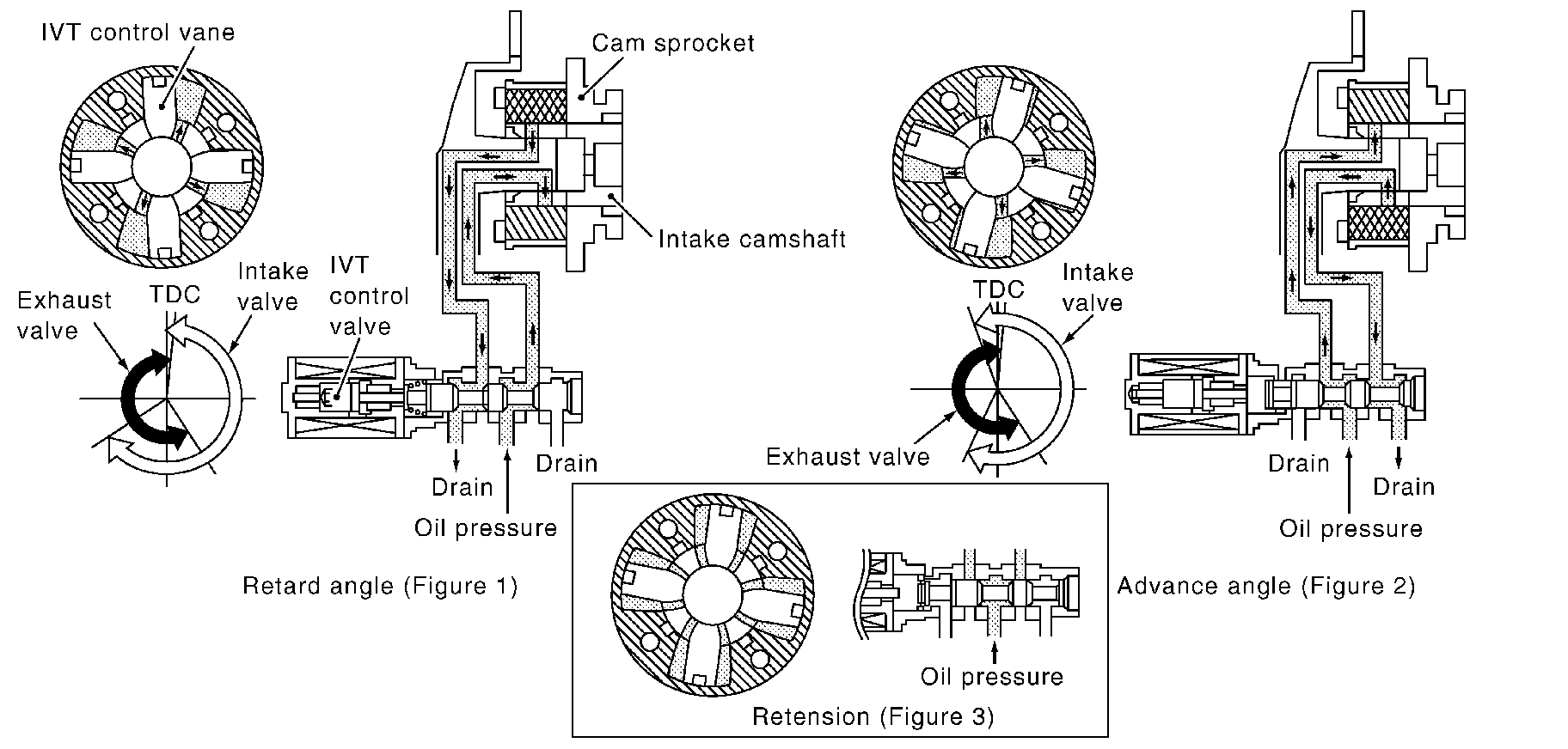

Oh did you mean you wanted the diagram for the control valves? they're also included in this illustration too its a diagram for the Canada USA model so you can see what they look like .Just click down below.
Image (Click to enlarge)

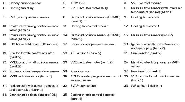

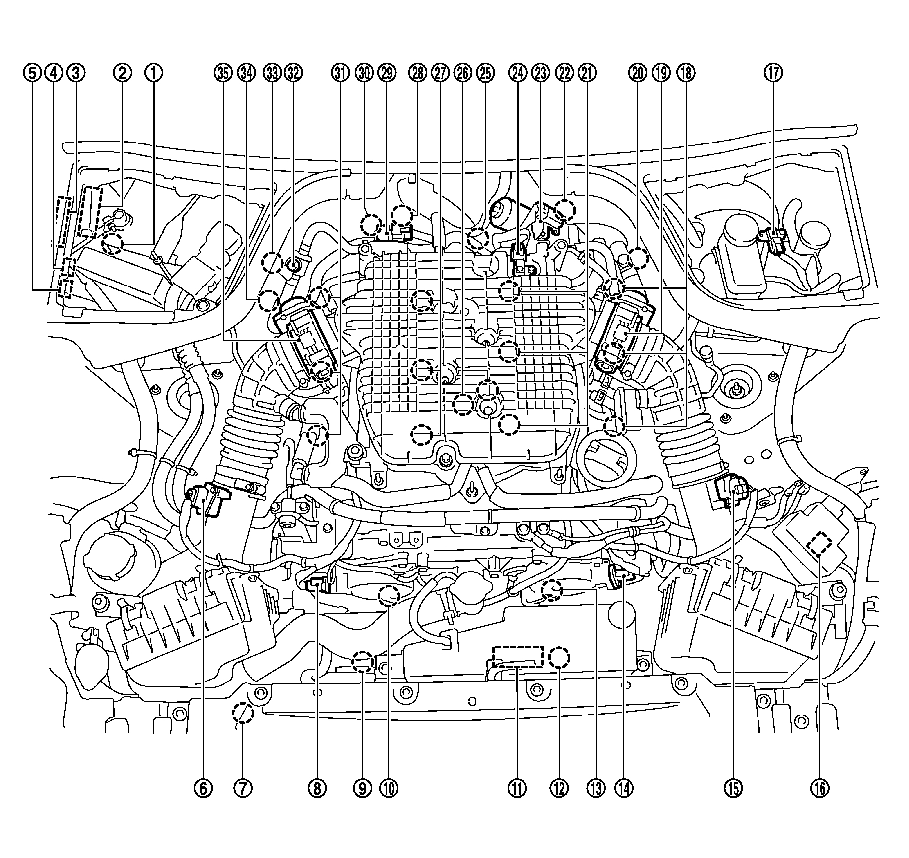

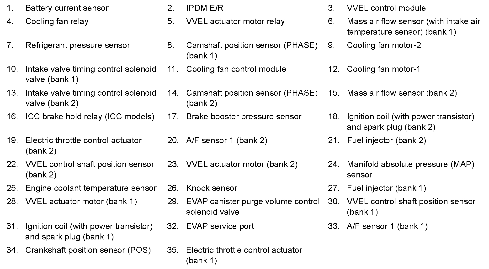

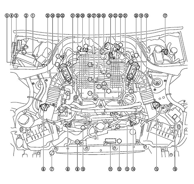

it says there's 2 solenoids.
Estimated labor time 30 minutes for both.. here are two diagrams for you one is numbered and the other is the parts list for that number it will show your valve control components numbers 10 and 13 i believe ..please click the diagrams down below.
