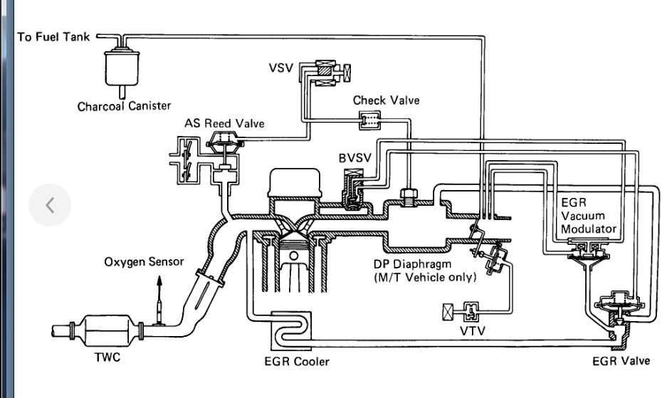

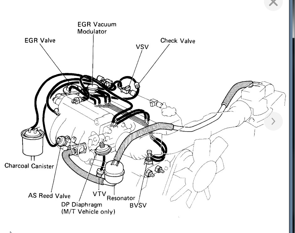

Need to know diagram for VTV line.

Hopefully this gives you what you need because it is the only diagram we have. Let us know and we can go from there. Check out the diagrams (Below). Please let us know if you need anything else to get the problem fixed.
