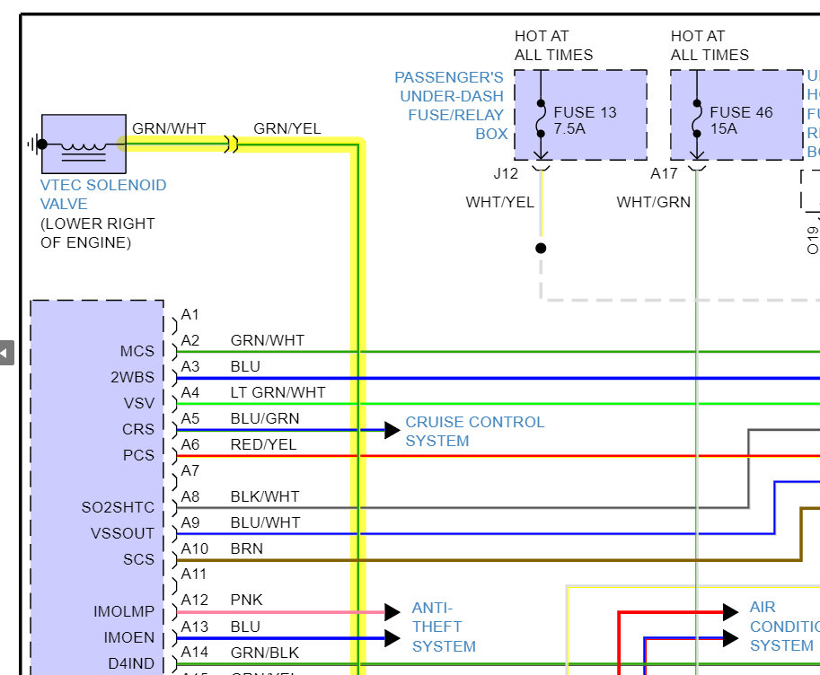

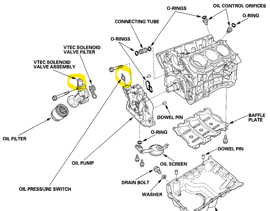

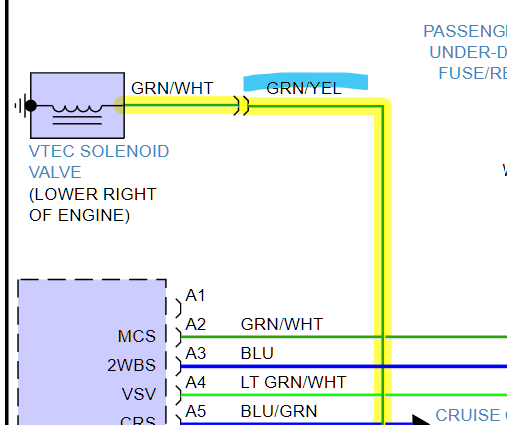

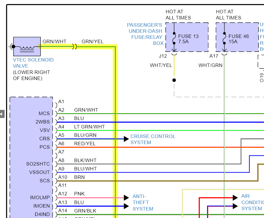

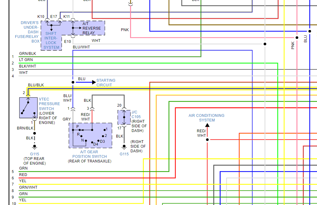

Below is a diagram of the Vtec solenoid wire.

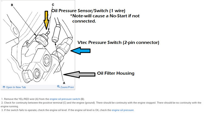

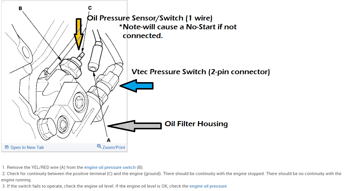

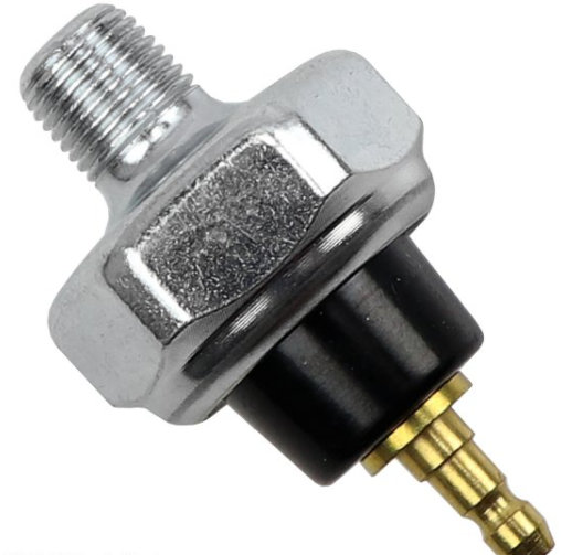

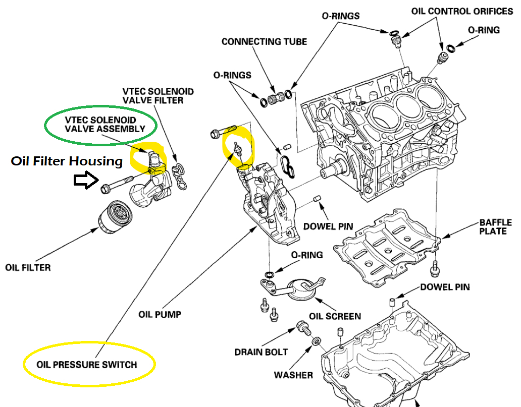

Okay, they are showing blue/black wire colors for the vtec pressure switch. Below is a block diagram of the engine, so it looks like you either pulled the vtec solenoid wire out or the oil pressure sensor, but I don't think that the vtec solenoid would cause a no start. But the oil pressure sensor would, Without an oil pressure signal the engine won't start.

Well, with the wire being near the oil filter, it has to be one of those two, so you'll need to get a new pigtail for the sensor or the vtec solenoid and repair the connector. You should use heat shrink wire connectors. You can crimp the new connector on the wire, then use a heat source to lightly heat the rubber heat shrink and it will seal out any moisture from getting into the connection. These are the ones I use. Sometimes I just heat it with a lighter and it will shrink right around the wire.

The green/white wire that has a connector, then it turns into a green wire with a yellow stripe on it is the VTEC solenoid and is attached to the oil filter housing that you took off. Go by the wire colors. And remember that they have a solid color with a stripe down the wire. Thats how they're colored. The oil pressure switch is a yellow wire with a red stripe. It will be in the same area, but it is not attached to the actual oil filter housing.

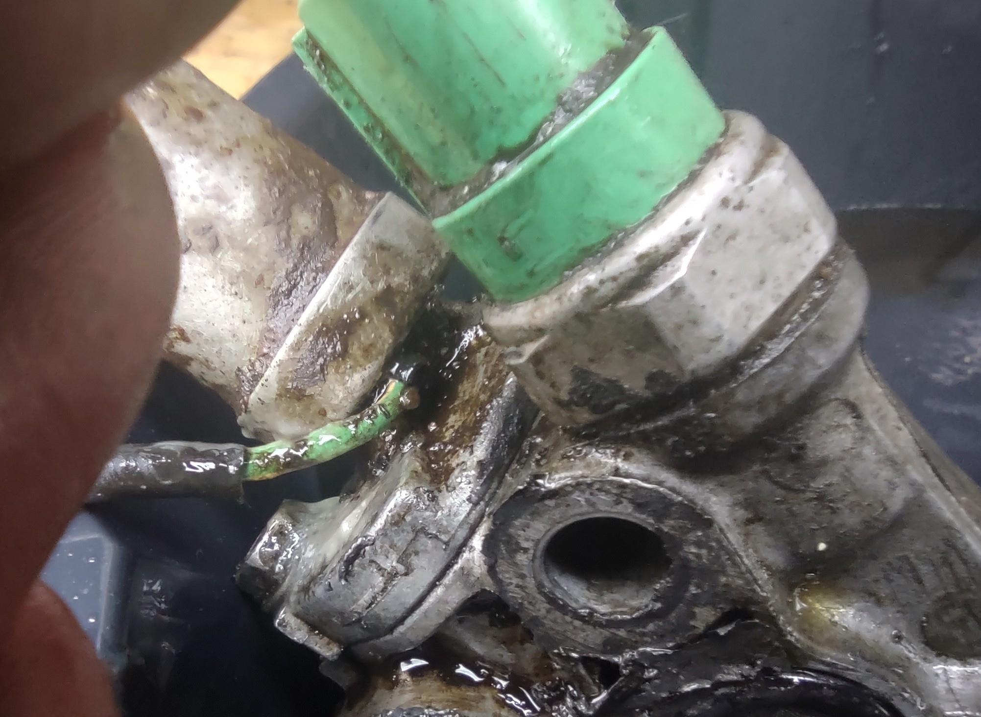

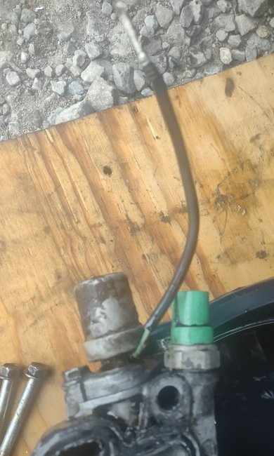

Okay, here are a couple pics.
Apr 5, 2022 at 9:57 PM
AL514
  • 5,464 POSTS
Okay see the green wire with a yellow stripe, that's the Vtec solenoid wire, did you try to start the car with that wire hanging there? And does the check engine light come on while cranking? It should last for about 2 seconds.
And to fix that you are going to have to get a new Vtec solenoid connector, they call them a pigtail, because it will come with the connector and a piece of wire harness that comes with it to repair the circuit. I don't think you'll just be able to stuff it back into the connector.

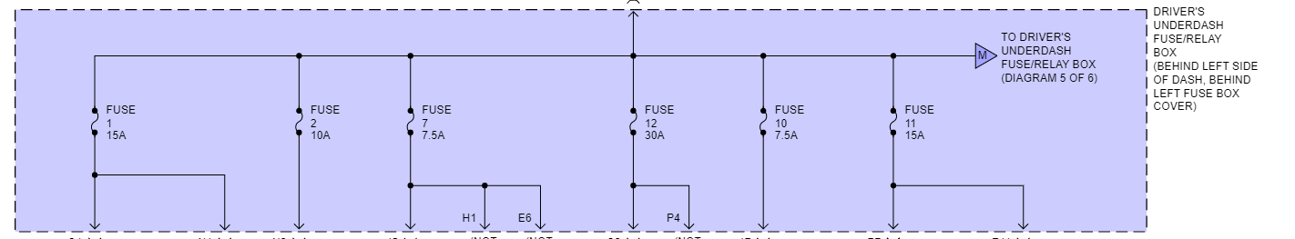

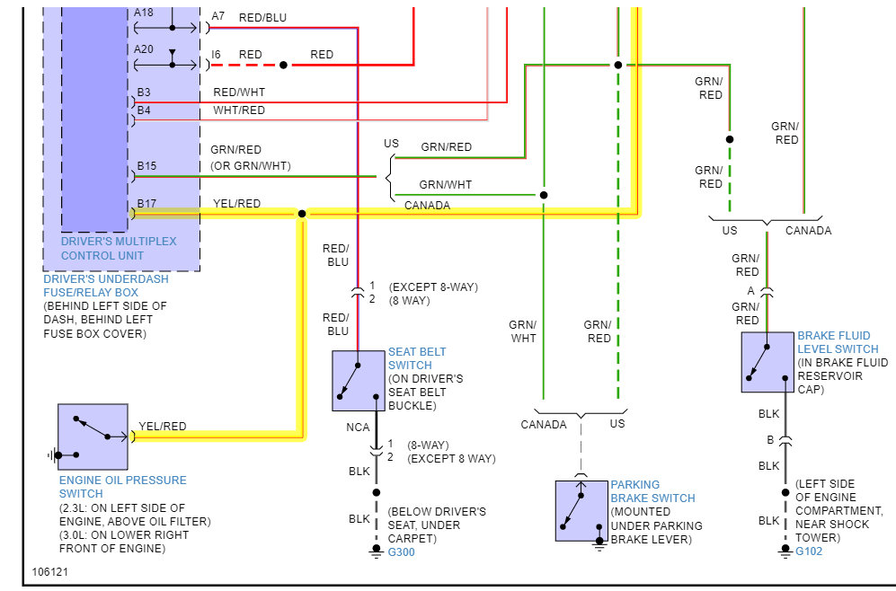

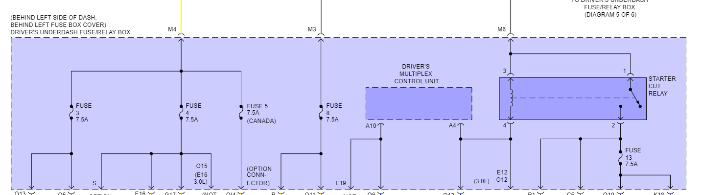

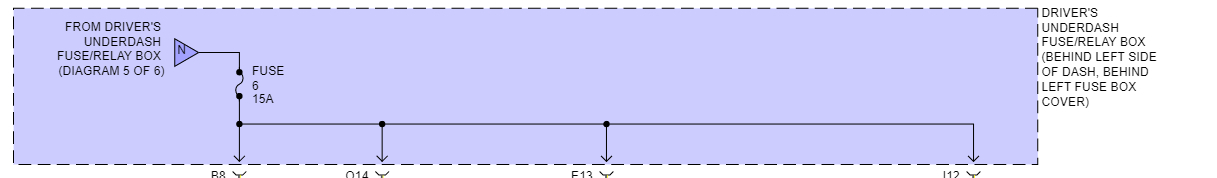

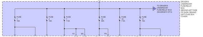

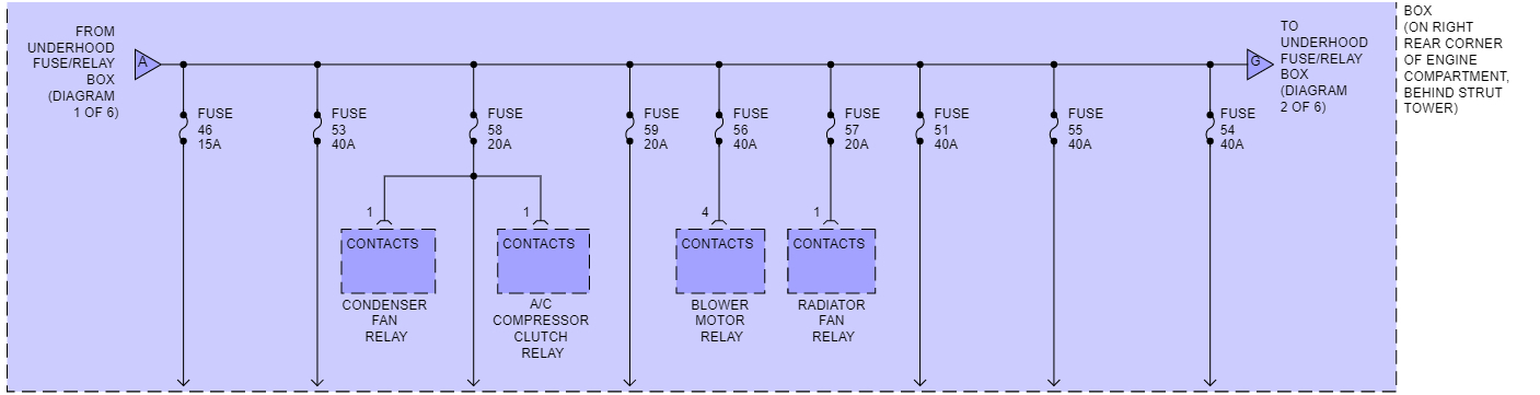

But you should go through all your fuses and see of there's one that is preventing the ECM from being powered up. Below I'll put the fuses that power up critical system components.

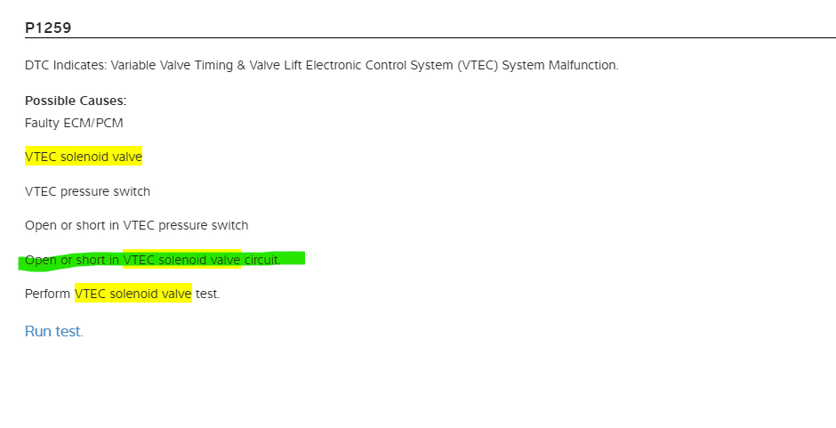

There might actually be code stored for a shorted Vtec control solenoid, and it can cause the no start. (Last diagram)

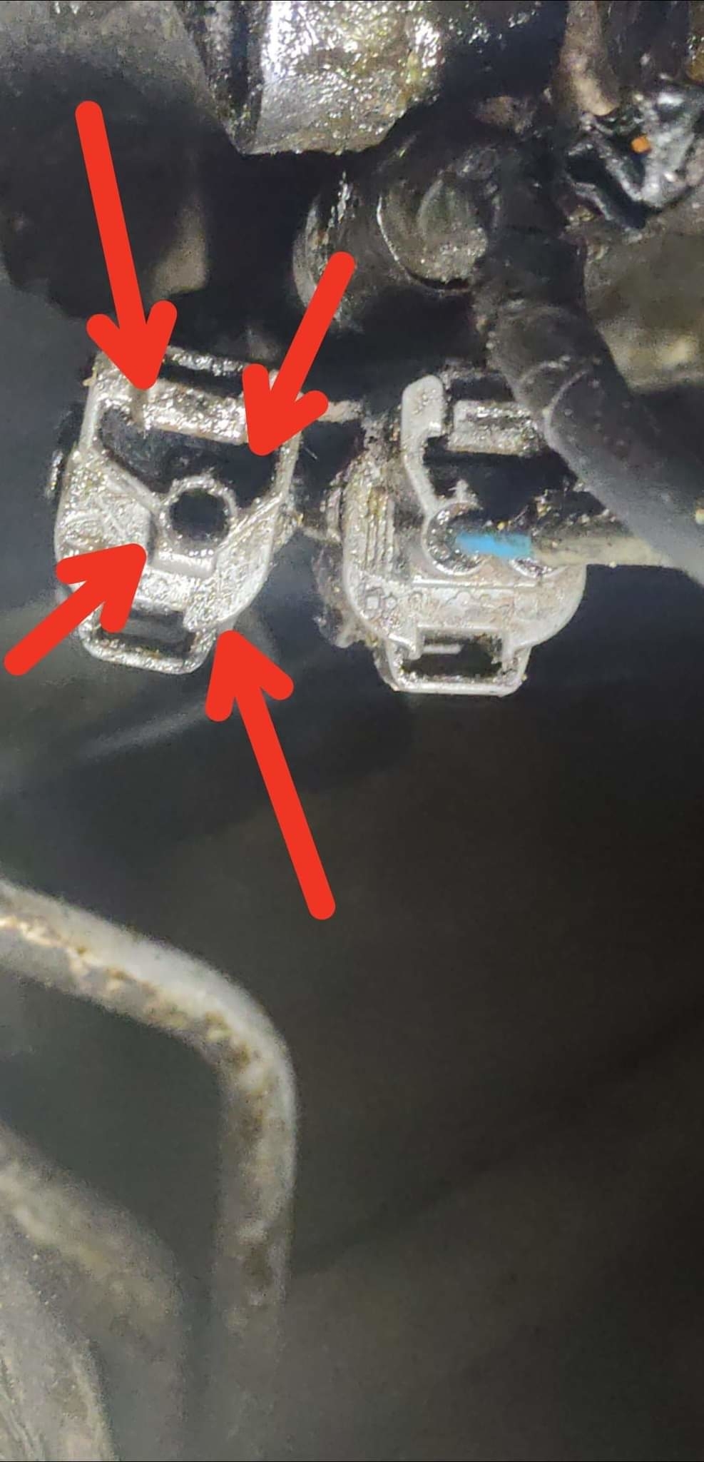

And looking back at your pictures, I see that broken wire, that's for the Vtec solenoid but the green connector, are you missing two connections there., that looks like you're missing either the oil pressure switch or Vtev pressure switch that would plug into the green plastic connector there. Or is the plug for the green connector still hanging from the lower part of the engine where the oil filter housing goes?

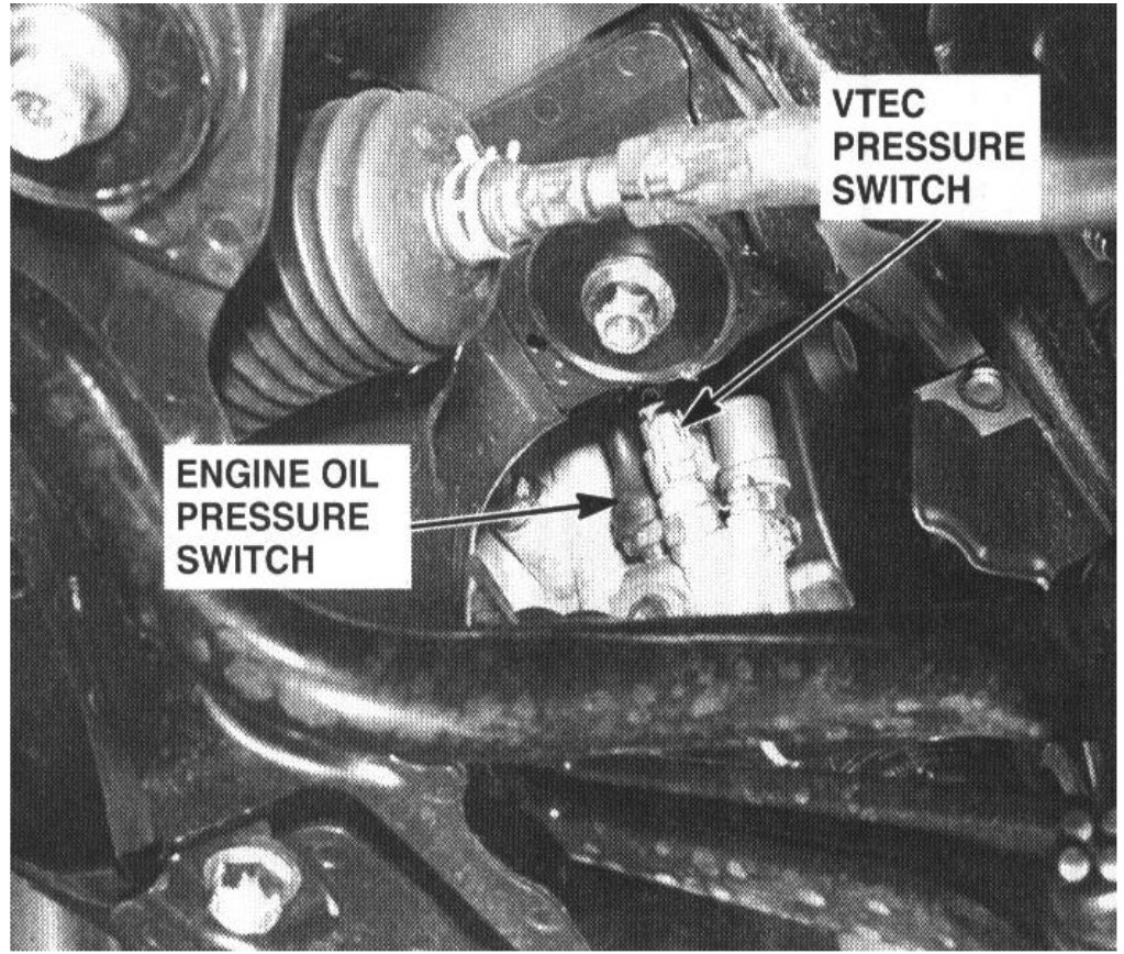

Does this look like your oil filter housing? The Grey plug is the Vtec Solenoid, from the wiring diagrams, that green plug with the two pins inside is the Vtec Pressure Switch and very close to it is also the Oil Pressure Sensor, which is a 1 wire plug also, the wire for the Oil Pressure Switch is yellow with a red stripe. It will have a rubber plug over the connector. This will definitely cause a no start. Fourth picture is the oil pressure switch.

The pictures I sent earlier is what my oil filter housing looks like I believe also I have the green connector that attaches to the housing, but whatever connector that lone wire is supposed to attach to I believe located on the back of the motor is still connected as far as I know the wire just came out of it if that makes any sense.

Okay, I'm assuming the lone wire you are talking about is the one on the filter housing that is facing up and coming out of that cap looking top? Thats the Vtec solenoid control wire. The reason it has that metal pin on the end on it, is because it goes into a connector and changes colors. At the Vtec solenoid it is Green with a White stripe, then at the connector it changes to green with a yellow stripe. So, you need to find the end of that connector, it must still be hanging there. It looks exactly like the pin pulled out of the connector.
And that connector might be fastened to the engine block. That may be why it's hard to see. On the diagrams I have there is no connector number. But I believe the connector is a grey color and is a square connector.

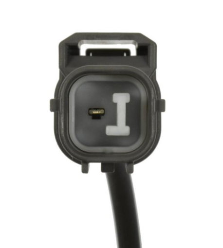

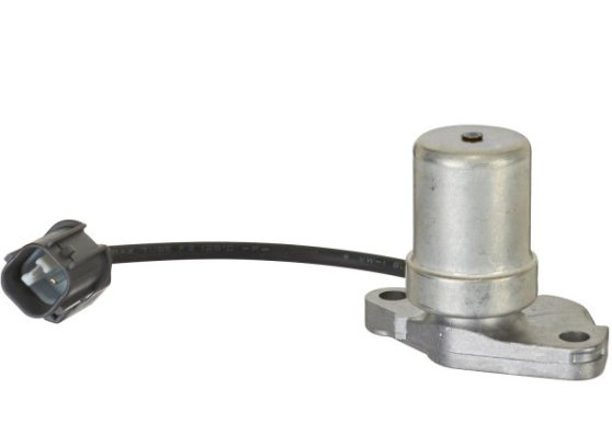

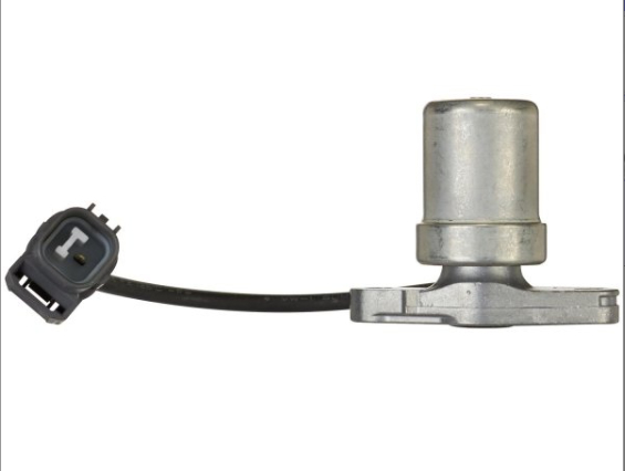

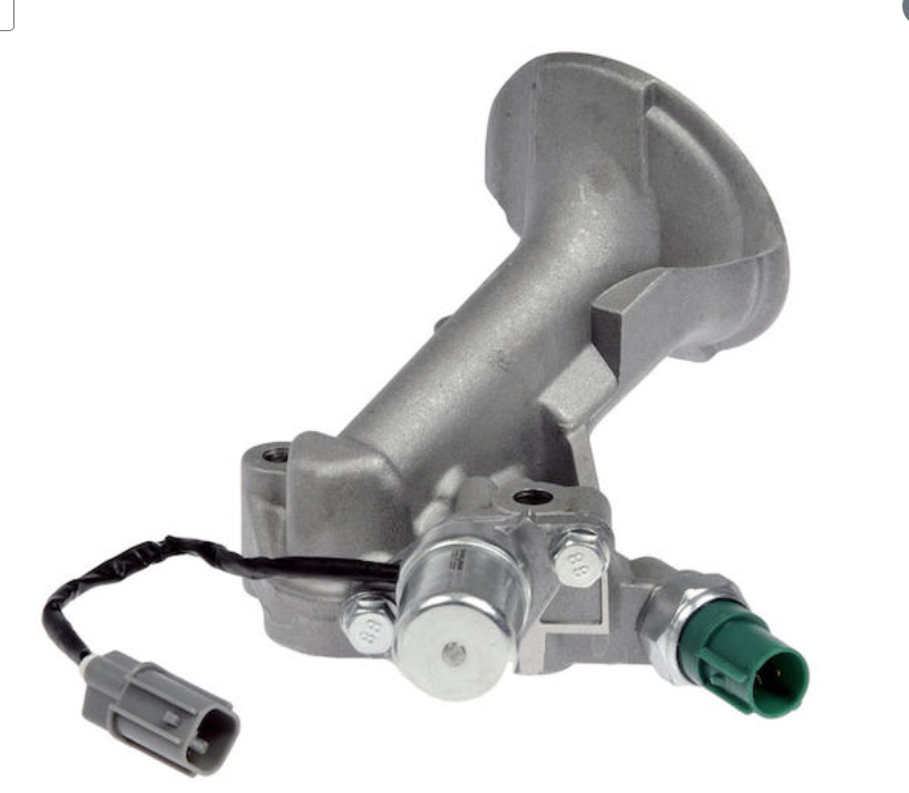

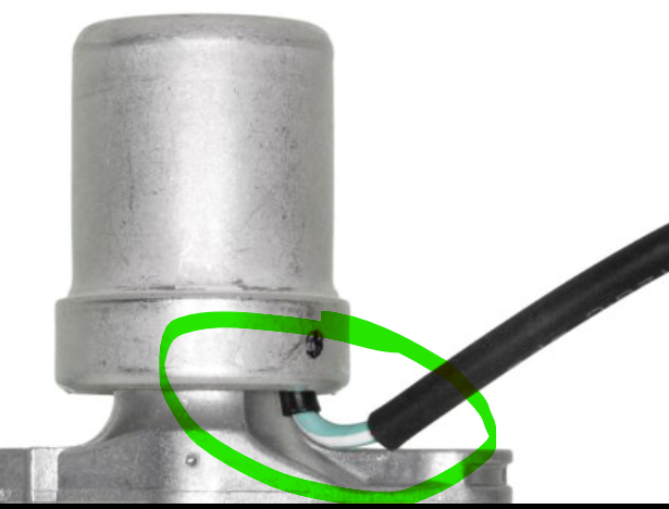

This is a new Vtec solenoid from rockauto. It's the 2-bolt solenoid for the V6 3.0L 98' Accord. In the fourth picture you can see the green/white wire, so after that grey connector it will change to green/yellow wire.
You're going to find that the broken connector is probably still stuck in the other end. If the other harness side connector is okay, it will be easier to just replace the Vtec solenoid. Also replace the screens if you're going to take off the oil filter housing again.

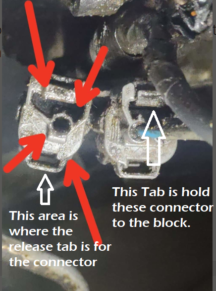

I found it. Also, why is this connector so hard to remove does it come out differently than other connectors or am I just doing it wrong? lol
Apr 7, 2022 at 8:51 PM
AL514
  • 5,464 POSTS
That's the female end of the connector and it is mounted to the engine; the bottom section is the part that actually comes out. If you put a real small flathead screwdriver in there you should be able to pull the tab up and slide the connector out from beneath.
