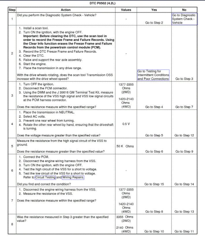

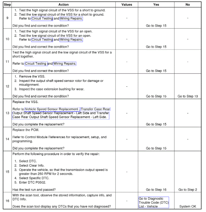

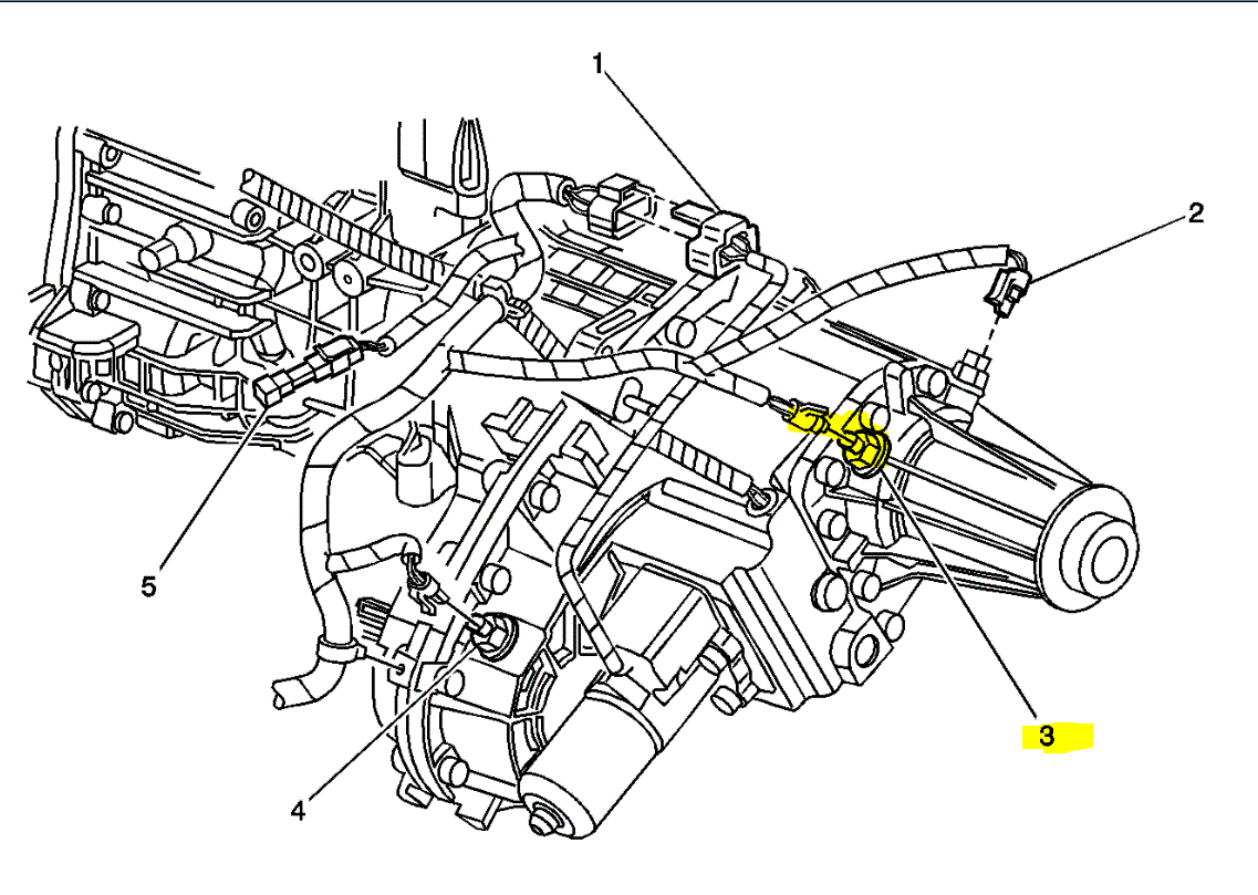

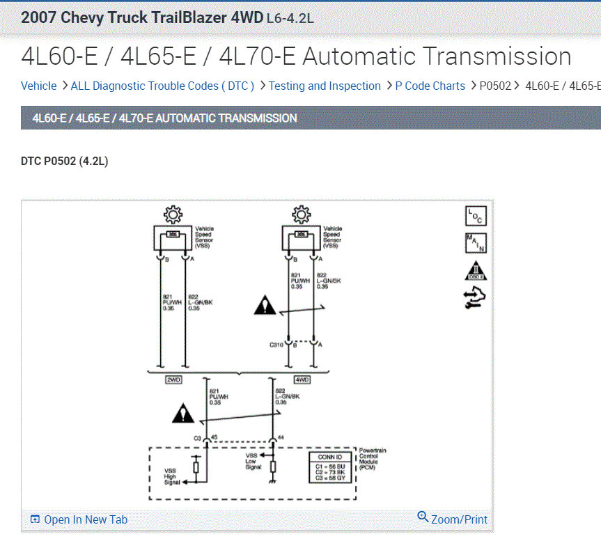

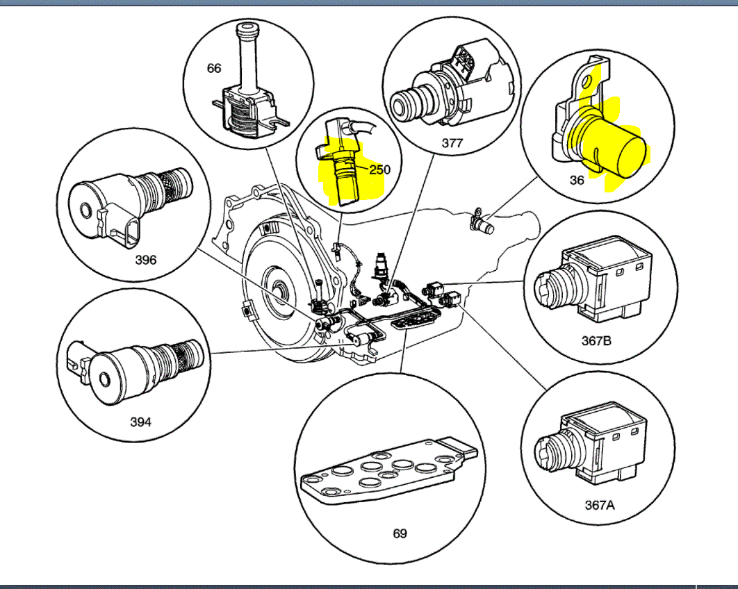

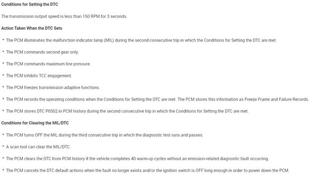

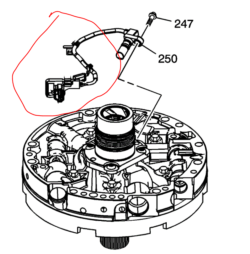

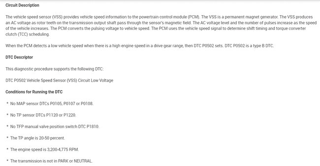

Can you please tell me where the vehicle speed sensor location is? I've replaced the 2 in the tail shaft of the transmission that thread into the location but apparently there's a 3rd that has a bolted hook connected to it but i cannot seem to find it. Also, i have replaced the 2 front ABS wheel sensors and no change. My vehicle will not shift at proper times and the speedometer will not work at all. I've searched numerous times but cannot find any information on it. Also, i have seen the posts online and all the pictures on here and they only point to the 2 sensors i have already changed.
