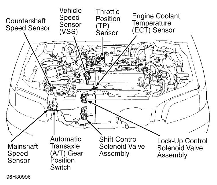

I have the code P0501. Will this code cause the transmission to act up and not shift properly? Will this code cause the speedometer to not work?
Jul 23, 2016 at 3:04 PM
HMAC300
CERTIFIED EXPERT
48,601 POSTS
it will do both if it is not working properly , keep in mind it may not be the VSS and could be a short in wiring as well.

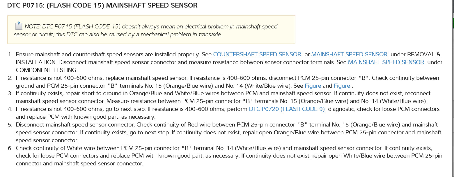

I replaced the VSS it drove for a little while with out issue. Now the code P0715 is showing. What are my next steps to rule out mechanical issues.
Jul 24, 2016 at 5:21 PM
HMAC300
CERTIFIED EXPERT
48,601 POSTS
that is main shaft speed sensor check resistance per instructions sent, but i would bet it is a mechanical issue inside transmission.
Jul 25, 2016 at 6:45 AM
BCMULLEN95
MEMBER
249 POSTS
Replace the main shaft speed sensor and it is drivable for now. I will be getting it rebuilt soon. Thanks for your help.
