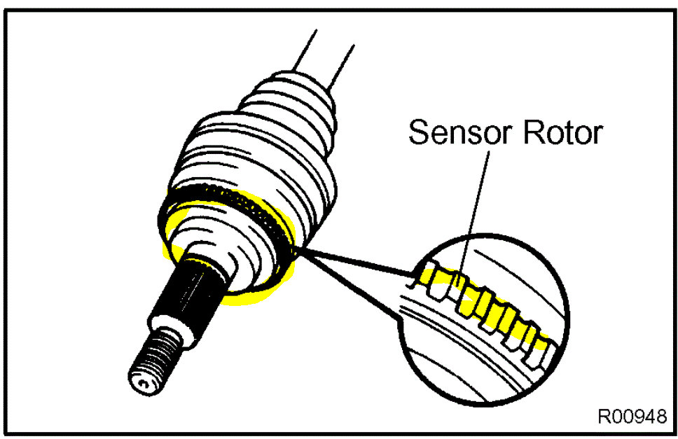

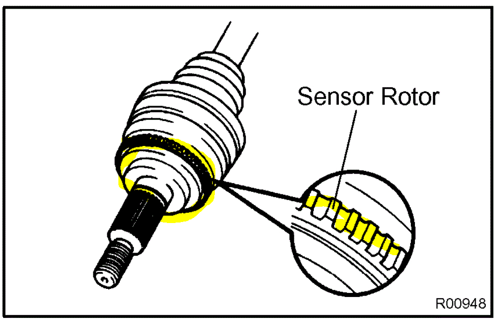

The VSC light is related to stability control. Chances are one of the wheel speed sensors is bad. I don't feel it is related to the P0430.

As far as the VSC, we have two options. First, have the can-bus system scanned to determine if there is a code related to the VSC or a wheel speed sensor. CAN stands for controller area network. Basically, all modules/computers are tied together via a few wires. This type of scan should identify stored codes in any of the modules. Here is a link that shows how it's done:
https://youtu.be/InIlnsjOVFA
Next, if you can't have that done, you can check each wheel speed sensor using a multimeter or voltmeter. Here is a link that shows how to do it:
https://www.2carpros.com/articles/abs-wheel-speed-sensor-test
