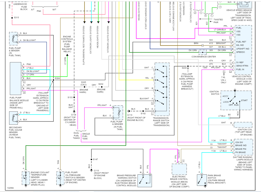

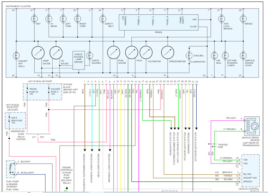

The only problem is that my gauges on the cluster are all wrong except my voltage gauge.
When I turn the key oil pressure pings to the right, when I moved the shifter the fuel gauge moves.
When headlights are turned on, the dash lights turn off.
When running the speedometer needle moves.
And tachometer only moves a little bit but is not in sync with the RPMs of the motor.
I have swapped the cluster but no change, also noticed that the wiring behind the cluster are the exact same for both vehicles.
I think I need to rewire some at the bulkhead Connection but I’m not sure as I cannot find schematics for either vehicle.
