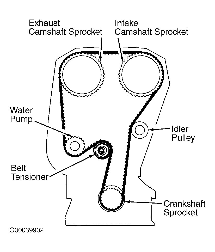

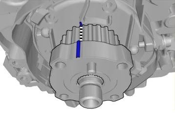

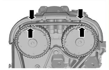

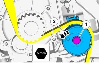

I attached a picture of the timing belt and marks. Confirm it was installed correctly.

I did a compression test my cylinders have no compression, but when I poured oil into the cylinders my compression got higher and my timing is out on the intake cam with one tooth. Could this cause the reason for low compression or could it be that it is because of my piston rings? As of I only oiled the cylinder walls and the piston rings where dry. Should I replace my piston rings and oil the before putting them back?
Jul 13, 2018 at 10:44 AM (Merged)
I would fix the intake camshaft timing first. Here is a diagram of how the marks should be:
https://www.2carpros.com/diagrams/volvo/v40/2004
Please run down this guide and report back
Jul 13, 2018 at 5:48 PM
