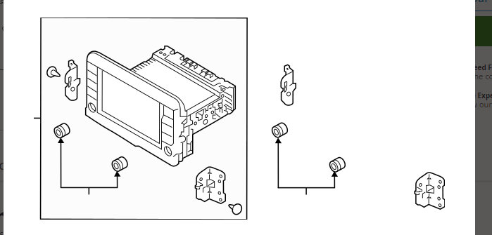

Hi, I have the vehicle listed above S model and every time I turn the volume up it automatically turns down.

There are a couple things that come to mind, but the determining factor will be how far it turns down.
When you turn the volume up, does it turn down all the way to 0 or no sound?
If this is the case, I think the volume knob is the issue. A lot of times it gets dirt and grim in it and makes the radio turn down.
The only solution that I am aware of is to replace the radio.
However, if when you turn it down, and it jumps down a couple notches then that could be a software issue in the radio.
Can you get a video of what this is doing?
It appears you are able to remove the knobs so depending on what this is doing, we can remove the knob and try and clean it.
Let's start with the video and go from there. Thanks
