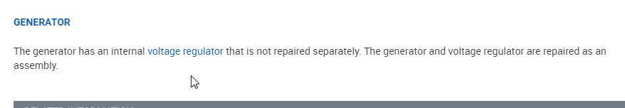

The diagnostic computer read bad voltage regulator. Where is it located on the vehicle?
Sep 5, 2020 at 12:40 AM
I attached the information about this. It is part of the generator and cannot be serviced separate. So you need to replace the assembly if this is an issue.
Let us know what other questions you have. Thanks
