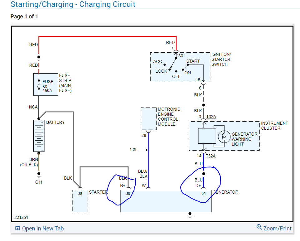

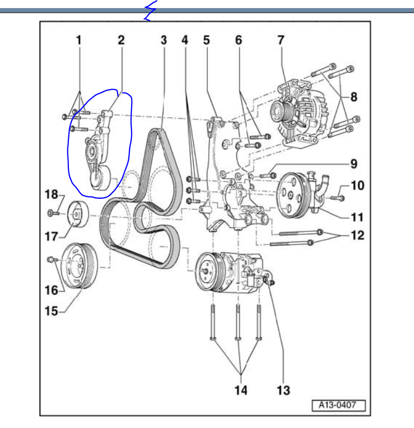

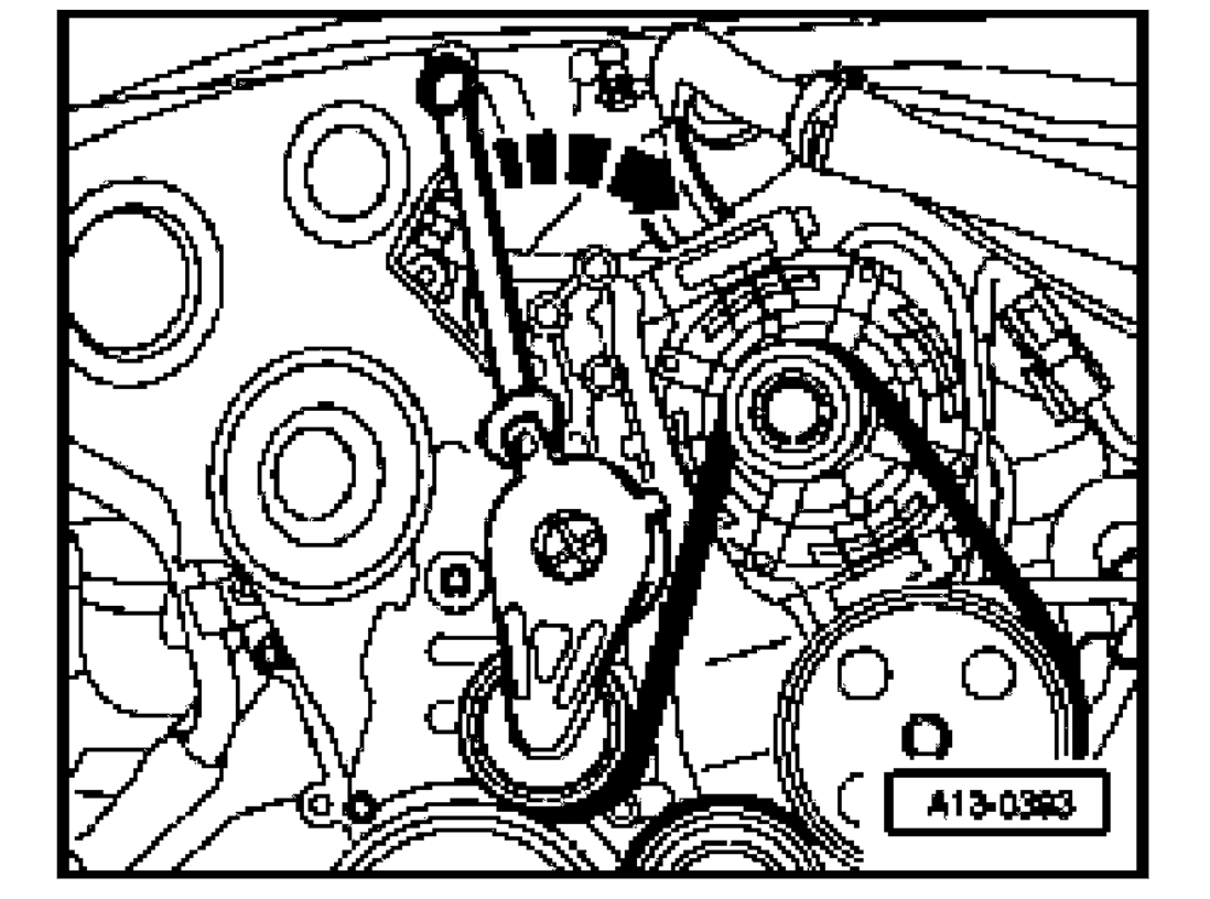

Just to add, this could be the belt slipping. Your voltage is low but rises at times. I attached the diagram of the belt and the tensioner for the system. If it is loose, the charge rate will be low.
https://www.2carpros.com/articles/serpentine-belt-tensioner-replacement
I attached a diagram as well for you of the charging system. Your voltage should be 14 to 14.5 volts running.
