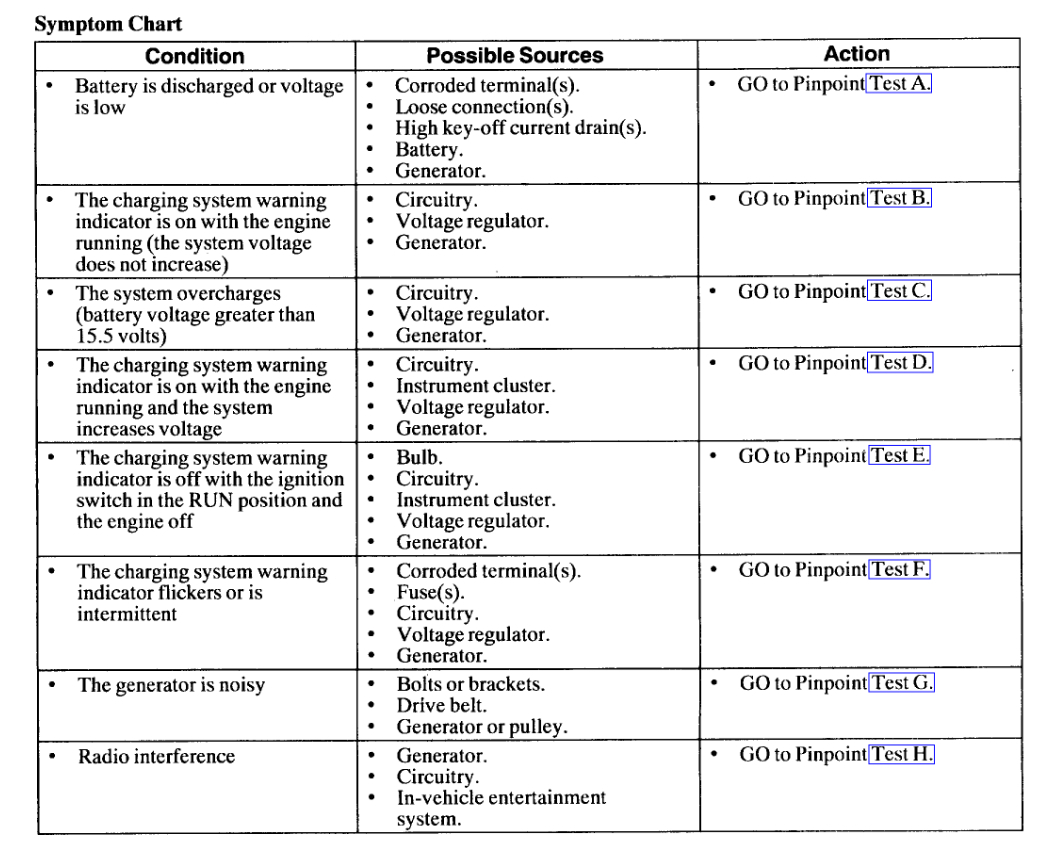

I have checked the battery and alternator, which came out good. I changed the alternator and it was doing the same thing. I was told that it could be the alternator connection pug in which I checked it with a test light an meter an it was good. Now I don’t know what to check next.
