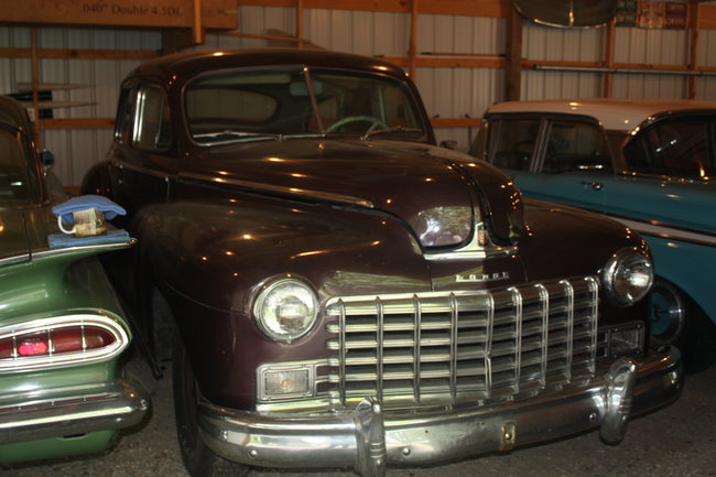

At this point my problem is unknown. I was reading a thread between a fellow named CJ MEDEVAC and another fellow and was completely mesmerized. I purchased a 1948 Dodge Sedan three years ago. I tried starting it, but with dismal results so I gave up on it since I have eleven other automobiles five of which are classics and they take up most of my time. That said, I really would like to get the old 48 running. First problem is: How do I know if it is 12 or 6 volt and is it positive or negative ground? The car is completely original. I really want to talk to CJ MEDEVAC on this as he seems extremely wise. I am a mechanic of forty plus years but admit I learn something new every day thus am not to proud to be taught.

it's 6 volt and positive ground. I checked in my old motors manual

Thank you so very kindly HMAC300, I have to admit I feel really stupid! I have been working on old cars since I was around fifteen and I am fifty six now,, how could I not have heard about positive ground? The past three years I have had two back surgeries, both of which have left me a hundred times worse off than I was originally. I can no longer work a job, I need a cane to walk with, and the doctor says a wheelchair is in my immediate future. I tell you this so you and all others understand why it will take weeks to months before I can test any information given to me by wise folks like you. I will find the strength to test this Positive ground within the next week. The last time I tinkered with the old girl was over two years ago and at that time I began preparations to pull the engine. Thus I have a lot of parts to reinstall before she is going to run again. But I have a new found purpose to resurrect her because of you. I will be in touch again to let you know what happened. Again I thank you so very kindly. Warmest regards, Jeff PS: Is it against the rules on this forum to post my telephone number?

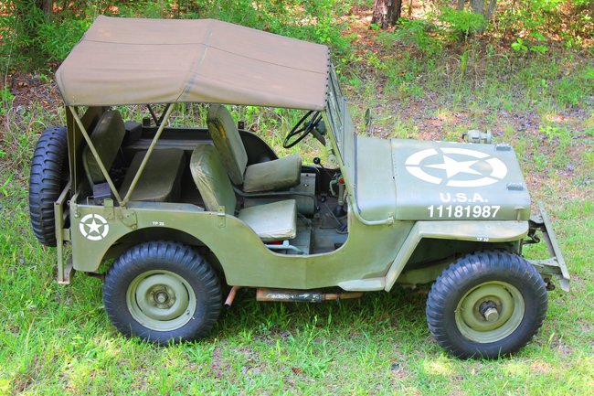

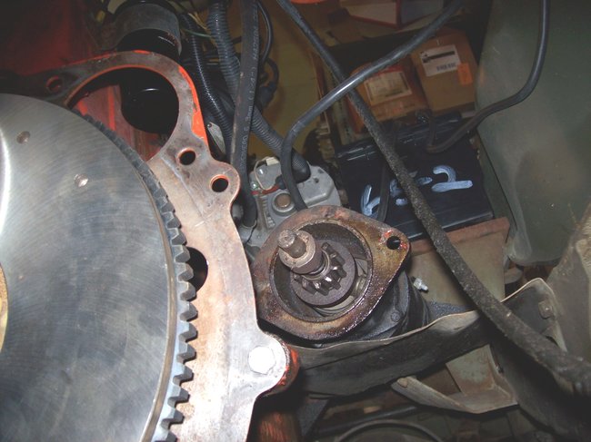

HERE'S SOMETHING TO PONDER
I HAVE BEEN LOOKING FOR YOUR STARTER EBAY/ ONLINE/ ONLINE PARTS STORES
I WANTED TO SEE IF IT LOOKED AND WORKED SIMILAR TO "WILLY'S" STARTER (MY '46 WILLYS JEEP)
HERE'S THE CATCH, HAS SOMEONE MODIFIED IT FROM 6 TO 12 AND IS IT STILL POS GROUND (IF IT EVER REALLY WAS)?
MY JEEP 6 VOLT STARTER SPUN MEGA FAST WHEN A 12 VOLT BATTERY WAS HOOKED TO IT. ("THEY" SAID IT WOULD BE OKAY!) WELL IT WUDDN'T, IT SPUN FAST AND THE STARTER DRIVE SLUNG OUT SO HARD THAT FORCE WOULD BUST THE END OFF OF THE STARTER DRIVE AFTER MAYBE EVERY 100 CRANKINGS. AFTER TALKING TO A "STARTER GUY", HE SAID I COULD CHANGE THE FIELDS TO 12 VOLT FIELDS AND THE STARTER WOULD SLOW BACK DOWN (ON 12 VOLTS) TO ABOUT THE SAME RPMs AS IT WAS ORIGINALLY ON 6 VOLTS.
THE FOLLOWING IS PASTED FROM A 2011 POST I ANSWERED
MY STARTER (SHAFT) WILL TURN BACKWARDS--HOWEVER THE STARTER DRIVE WILL NOT KICK FORWARD. IT WORKS WITH AN ECCENTRIC WEIGHT, AND A ACME SCREW, AND TURNING BACKWARDS ACTUALLY SCREWS IT "INWARD" AWAY FROM THE FLYWHEEL!
IT GOES ZZZZZZZZZZZZZZZZZZZZZZZZZZZZZZZZZZZZ! (WHEN IT SPINS BACKWARDS)
NOT A RUMP A RUMP A RUMP A RUMP!
I FOUND THIS OUT WHEN I INSTALLED MY NEW 12 VOLT FIELDS INTO THE OLD 6 VOLT STARTER HOUSING. HERE'S THE CATCH. INSTALLED MY BRUSHES PLATE A 1/4 TURN, FROM THE CORRECT POSITION (CAUSE I FAILED TO MARK THE HOUSING WHEN I TOOK IT APART)
I TOOK IT ALL BACK APART AND TOOK THE FIELDS BACK TO THE ALTERNATOR SHOP AND PROCLAIMED "I HAVE THE WRONG FIELDS, THEY TURN BACKWARDS",
THEN THEY SORTA GOT ME ON TRACK, AND I HAD TO INSTALL THEM AGAIN, THIS TIME ROTATE MY BRUSHES A 1/4 TURNBACK INTO PLACE
LESSON WELL LEARNED---MARK POSITIONS OF ANY DEVICE WITH A MARKER, CHISEL, ETC. SO THINGS LINE BACK UP LATER!
THE FIELDS WERE ABOUT $12, $60 FOR THEM TO INSTALL 'EM. I CHEAPED OUT AND HAD TO DO IT TWICE AND ENDURE THE EMBARRASSMENT OF DOING IT WRONG AFTER ANNOUNCING MY IGNORANCE!
SO I'M LEADING INTO THIS
WILL YOUR STARTER TURN BACKWARDS, IF THE POLARITY WRONG AT THE BATTERY? WHICH MAY SET YOU ON THE TRACK OF CORRECT POLARITY.

Lastly, is it positive ground? Is it negative ground? I do not know! I asked the question on this forum about a month ago a someone said it was 6 volt positive ground. That is why I asked the question as to: do well really think by me changing the ground from negative to positive that she is going to whip over like it should. Oh and how do I know the starter is original with no changes made? Because there is 68 years of oil and Texas dust and dirt on the bolts. and the dirt is still there. Ok man... the ball is in your court! Take care, regards, Jeff

LOOKS LIKE IF YOU HAD IT BACKWARDS, MR. STARTER WOULD PROBABLY TURN BACKWARDS.
I DID DO A LITTLE LOOKING AT STARTERS (WHICH I THINK IS YOURS)
FROM WHAT I COULD TELL IN THOSE PICS WAS THERE IS AN ARM (SURELY FOOT ACTUATED) (BASICALLY THE POWER SWITCH) TO TURN THE STARTER "ON"
TELL ME IF I'M ON TRACK
THE SAME ARM SIMULTANEOUSLY "LEVERS" THE STARTER DRIVE INTO THE FLYWHEEL TEETH??? WHEN YOU LET UP WITH YOUR FOOT, POWER DIES AND THE STARTER DRIVE RETRACTS BACK INTO THE STARTER
DOES THE STARTER DRIVE HAVE A RATCHET ACTION ONCE THE CAR CRANKS AND YOU DIDN'T SNATCH YOUR FOOT UP FAST ENOUGH?
AGAIN I'M ASKING/ HYPOTHESIZING THIS THAT IF IT WERE HOOKED UP WRONG
A) A RATCHETING STARTER DRIVE MIGHT ZZZZZZZZZZ OR RATCHET IF THE POLARITY WERE WRONG (NO CRANKY THE ENGINE)
B) IF IT WERE A "DIRECT DRIVE" OR FIXED TO THE ARMATURE STARTER DRIVE/ GEAR IT WOULD TURN THE ENGINE FORWARD OR BACKWARDS AS LONG AS YOU HELD THAT ARM DOWN.
NEVER THE LESS, IF YOUR FAN IS TURNING THE RIGHT WAY WHILE IT'S A CRANKIN', HOWEVER YOU'VE GOT IT HOOKED UP, THAT'S THE WAY YOU NEED TO KEEP IT!!!
