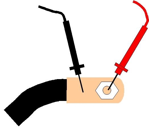

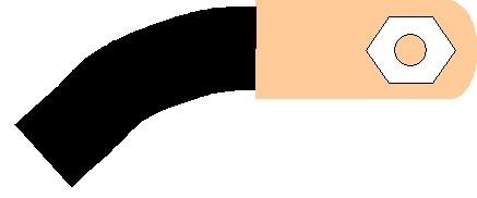

Now open up the nozzle and try to get water to flow. This is when you will still find full pressure on one side of your foot, but almost no pressure on the other side. There is a huge drop in pressure because excessive resistance is blocking current flow. Voltage is electrical pressure, and it is that drop in voltage we can measure when resistance is too low to measure. The first drawing is of a terminal connected to a stud. This could be at the starter, the generator, a battery cable, or the fuse in your circuit. The second drawing includes the meter's probes where you might try to measure resistance. Instead, this is where you need to take a voltage reading, but just like with the garden hose, this voltage drop, (pressure drop), only shows up when current is trying to flow. That means a helper has to try to crank the engine while you take the readings, or, in the case of charging systems, the engine has to be running.
This connection between the terminal and the stud is considered to be a mechanical connection, and as such, the maximum you are allowed is 0.2 volts. The most you are allowed in any one circuit is 0.4 volts. In your charging circuit, you have a mechanical connection between the generator's output stud and that terminal, one bolt for the fuse, the second bolt for that fuse, and the positive cable clamp where it bolts to the battery's post. Every one of those four connections can have no more than 0.2 volts drop, and all four of those readings added together cannot be more than 0.4 volts.
