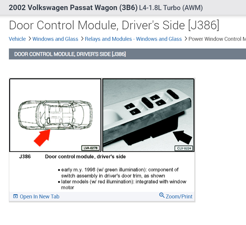

If you don't use the trailer light connector, I would follow it and remove and repair the wiring as needed. These cars have a problem with the drivers door module getting wet, or damaged due to many door closes. I would unplug the DDM and see if the fuses blow, here is the location. Check out the diagrams (below). Please let us know what happens.
