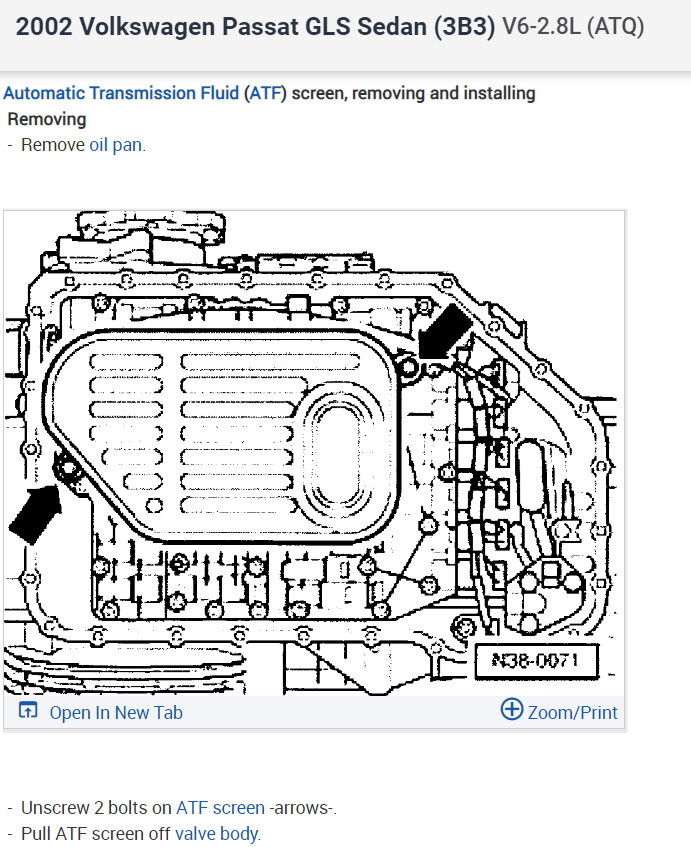

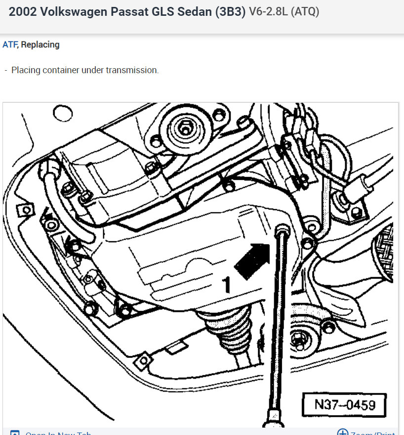

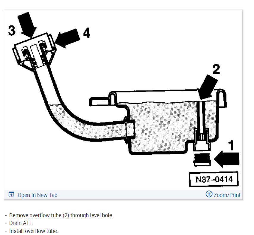

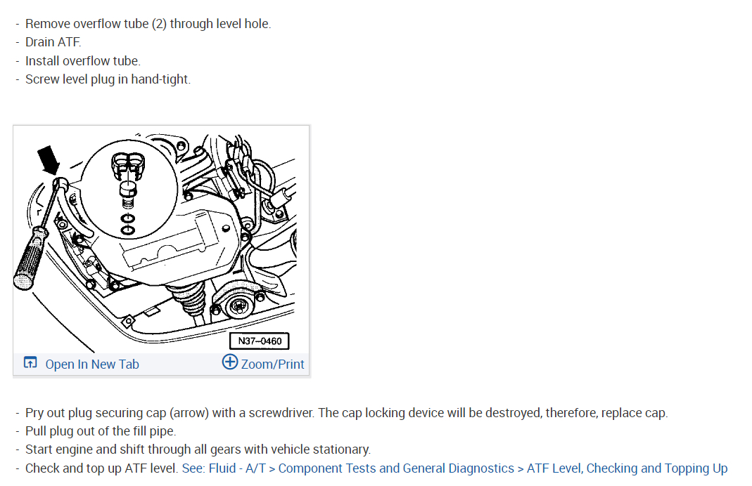

Yep, the more you service the transmission the longer it will last. Here is a guide that can help and I have included how to service your transmission i the images below.
