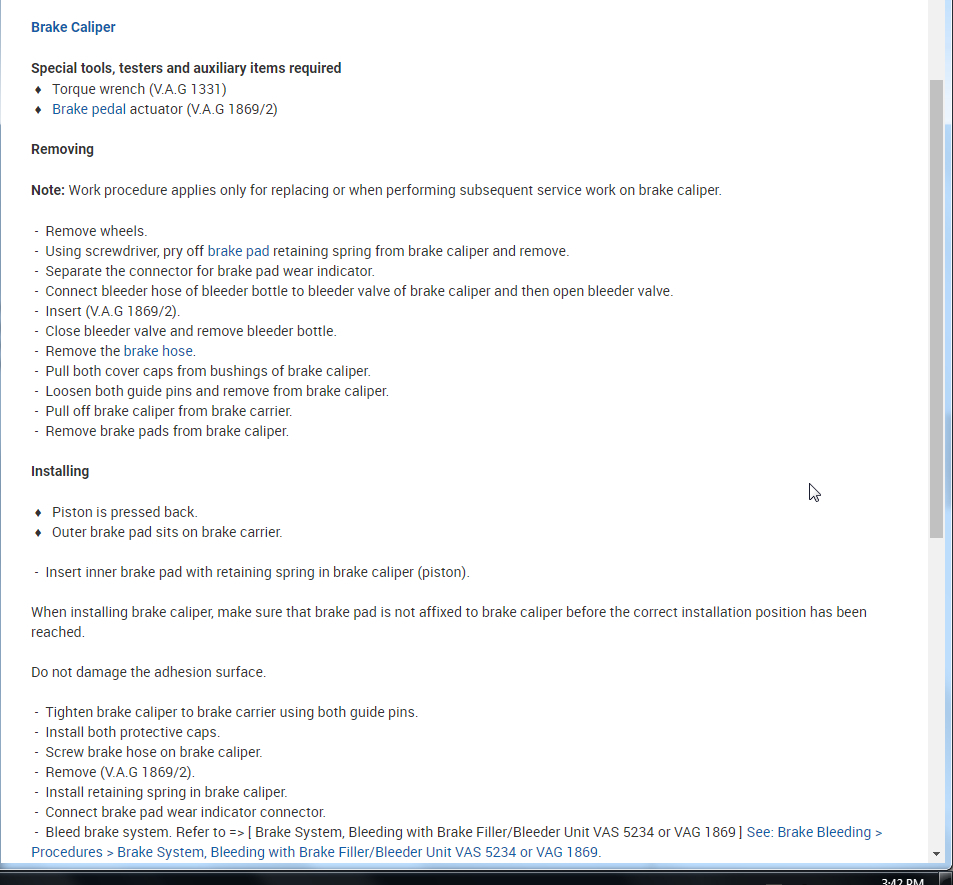

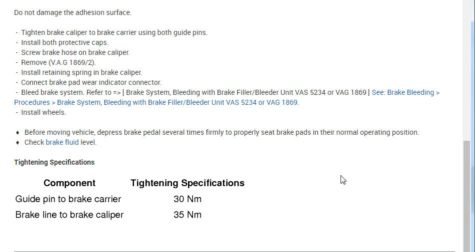

Unfortunately I think the calipers are seized. Here is a guide that will help with this:
https://www.2carpros.com/articles/brake-caliper-replacement
However, here is a guide that will help with retracting the pistons and hopefully that will work:
https://www.youtube.com/watch?v=j8YwfSKEzZo&t=29s
If this does not work then you will have to replace them and below is the process from the manual on how to replace it. Let us know if you have questions. Thanks
