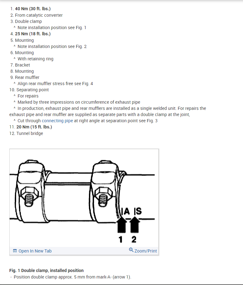

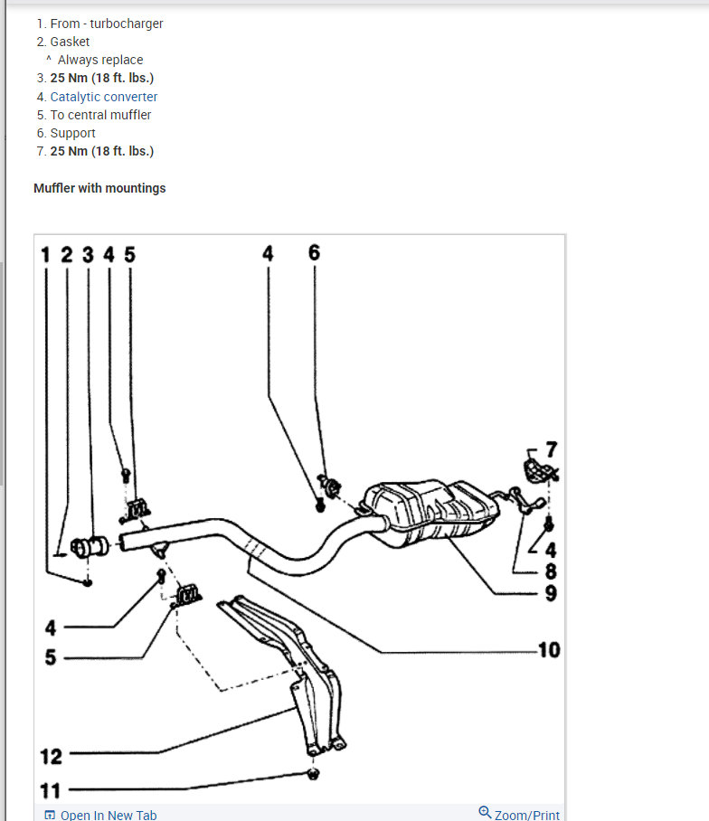

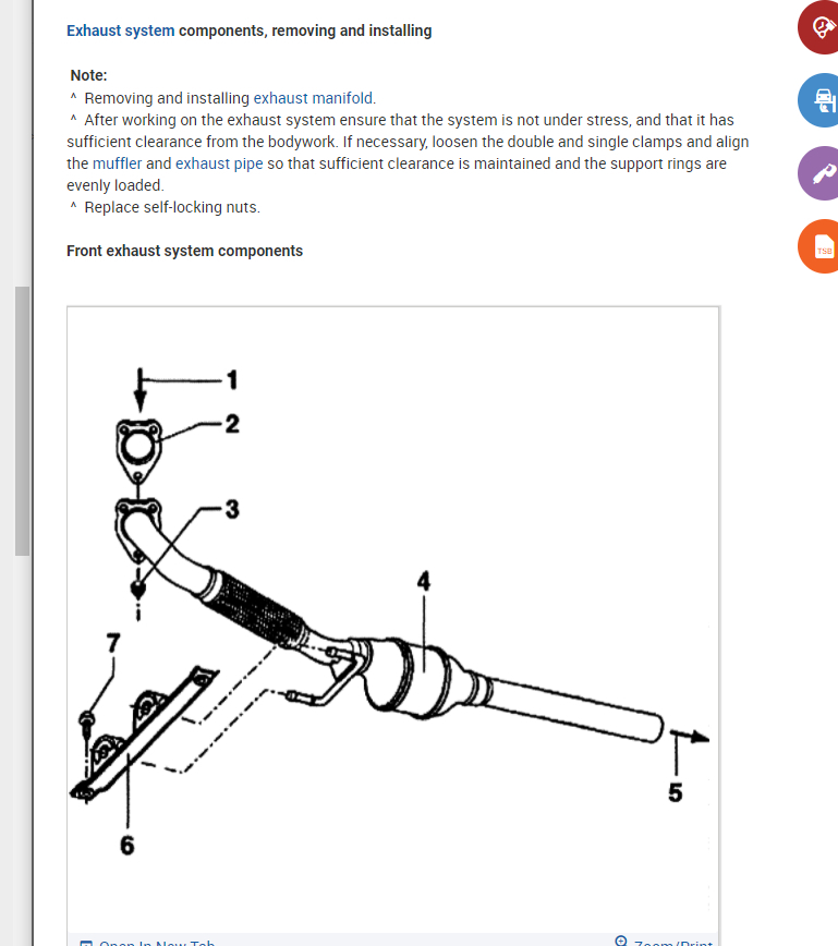

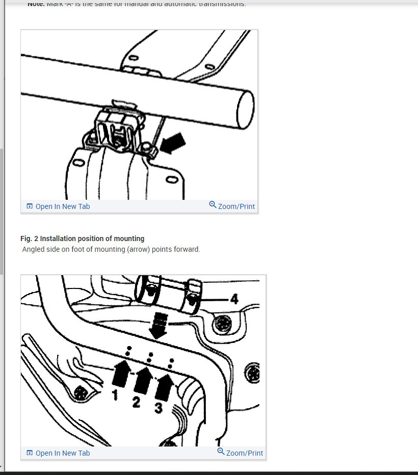

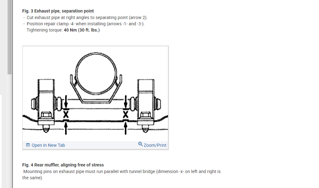

I attached the info below from the manual that will help with replacing this.
Please run through this info and let us know if you have other questions.
