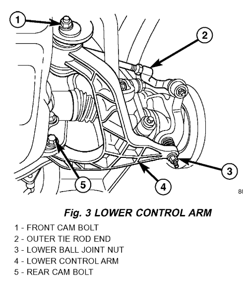

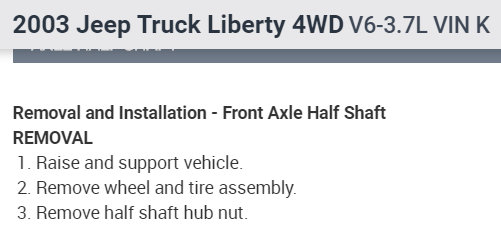

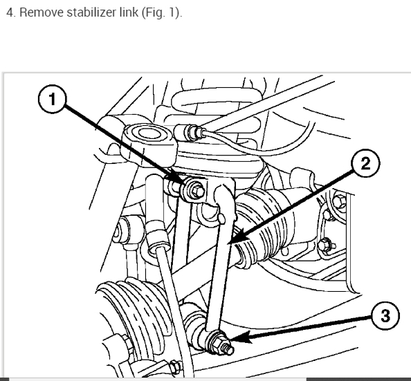

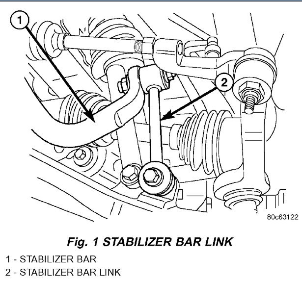

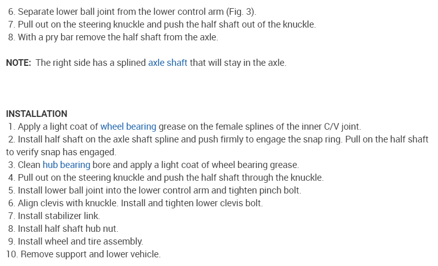

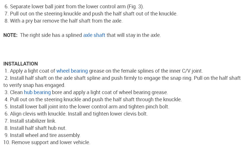

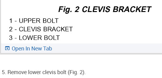

Usually common symptoms are by having a ripped,torn,or loose CV axle boot which will cause the CV joint to lose all the grease.After time the CV joint will start making a clicking sound when making turns.This clicking sound comes from the bearings no longer having grease as a lubricant. CV axles can also fail due to high mileage.Here is a tutorial showing what is involved for its replacement:
https://www.2carpros.com/articles/replace-cv-axle
I've also attached picture instructions below for your vehicle.Hope this helps and thanks for using 2CarPros.
